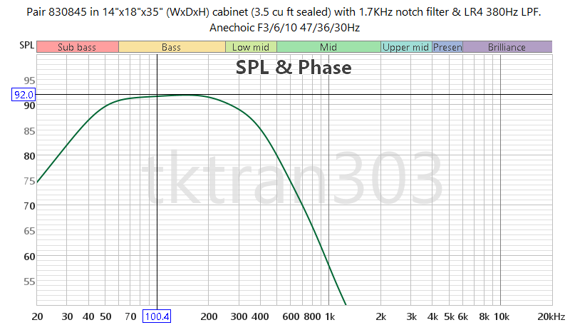

You are correct that a bigger driver will do a better job in the deep bass eg. <60Hz. Particularly if people are debating a 12” woofer vs an 8” woofer. An 18” vs 12” etc.
Between similar sizes it gets closer, and sometimes depends on the particular model. Even a Purifi (or Scan-Speak) 10” may perform better (or compete) with other 12” woofers

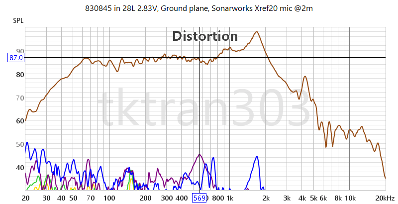

The “science based guys” like to understand why they’ve found that a pair of slightly smaller drivers may be sound cleaner or louder to a single slightly larger one.

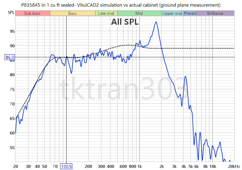

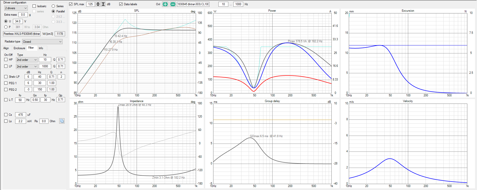

I’ve attempted to show this by computer based simulation that’s based on physics and math calculations, but unfortunately these multi-graphs can be too much to handle.
I am guilty of this as I didn’t provide commentary to the graphs.
But I can recommend a 3 way with a pair of 8” Dayton Audio RS225-8 per 80-100L cabinet. Especially with the deep bass tuning (that results in an F10 of 20Hz) that resulted in deep but tight tuneful bass that that stopped on a dime.
