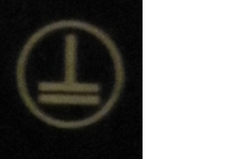

The amp is an Accuphase e202. Recap etc is already done,
Ive done some searching on the forum tonight and have a few questions,
the amp is double insulated, no safety earth connected, however it has been modified as the rectifier pcb was missing so a new bridge has had to be installed elsewhere in the amp, I would like for my own peace of mind to make this as safe as possible so to me that would be adding a safety earth, right or wrong?
Also being 'double insulated' the amps earthed through the transformer ct if im correct? If I add a 'safety earth' am I opening up the amp to faults from the primary side of the transformer being transferred to the secondary.
During the search I found a diagram that has the consensus of being a safe grounding scheme, would this have to be altered with a ct transformer. Obviously I would have to convert this to a one box diagram but is this genrally accepted to be the correct way of doing things?

Others may recognize that symbol. The international standard for many years has been just 2 squares, one inside the other.
This may not be known to you, but the possibility is, that this amp. came from the US or elsewhere and and was simply ungrounded,
as most US appliances had been forever. That is to suggest it was not double insulated, just ungrounded and fitted with a standard US plug.
Bring it to the UK, fit a 13 amp UK plug, change the voltage tapping on the transformer (or fit a new one - as you find) and there you are -
a bodgied 230V conversion! 😱
Of course, that's just surmise but the signs may be there.

I do not recognise the symbol in post35
Double insulated symbol is two concentric squares.
It usually has the words "double insulated".

Thanks Ian, I'll start an new thread about that symbol.
The amp seems like it was made for the international market with it having the voltage selector on the back, I'll report back when I find out about that symbol.
That looks a bit like the symbol given by Wikipedia for Class I, but elsewhere on the web it says that there is no internationally recognised symbol for Class I.reddish75 said:I'm assuming that it should be double insulated, is the symbol in the pic attached the correct one for that?
Could it be that Mr. Bodger who previously messed with this amplifier did a DIY 'conversion' to Class II by simply omitting the earth wire?
You need to be sure what the amplifier is intended to be, and then return it to that state. This means that an earth lead is either required or prohibited. Making such a change would probably be legal as it could count as a repair.
Yes.................................return it to that state. This means that an earth lead is either required or prohibited. Making such a change would probably be legal as it could count as a repair.
