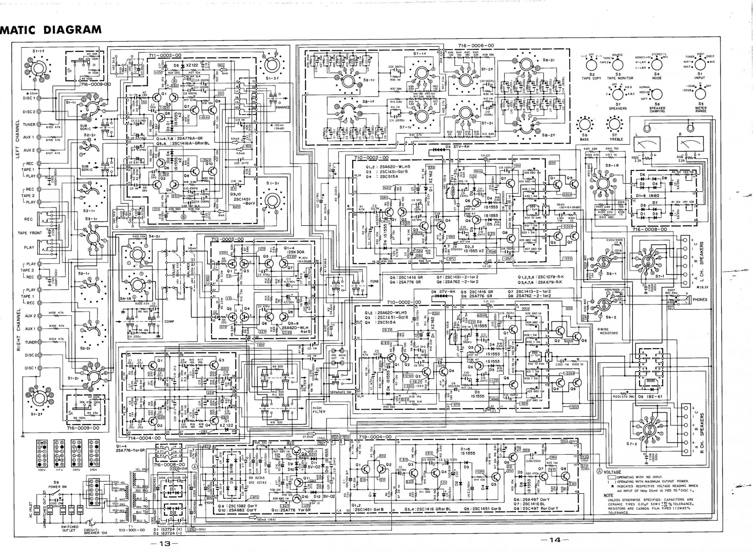

Apparently the symbol in post 35 means,
The T symbol means the unit was in compliance with Japanese regulations at the time.
It looks like I'm not going to find out whether this was an import or not, so what's the general consensus here? Leave as is? Or add a safety ground? How does this stack up legally?
Legally, I expect that you should leave as is.Apparently the symbol in post 35 means,
Dan.
As it's fitted with a voltage selector and complied with Japanese standards, I assume this is rated for safe operation at the highest supply voltage. If there is no UK electrical safety compliance sticker, it met only Japanese standards at the time of manufacture. I suggest that it was simply an unearthed 2-wire AC appliance, as depicted in the service manual. It may be frowned upon now but was normal practice in most countries at the time.
Yep, leave it as is - It's not double insulated but probably no less safe than originally approved for the Japanese market, provided the mains flex is properly secured and the leads unstressed and well insulated. Any chassis earth connection to the signal earth (RCA sockets) or turntable earth will determine the chassis potential, provided the wiring current capacity isn't exceeded in a fault condition. Don't be surprised that other examples, as in that video , have been heavily modified and the internal grounding - perhaps safety earthing too, altered.
