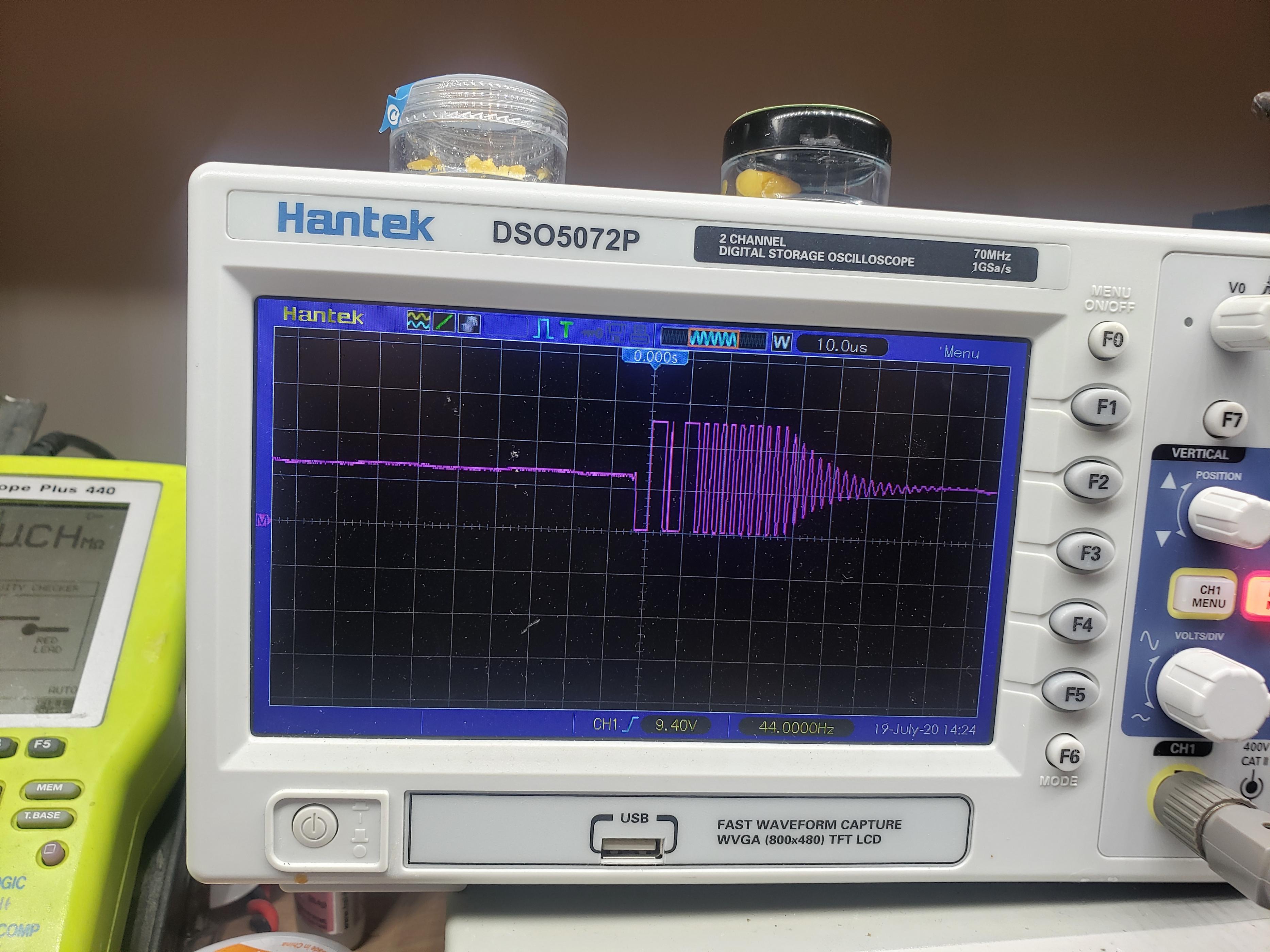

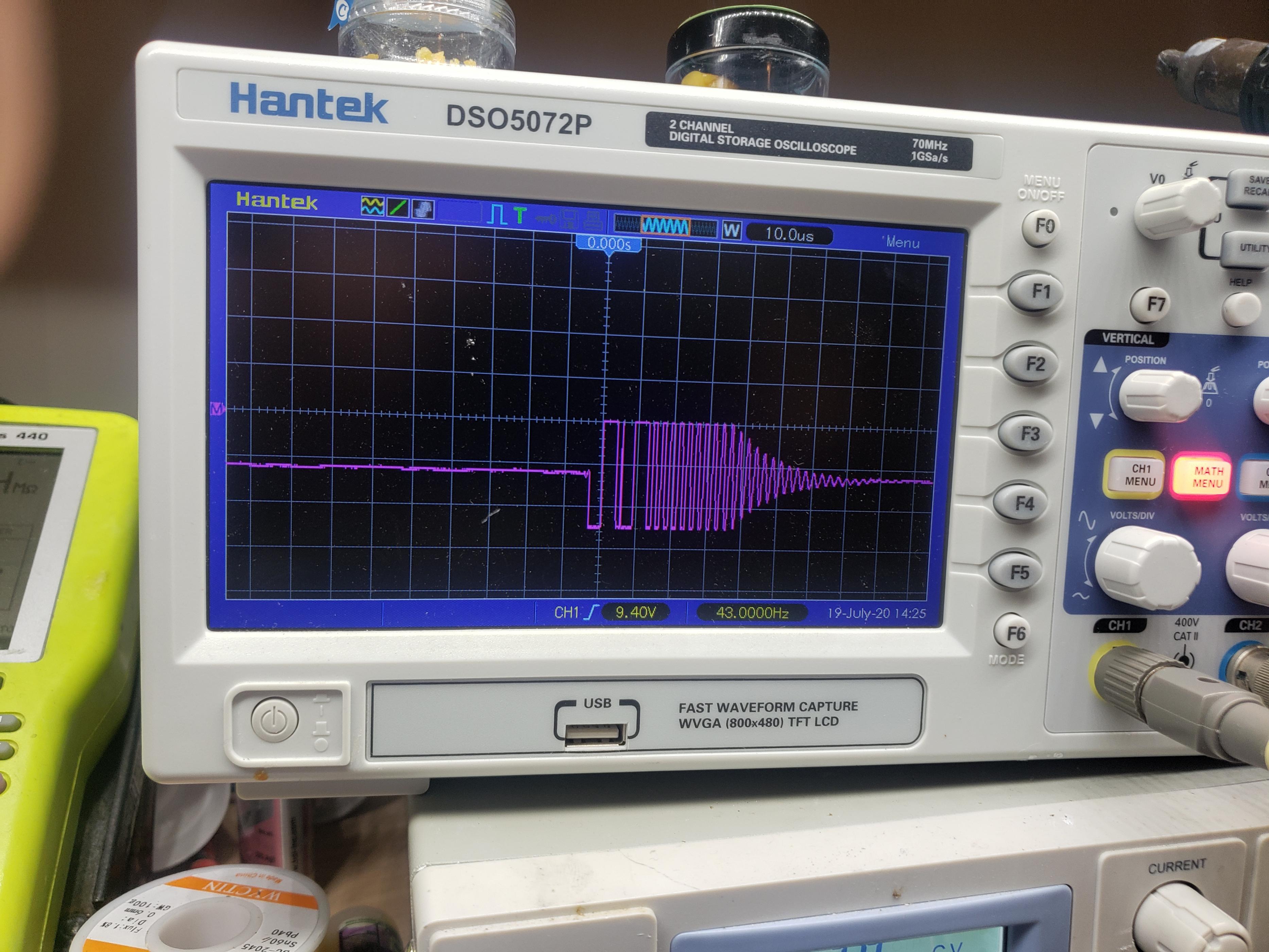

Now try it on the output FETs. Remember, you won't ground the scope to anything but the 12v PS (like it should normally be connected). For the probes, you will only touch the tips of the probes to the circuit.
Post photos of the drive waveforms.

Did you have the 'negative' scope probe on the source leg for both waveforms? It looks like one was reversed.

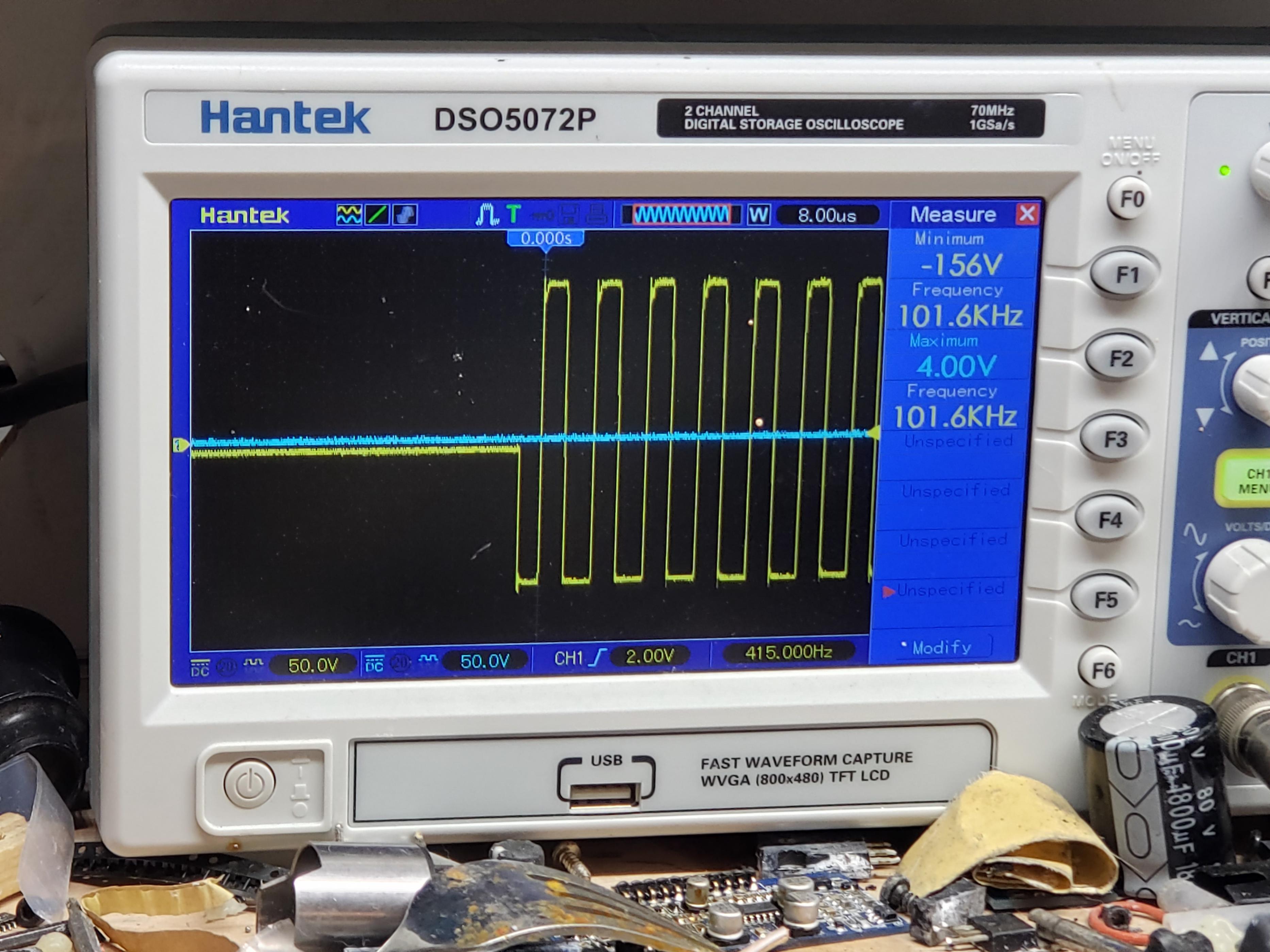

I'm back working on this amp again. When I install the output fets I lose drive and have -28vdc on the speaker terminals. Without the fets i have drive and no dc.
On post 99, you posted an image with the FETs in the circuit. What happened between then and now?
The fets on one side blew. I found out the inductor on that side was shorted. With the inductor out the amp works fine. When I dropped in a replacement inductor it went back to not switching again. It looks like its trying to start switching when I apply signal but cant

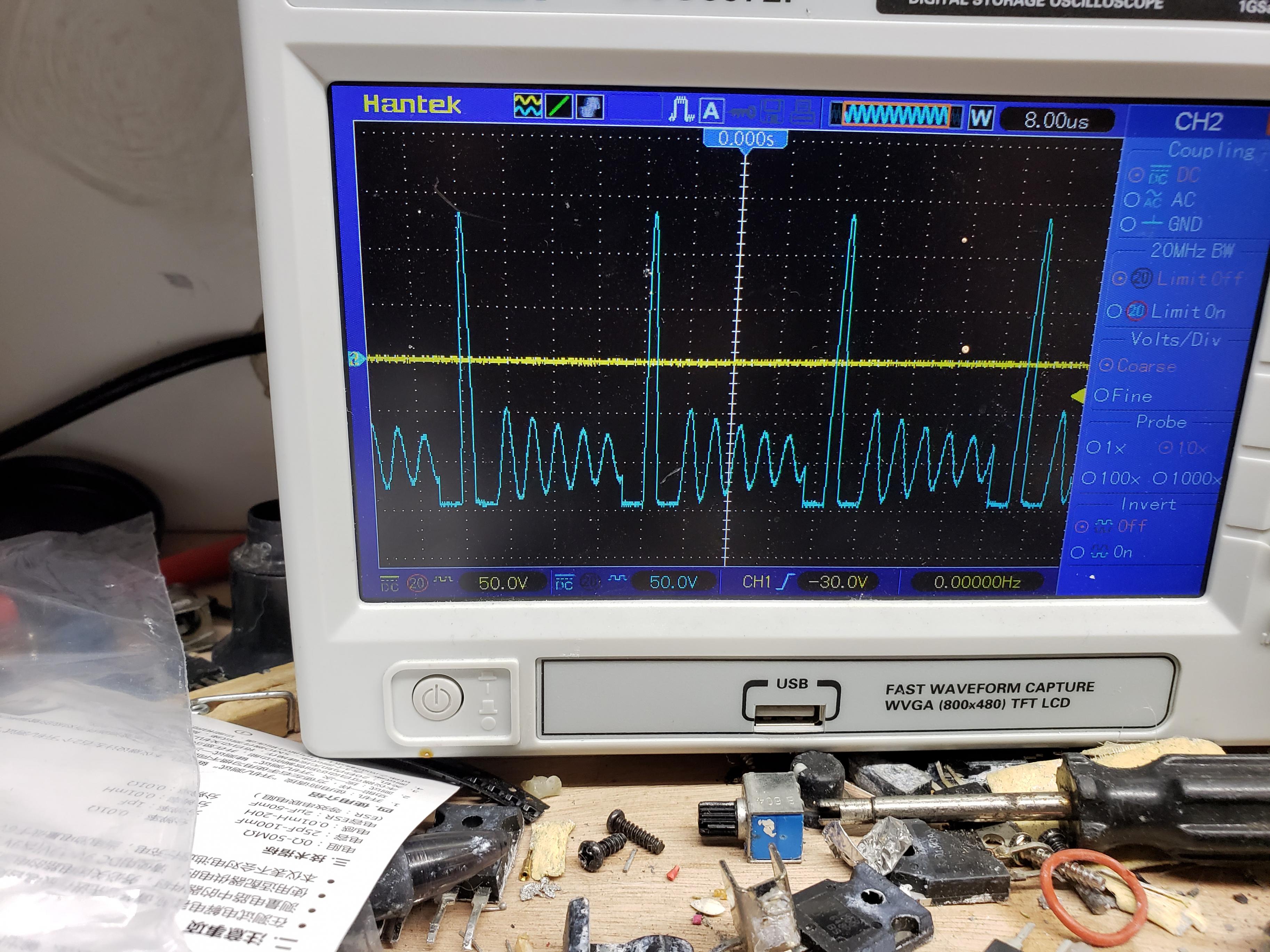

I just noticed with either one of the inductors in the wave on the center leg of the fets is normal for 1 second then starts to looks like this.
That looks like the low side.

But it's not the center leg. It's the source leg, correct?
Without the inductors, do you still get rail-rail oscillation as you did post #110?
