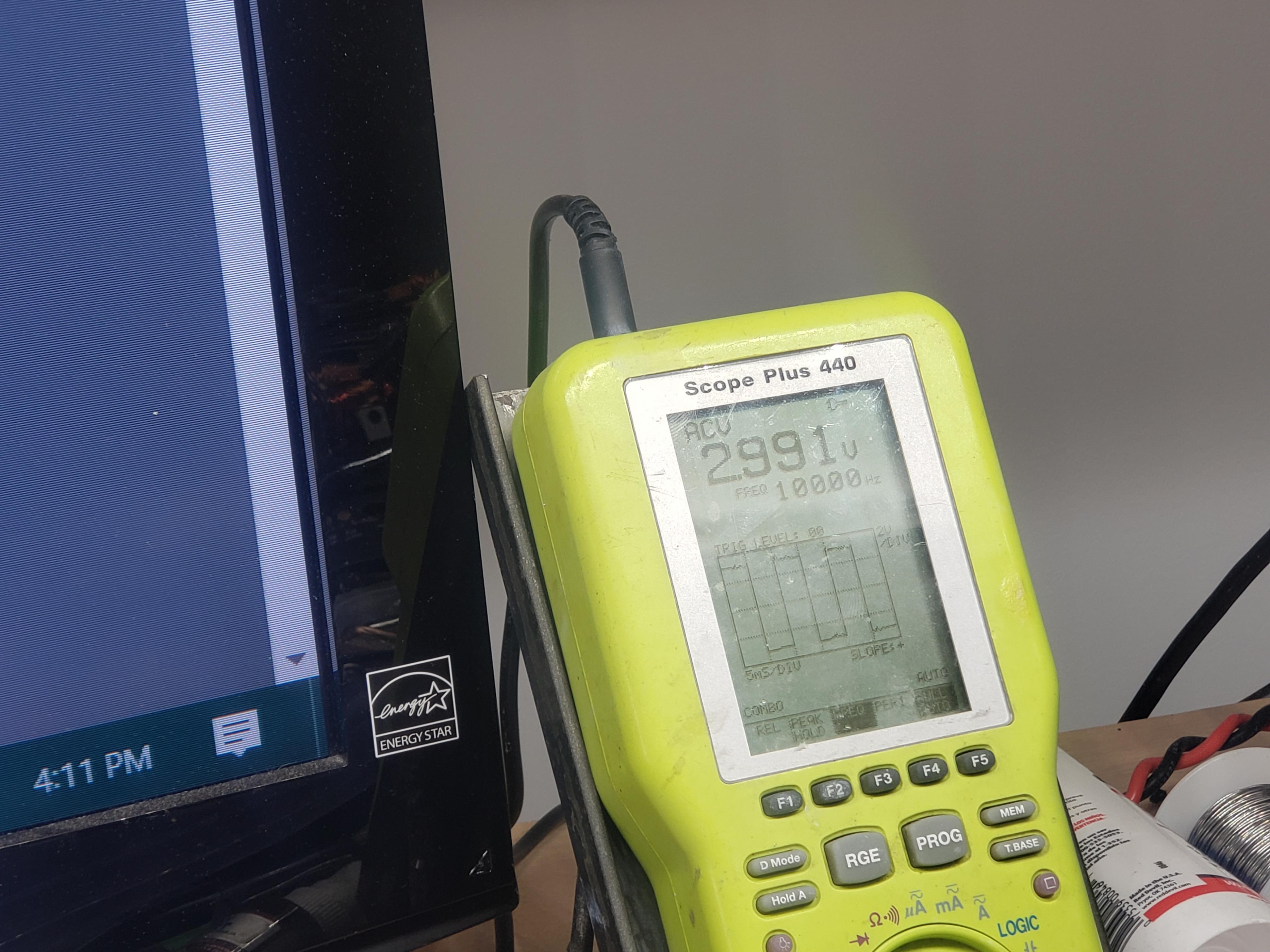

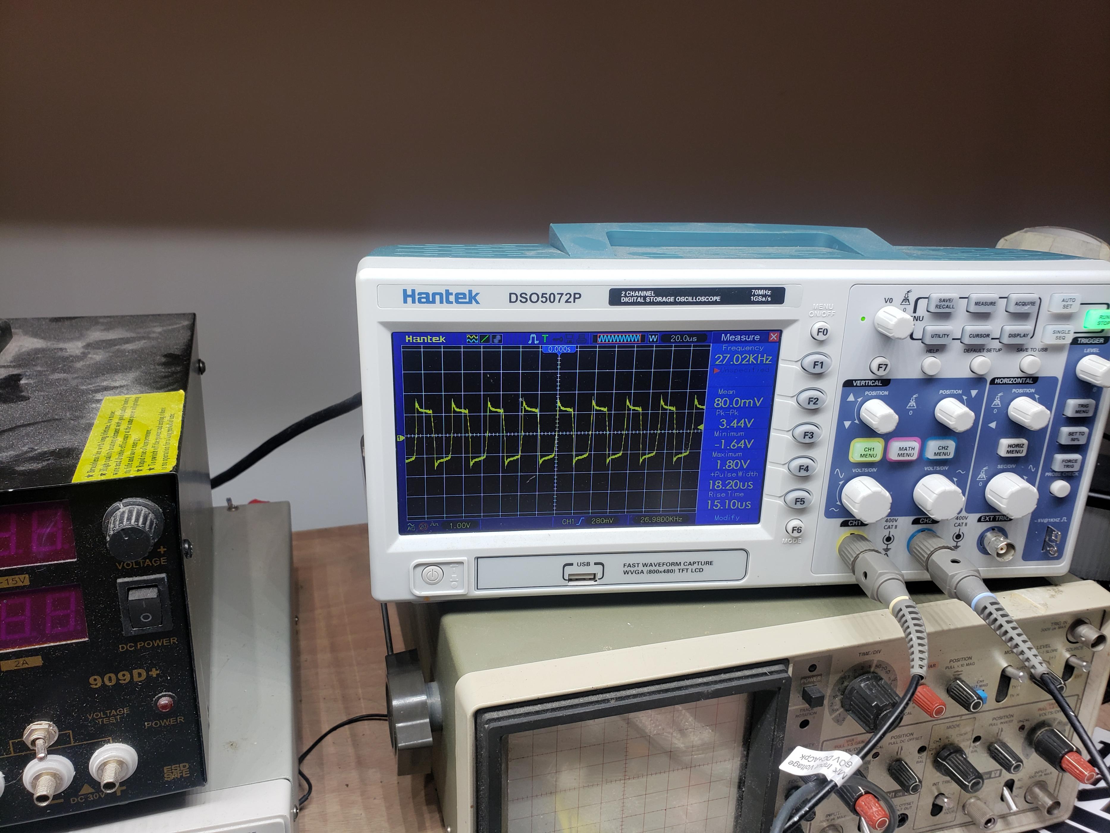

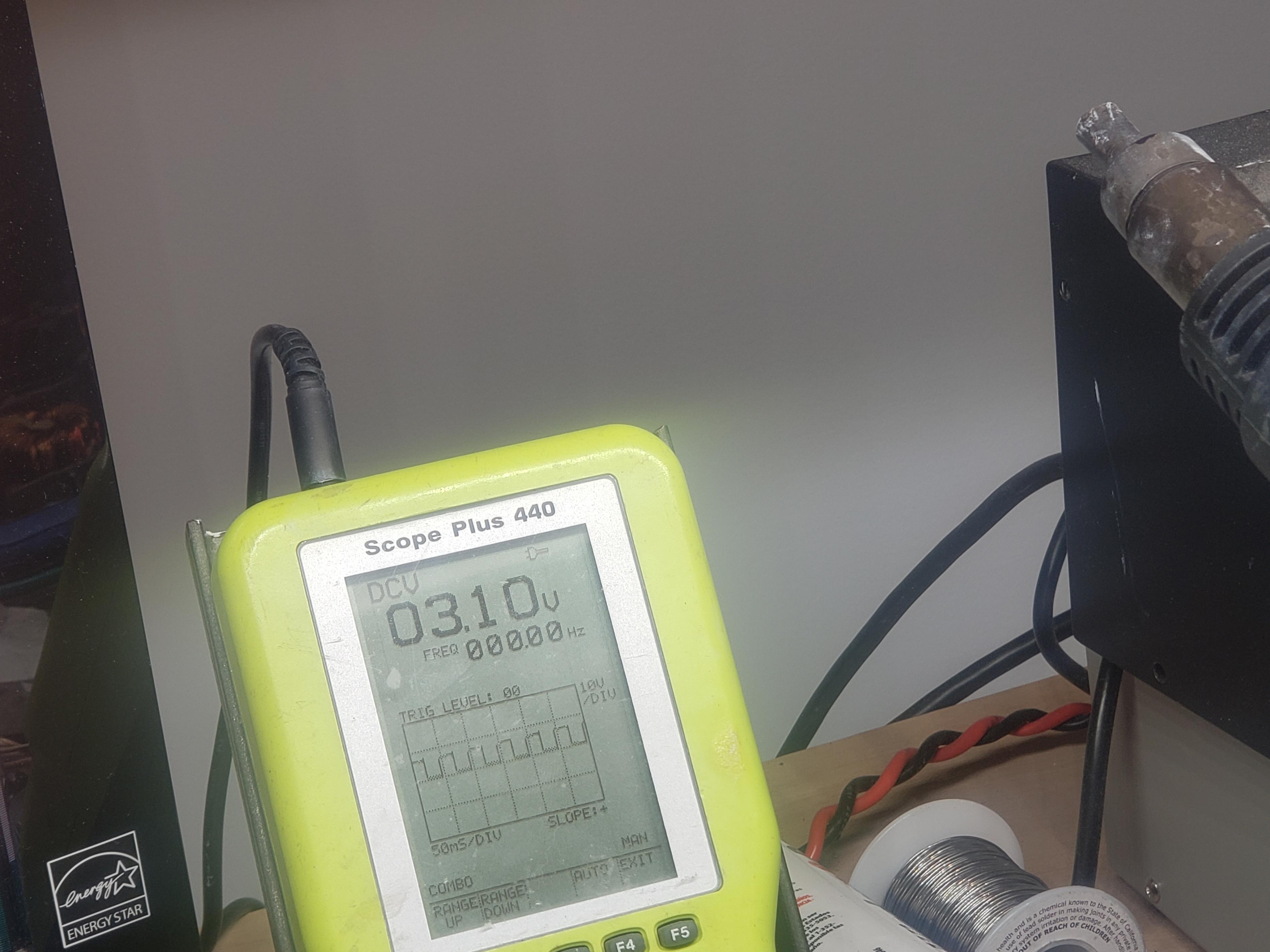

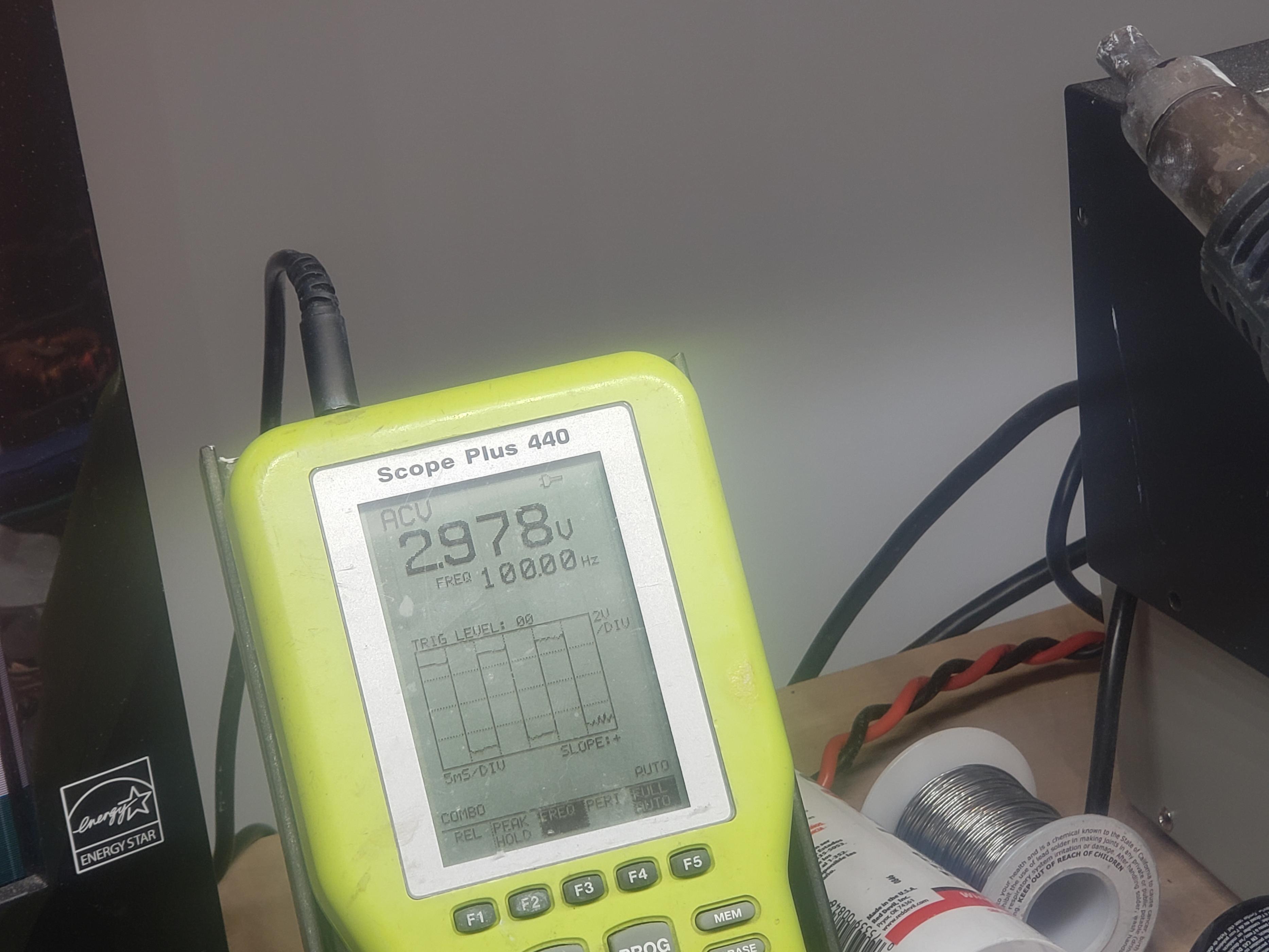

mnhiphop101 Member Joined 2011 2020-07-15 10:09 pm #61 2020-07-15 10:09 pm #61 Is it normal for these to heat up to 160°f idling Attachments 20200715_160537.jpg 999 KB · Views: 66 ••• More options Share mnhiphop101 Member Joined 2011 2020-07-15 10:14 pm #62 2020-07-15 10:14 pm #62 Here's a pic with my handheld scope Attachments 20200715_161151.jpg 826.1 KB · Views: 74 ••• More options Share P Perry Babin Member Joined 2003 bcae1.com 2020-07-15 10:40 pm #63 2020-07-15 10:40 pm #63 Was the black probe on the negative rail? Where is the ground reference for the displayed waveform? ••• More options Share mnhiphop101 Member Joined 2011 2020-07-15 11:12 pm #64 2020-07-15 11:12 pm #64 2ndary ground ••• More options Share P Perry Babin Member Joined 2003 bcae1.com 2020-07-15 11:27 pm #65 2020-07-15 11:27 pm #65 Set to DC coupling and place the black probe on the negative rail. Everything on this IC is referenced to the negative rail except the high-side circuit (3 terminals). ••• More options Share mnhiphop101 Member Joined 2011 2020-07-15 11:33 pm #66 2020-07-15 11:33 pm #66 3vdc squarewave ••• More options Share P Perry Babin Member Joined 2003 bcae1.com 2020-07-16 6:08 am #67 2020-07-16 6:08 am #67 Photo of the waveform? Why was the waveform so much different on your other scope? ••• More options Share mnhiphop101 Member Joined 2011 2020-07-17 7:59 am #68 2020-07-17 7:59 am #68 Idk. I was hoping u could tell me that. Attachments 20200717_015758.jpg 556.3 KB · Views: 66 20200717_020216.jpg 617.5 KB · Views: 65 Last edited: 2020-07-17 8:03 am ••• More options Share P Perry Babin Member Joined 2003 bcae1.com 2020-07-17 8:07 am #69 2020-07-17 8:07 am #69 I think that drive signal is OK. It has an amplitude of about 7v. Does your other scope show a square wave (perfectly square) when looking at the signal out of the PS driver IC? ••• More options Share mnhiphop101 Member Joined 2011 2020-07-17 8:22 am #70 2020-07-17 8:22 am #70 Not really Attachments 15949704744568148873447172968584.jpg 872.7 KB · Views: 64 ••• More options Share P Perry Babin Member Joined 2003 bcae1.com 2020-07-17 8:44 am #71 2020-07-17 8:44 am #71 That looks like the probe needs calibration. ••• More options Share mnhiphop101 Member Joined 2011 2020-07-17 8:50 am #72 2020-07-17 8:50 am #72 I'm gonna go off of what the hand held scope displayed. So why, when I put the fets in is there no switching? ••• More options Share P Perry Babin Member Joined 2003 bcae1.com 2020-07-17 9:02 am #73 2020-07-17 9:02 am #73 Did you try adjusting the probe? Install the FETs and when there is no drive what is the DC voltage on the output of the LM211? ••• More options Share mnhiphop101 Member Joined 2011 2020-07-17 4:58 pm #74 2020-07-17 4:58 pm #74 When I touch it to the test wave it looks perfect ••• More options Share mnhiphop101 Member Joined 2011 2020-07-17 5:01 pm #75 2020-07-17 5:01 pm #75 Am I supposed to leave the 10k resistor in for this? ••• More options Share P Perry Babin Member Joined 2003 bcae1.com 2020-07-17 5:07 pm #76 2020-07-17 5:07 pm #76 The 10k is only necessary when there is no feedback, like when the outputs are out of the circuit. Do you have another probe? ••• More options Share mnhiphop101 Member Joined 2011 2020-07-17 5:08 pm #77 2020-07-17 5:08 pm #77 Ok ••• More options Share mnhiphop101 Member Joined 2011 2020-07-17 5:11 pm #78 2020-07-17 5:11 pm #78 Is this referenced to negative rail? ••• More options Share mnhiphop101 Member Joined 2011 2020-07-17 5:12 pm #79 2020-07-17 5:12 pm #79 Yes the wave looks the same with both probes ••• More options Share P Perry Babin Member Joined 2003 bcae1.com 2020-07-17 5:14 pm #80 2020-07-17 5:14 pm #80 Try adjusting it on the drive signal of the PS driver IC to see if it looks better on the waveforms in the output section. ••• More options Share Prev 1 2 3 4 5 6 7 Next First Prev 4 of 7 Go to page Go Next Last Show hidden low quality content Status This old topic is closed. If you want to reopen this topic, contact a moderator using the "Report Post" button. Share: Facebook Twitter Reddit Pinterest Tumblr WhatsApp Email Share Link Home General Interest Car Audio Twisted Sounds 8.5k Top Bottom
