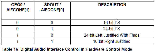

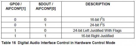

i would use the WM8804 to convert the S/PDIF to I2S (16bit). The I2S should feed my TDA1541A NOS DAC.
Unfortunately i have no sound output 🙁 , independent if i set the I2S to 16 or 24 bit (AIFCONF0 1 or 0).

Is there any output on the pins of the WM8804? Check for a LRCLK (pin15) at least.
Also, note that the datasheet has an example for 16-bit right-justified audio, not I2S. This bit me once trying to use a WM8805...

hi
I am using WM8805, WM8742, but I think this should be good to 8804
WM8804--TDA1541
16bit I2S hardware
1--H
2--L
3--L
4--L
5--Unlock(3v3-10k-led)
WM8804--TDA1541
16bit I2S hardware
1--H
2--L
3--L
4--L
