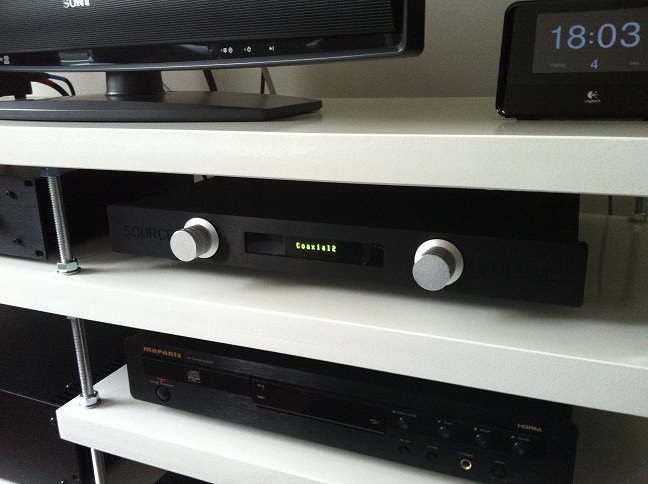

After 3 years I have finally finished my buffalo32s. Last week the custom frontpanel from Modushop.biz/Hifi2000 in Italy arrived. Beautiful work by Andrea Bettazonni. Now it not only sounds great, but looks great as well (in my opinion at least)!

It certainly looks great.
May I ask how you mounted the display to the front-panel?
I plan to do something similar, but actually i have no clue on how big the rectangular hole must be, to look "professonal". I guess it must be slightly smaller than the display itself...
Also: Should one use a cover glass before the display (for protection)?
I can manage some wood- and also metal-work, but this task does puzzle me.

Bellissimo! Did you use an arduino for the display?
Thank you. I did not use an arduino for the display. It is a custom solution designed and made by my brother to control the i2c bus. The plan is to add volume control by the remote as well. Now only the source selection can be done by the remote.

The panel itself is 10mm thick. On the rear a 8mm deep cavity is made, which is slightly bigger then the cut out on the front, to hold the display window. I have used 3mm thick grey plexiglass for the window and made a "mask" of black cardboard so then nothing else then the display is visable through the display window. Around the cavity on the back there are 4 m3 threaded holes to bolt the display pcb to the frontpanel. Easyist solution I could think of.
