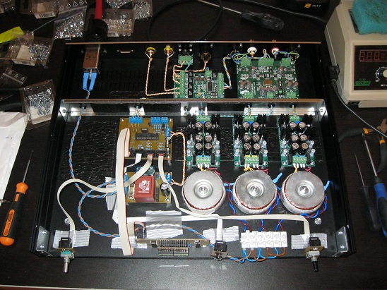

Hi Russ or Brian - - I have a Buffalo 32S I am about to build, ( I just bought the wire and solder --- thanks for Russ's help on wire size ) - - - Next Question before I begin ... I have 1-each 32S Dac, 1-each LCDPS, 2-each LCBPS, 2-each 15VA-15v Transformers, 1-each 15VA-9v Transformer - all bought from Twisted Pair Audio, - I am just begining this project and as a newbie would like to make sure all three supplys can be used on the One 32S Board.... is this correct? - Thank You for any help, Sincerely, dean
Correct; I am using apprx the same configuration.

Hi Scanspeakman, Thank You for the reply !!!
- What are the other boards that are in your chassis???
I am looking also for some kind of Pre -regulation after the Transformers , before the PSU boards - like CRC or something ... would that help clean up the power a little more? Anyone have some advice? Thank You , Kind Regards, dean
Thanks Brian !!! - I guess that I have seen other people that have done more power supply work and say that your Great Buffalo Dac really responds to improved PSUs !..... and I wanted to do something more! But I don't have the bucks right now to buy a better PSU like shunts from you ........ but I could afford a few caps and other parts to mod the psu , So I was looking for any Ideas that others had tried , that had helped ... diy..... it's a disease : ) Kind Regards, dean
