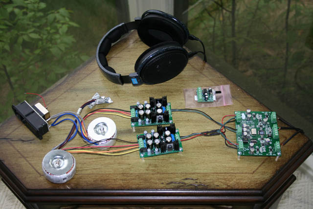

I just got mine today, however work and school will impede on its completion date. Thanks! Very well packed! Brian and Russ did a great job getting these out balancing whats going on with Brian's move etc...

Ha, I figured I'd get dinged on the (lack of) casework. As soon as I fix a few resistors I put in backwards, I'll put this thing in a nice, shiny box.
I'm driving a pair of ~1996 Sennheiser HD-600's in a balanced configuration straight off the Buffalo board, and I haven't put the Volumite to work yet. I haven't tried the DAC on any speakers.
It was immediately apparent to me that the Buffalo beats any source I've listened to by a country mile. As such, I can't add any constructive comparative assessments, sound-wise.
The Buffalo board is under 1.125" and the LCxPS' are a touch under 1.625," both including the supplied standoffs.

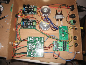

Here is a Bufflo32S in a Cardboard Box. The Box is used to test the layout before a buy a case.

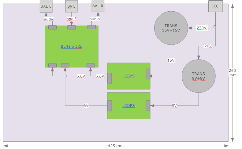

I was thinking layout like this with Pesante 2U chasis. Do you see something wrong with the wirings (length etc) or layout? I am pretty noob on electronics, but this is how i have understood how it goes, before i read the manual. The voltages are probably better specified in the manual, but this is what i have catched so far.

3lviz said:I was thinking layout like this with Pesante 2U chasis. Do you see something wrong with the wirings (length etc) or layout? I am pretty noob on electronics, but this is how i have understood how it goes, before i read the manual. The voltages are probably better specified in the manual, but this is what i have catched so far.
VD is 5V
VA is +/-15V There is no 6.6V on the analog side.
Cheers!
Russ

Thanks for the correction. I don't know where i picked that 6.6V from.

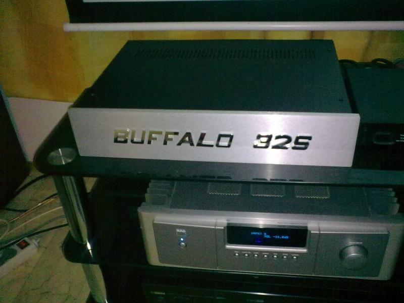

mjwolf said:Here is my Buffalo. I need to buy a true case. I am driving a B22. So far the sound stage sounds much wider than any I have hear before.
This is what I have for a case. No, I did not find smaller letters, but weirdly i like the looks 😀. The letters seem black in the pic, but they are silver in real life.
I probably get the electronics next week (got a notice from USPS yesterday), but I gotta do the back plate drilling before that, which will be new experience for me as well.

Some respected professionals - like dennis morecroft of DNM think that a wooden or plastic enclosure has inherent advantages over a metal casing especially a magnetic metal casing. I would be interested to hear if your DAC sounds different if you mount it in a metal box
cheers
mike
