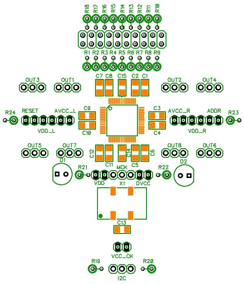

I have actually been working on the "Tweakers" board this weekend. But with Brian moving and all it probably still a couple months out.
I think I may in the end do two of these type boards.
One will be very stripped down. No regulators or anything. Just bypass caps and the chip and headers and a spot for the clock (but that will also have a header).
This will give the hobbiest complete freedom.
Here is a rough sketch of the stripped version:
The other version would be the same as the Buffalo32S but with no comparator and all of the inputs exposed as headers and no output stage and the outputs exposed as headers.
Cheers!
Russ

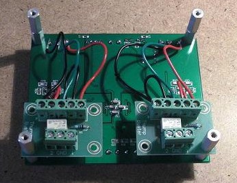

Yes, I received the package yesterday. It contained the Buffalo32S board, standoffs, and the Thumpbuster kits.

We have two options for Buffalo32s single-ended output if turn-off thump is an issue in your setup:
First, a simple relay board called the ThumpBuster. This is a small relay board powered by the analog rails, much like the relay on the IVY, it simply shunts the output to ground at power off preventing any thumps. These will come free with the Buffalo32s. With it, you can simple use +OUT and GND and get performance nearly as good as the balanced outputs.
Second, we have a new, smaller, simpler kit version of the Ballsie called the Ballsie Lite coming out in a couple weeks (boards will be here next week, but I need to kit up the parts). It has a single LME49720 and optional simple filtering. The best way to use it would be to install it at the destination rather than the source, so you get the benefit of balanced transmission lines, but it would work in either location. I am going to try very hard to have them ready to ship before the Buff32s modules ship, but I am also in the process of packing up our house to move, so I cannot promise that will be the case.

If you don't need to use the Thumpbuster can you still hook up SE using + & GND off the terminals on the Buffalo32?
HaLo6 said:If you don't need to use the Thumpbuster can you still hook up SE using + & GND off the terminals on the Buffalo32?
Sure, you don't "have to" use thumpbuster at all. The ESS demo board for example does not use output shunting relays.
It depends on your application. If your going directly out to a power amp I would definitely use it. Out to a preamp, you may not need it at all.
I would actually use it no matter what just to be safe, as it does no harm at all even if you don't need it. 🙂
FWIW the ESS demo board has much worse SE turn off thump (even after BAL/SE conversion) than the BUF32S.
The next board revision will have these relays built in. They just were not on the first run of boards because we were not sure if they would be useful.
