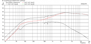

When I modeled the dual A7.3 in a sealed cabinet wired in series with a 70uF cap across the lower driver, I get a response that falls off starting at 2 kHz. How did you get 300 Hz?
I used standrd XO calculations to get in the ballpark.
Something is screwy with your sim. Would take about 10 uF to roll off at 2k.
dave
dave
Scottmoose will know but I suspect it is because the cap is in parallel to the driver rather than something wrong with the sim. It is a pretty straightforward addition of a cap across the driver nodes - one line of code. The RC time constant for 5 ohms x 70 uF is = 0.7*5*70E-6 = 0.245 ms or about 4kHz.
Given the wiring of the drivers, FR should be the same as a single driver (voltage amp assummed) If not something is wrong with the sim.
dave
