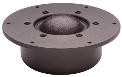

I was thinking about this. Does anybody know how loud will a tweeter with x-max of 0.4mm go at 700 Hz, compared to another one at 2.1kHz with a x-max of 0.2mm, relatively speaking.
What is the relationship of amplitude versus frequency given the same amount of power?😕

Oon, please try this. The calculations are for pure diaphragm movement, and do not include boost due to waveguide or horn.
Note that you will need to convert Sd (given in most data sheets) into diameter and then into inches.

Thanks for the piston excursion calculator. Was very helpful. Looks like the most I could go at 750Hz and 0.4mm excursion is 90db at 1m. If I want to hit 100dB, would need 4...

I concur with Sreten's comments. No circa 1" or 1-1/8" dome tweeter has enough volume displacement (Sd*Xmax) to cross over below 1kHz. As he mentions, even with a crossover point of 1.5kHz some will sound strained.
The solution (that I use at least) is to look for a small "fullrange" driver and use that as a tweeter. There are a select few with a diameter around 2 inches or so that can be crossed over at 750Hz but still have enough high frequency extension to work as a "tweeter". I have used the Tang Band W2-800SL like this in an MTM (using it now in fact) and it's great. The biggest challenge is finding one with both high end extension and high enough sensitivity. Keep in mind that you will need to construct a separate back chamber for this kind of driver.
Totally agree with this post and the quotes too.
I use the W2/800SL and it works just fine in a tiny (50cc) enclosure, with a -3dB roll off at ~500Hz, without filter. Should be very easy to add a second order filter to bring it to a fourth order curve.

The LD25X from CSS if you can find them have the
highest linear excursion of any 1" tweeter, 1.85mm.

AFAIK, QC on the LD25X was not good, sample-to-sample variation could be substantial, and more than a few of these drivers had poor performance.
If Oon has a comprehensive measurement setup and is willing to take chances, maybe the LD25X could be a candidate.

Interesting... However, I don't have the tools and the Fs is quite high... Anyway, even if it exceeds xmax it is not a hard clip... Might be quite tolerable.

There are a few reasons I want to do the tweeter approach.
1) The mass of the dome is so light that the energy dissipates almost immediately. Look at the waterfall plot from my earlier posts. Therefore it has a very different sonic signature.
2) My tryout of the Tangband ceramic dome was awesome when crossed at 700Hz. There was so much texture in the sound. Probably because of the lightness of the cone, it moves to the electrical signal more closely.
3) The dome of a dome tweeter is connected to the voicecoil and voice coil connected to the surrounds suspension. Therefore the dome is sort of decoupled from the surrounds and should not experience the flextural stress that normal speakers do. The dome should move in a more pistonlike behaviour compared to the normal speaker cone.
