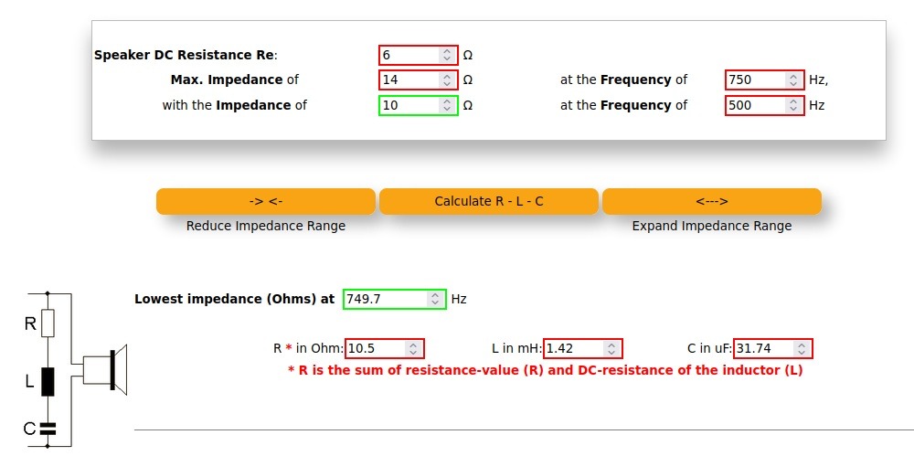

This might interest the 1st order fanatics. How to equalise the tweeter Fs impedance bump on the CAT378 or similar. What is called an LCR conjugate.
https://www.diyaudio.com/community/threads/seas-a26-devore-style-build.369124/page-2#post-6573112
I used this online calculator with values lifted from the CAT378 FR and impedance curves.
http://www.mh-audio.nl/Calculators/ICTAPX.html

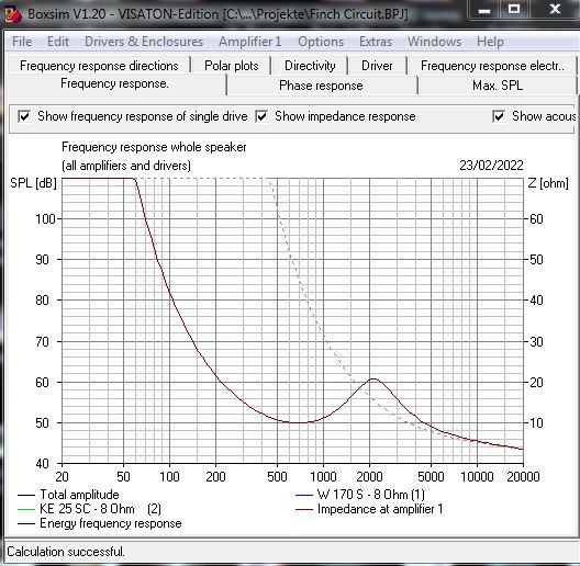

Very impressively accurate. Almost exactly what Mike Chua got in the Finch. I enclose the source impedance seen by the tweeter with (solid) and without the conjugate (dotted) acting around 750Hz.
This stops the tweeter excursion getting out of hand by increasing electrical damping.

Close, but no cigar. The tweeter is unaffected. All you are doing is changing the impedance vs frequency seen by the "crossover" (a single capacitor) that operates into the tweeter+conjugate_LCR network. This DOES have the intended effect of reducing/eliminating the attenuation rebound that happens around the tweeter's impedance peak at resonance, but there is no effect on "damping" of the tweeter's response.This stops the tweeter excursion getting out of hand by increasing electrical damping.
The tweeter is not unaffected, it ’sees’ the impedance of the conjugate network, which is not infinite at all. So electrical damping will be present.
I'm not sure I understand your logic. The way the circuit is drawn above the LCR is in parallel with the tweeter to give the overall network. The input to this network will be connected to an amplifier and assuming a solid state amplifier it will have a zero output impedance. So as seen by the tweeter there is a zero impedance source in parallel with the impedance of the LCR network, which would change nothing as far as the tweeter is concerned IIUC. FWIW, this would not be the case with other types of circuits in which there are elements in series with the tweeter.The tweeter is not unaffected, it ’sees’ the impedance of the conjugate network, which is not infinite at all. So electrical damping will be present.
Are we clear whether the response changes in this case as that would make a difference. Normally I'd assume it hasn't for the true purpose of this conversation but currently it's ambiguous.

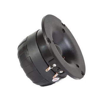

Why? Is it for the sake of simple trial and error and because you dont have the necessary measurement gear?Any tweeters out there that are will handle a 1st order acoustic crossover@2500Hz (or so) for reasonable levels (100 db)?
Not counting super expensive Bliesma T34 😱
Maybe Wavecor TW030WA11/12?
Or SB29RDNC?

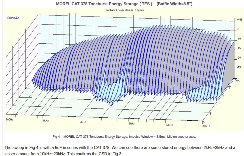

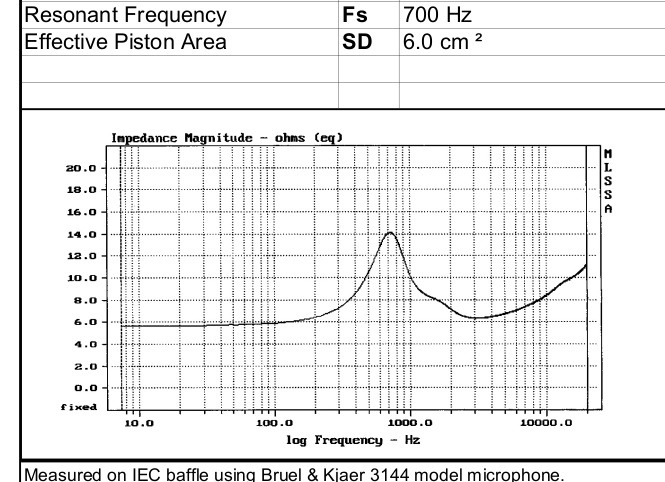

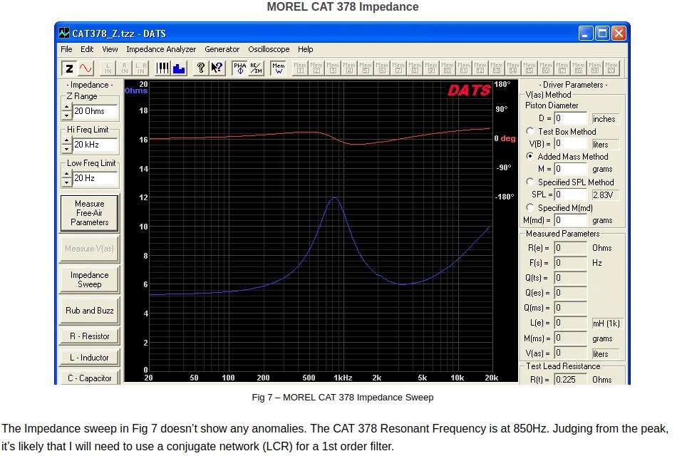

Let's start with the infamous ferrofluid Morel CAT378. What do we know?
Looks alright to me. Much as I hate soft-domes. As an Engineer, I must do my best with it.
As wolf_teeth says, it has significant production variations. 😕
Morel say the Fs resonance is at 700Hz. Mike Chua measured it and got 850Hz. Q varies. Rdc seems constant at 5.2R.
My money is always on the Waterfall. Which is about worrisome Stored Energy. Bit of a mess with a simple capacitor. But I know how to fix that. An LCR conjugate.

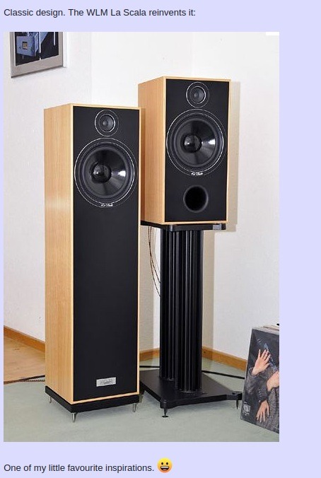

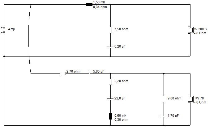

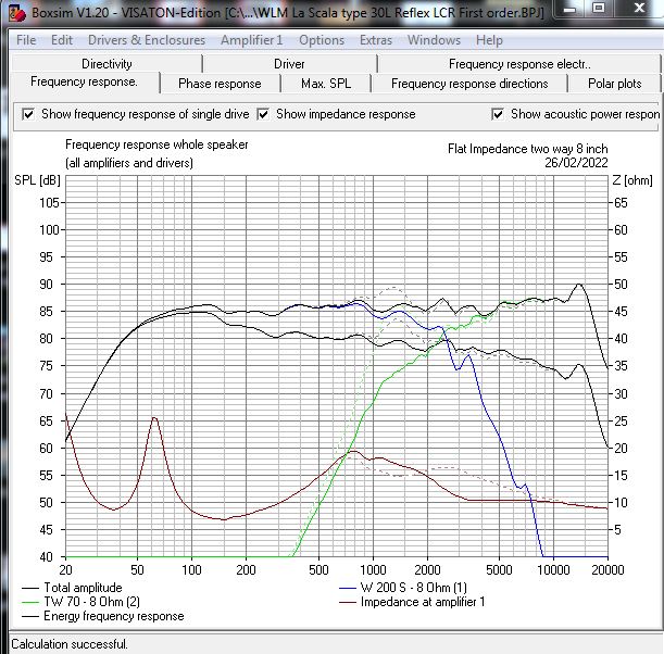

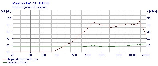

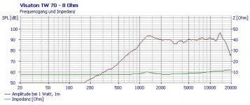

@ wiseoldtech. Here is how I would do the Visaton TW70 cone tweeter these days. Not exactly a conjugate, more an LCR notch. But all falls into place with a single capacitor, which I suppose is 6dB electrical.
I think I have all the bits lying around, so watch this space! I usually do 4th order with this little horror. It is rubbish on a single capacitor without it. The dotted trace.
https://6moons.com/audioreviews/wlm5/lascala_2.html
