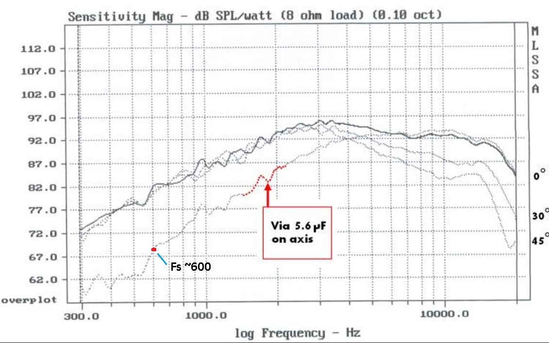

Not possible, if you mean 1st order acoustical high-pass filter all way down to low frequencies.Any tweeters out there that are will handle a 1st order acoustic crossover@2500Hz (or so) for reasonable levels (100 db)?
It is possible to manage the filter slope to be first order acoustically from 2500Hz down to the tweeter resonant frequency, but below that, slope downward will be about 18dB/octave.

-6db at 2k, then -15db near 1k, not -12.
True 6db would be 6db per octave, but i sort of agree with bob brines. I think he said it would be ok 6 down then 12 down, then you can roll faster.

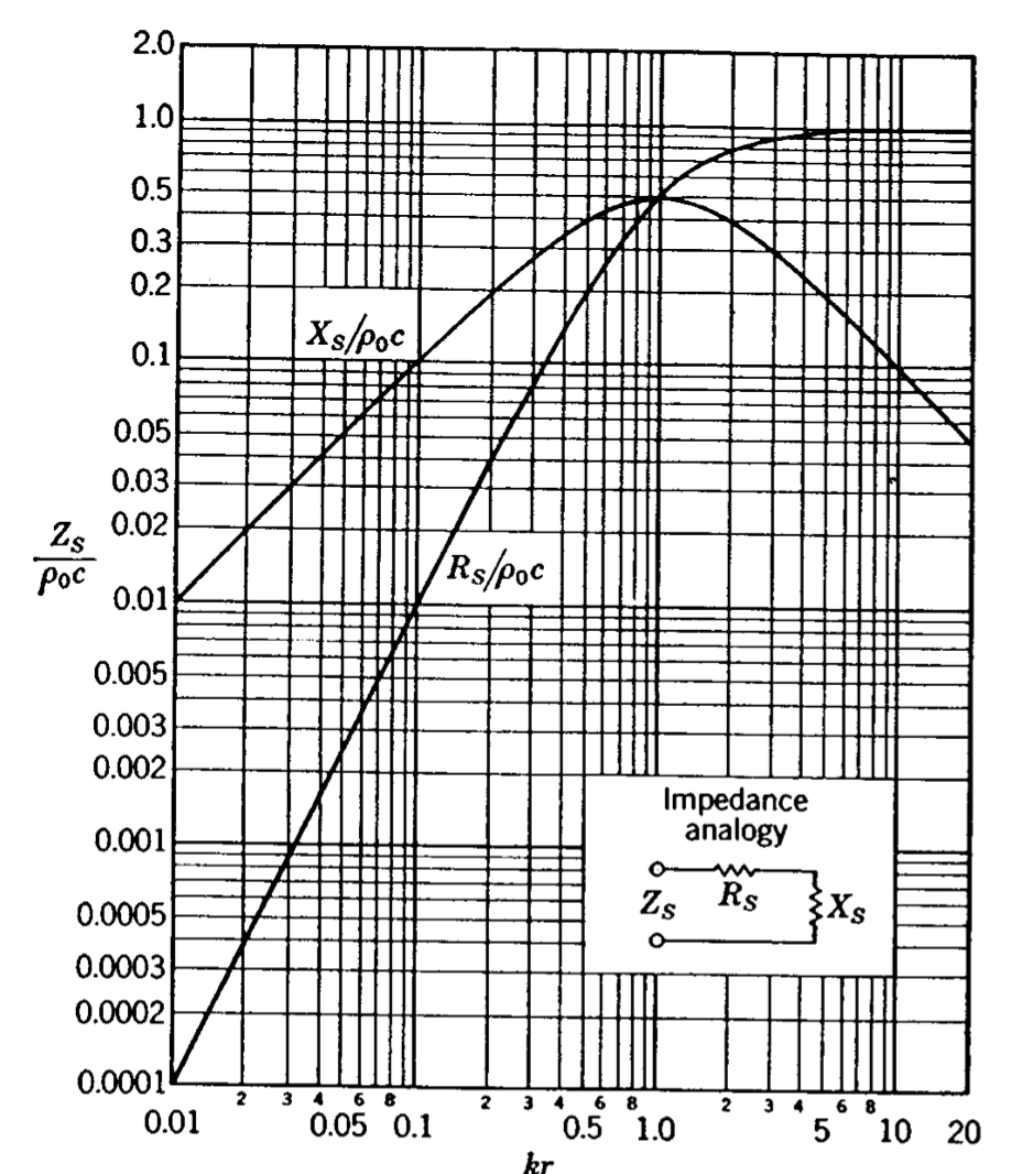

Let me cite Beranek on pulsating spheres here. It is an oversimplification, OK. But what you see here is that a source of given dimensions needs rising excursion to keep acoustic (power) output. E.g. for this example the excursion at 100Hz has to be four times that at 200Hz just to keep the same output. Think of that before you want to establish a 1st order acoustic highpass.

With the TW30WA12 and a 2500Hz XO we've attenuated 15 db electrical at FS.
Enough to keep excursion down? Maybe 😅
