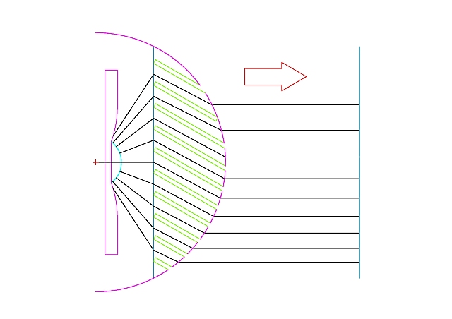

Pls, let me clarify a particular case. Let's focus on the VERTICAL dispersion for now.
I have the following Loudspeaker (attached picture).
- 1'' textile dome tweeter
- 10'' whizzer cone midbas
- 350 mm c-c distance between Tweeter and MIdbas (don't ask why - it looks good 😀 )
- 5 kHz Xover frequency
- ~ 2,5/3m to listening position
If I could control the vertical dispersion with a slanted wave guide:
- would I want to narrow it, in order to get better coherency between HF and Mids ?
According to the Xover frequency, the wavelength for 5kHz is 68 mm.
Distance between Mid and HF driver should be 1 wavelength max. 1/2 wavelength - even better....
My spacing is ~ 5 times larger.
I also apply my understanding of the slanted acoustic lens (attached picture).
If we form a convex shape with the slanted boards - we are supposed to narrow the soundwaves beam?
This is a vertical section

@ emosms
As per my original discussion, you are suggesting converting sound from a point source into a planar wavefront.
At high frequencies, this can be done by use of a path length refractor which acts like a convex or converging lens as shown in your diagram.
I agree with your thinking that this will produce a narrow vertical pattern.

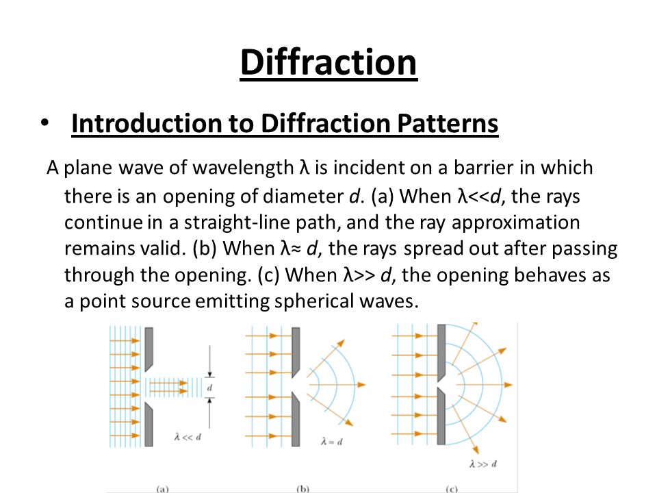

Hi Charles! Hope I don't appear to be combative if I quote the physics as I see it. Please feel free to mark my homework! 🙂
Both types of acoustical lens ('obstacle array' & 'path length refractor' - note the use of the word 'refractor' there!) bend light in an analagous fashion to the bending caused by refraction in an optical lens. I, and the learned papers, find the comparisons to light very useful even though the mechanisms involved are not the same.
Regarding diffraction, you will be aware that the degree of bending depends on wavelength (for those unfamiliar, see attached diagrams). When the wavelength is smaller than the width of the opening there is minimum diffraction.
In a tweeter, the plate spacing of the acoustical lens is optimised for the range of high frequencies (short wavelengths) over which it operates and the diffraction effect is minimal. Longer wavelengths, if allowed to pass through the same lens would be diffracted considerably, and this may be the effect to which you refer.
Rather than utilise diffraction, the plates force the sound to travel a greater distance than it would otherwise.
P.S. Regarding the 'medium of inhomogeneous density', refer to the workings of the 'obstacle array' type acoustical lens where I think the term qualifies.

It is not so much about utilizing diffraction but how to avoid it.
The sound wave will diffract at every edge of the lens the same way it unfortunately occurs at sharp cabinet corners.
Even at 20k the wavelength is larger than the gap the sound squeezes through in one of those lenses so diffraction will occur.
Re your PS I don't think it does as the sound would have to travel within the metal parts.
It is only mentioned on wiki as to be happening within the atmosphere if there are areas of higher and lower pressure ie temperature. Same goes for sound travelling under water.
