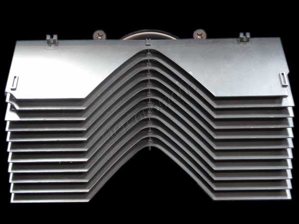

Returning to the 'slant plate' or 'path length refractor' type of acoustical lens, emosms may have to seek further information before designing his converging acoustical lens.
Apparently, the pattern control technique is the same as that employed with microwaves for creating unidirectional, planar wavefronts. (The wavelengths of high frequency sound waves in air are comparable to the wavelengths of microwave radiation.)
At the high frequencies involved, the acoustical lens operates on the 'ray model' where the sound passes out of the lens in straight lines. Diffraction will occur at the openings of the lens slits, but only with lower frequencies for which the lens is not designed.
