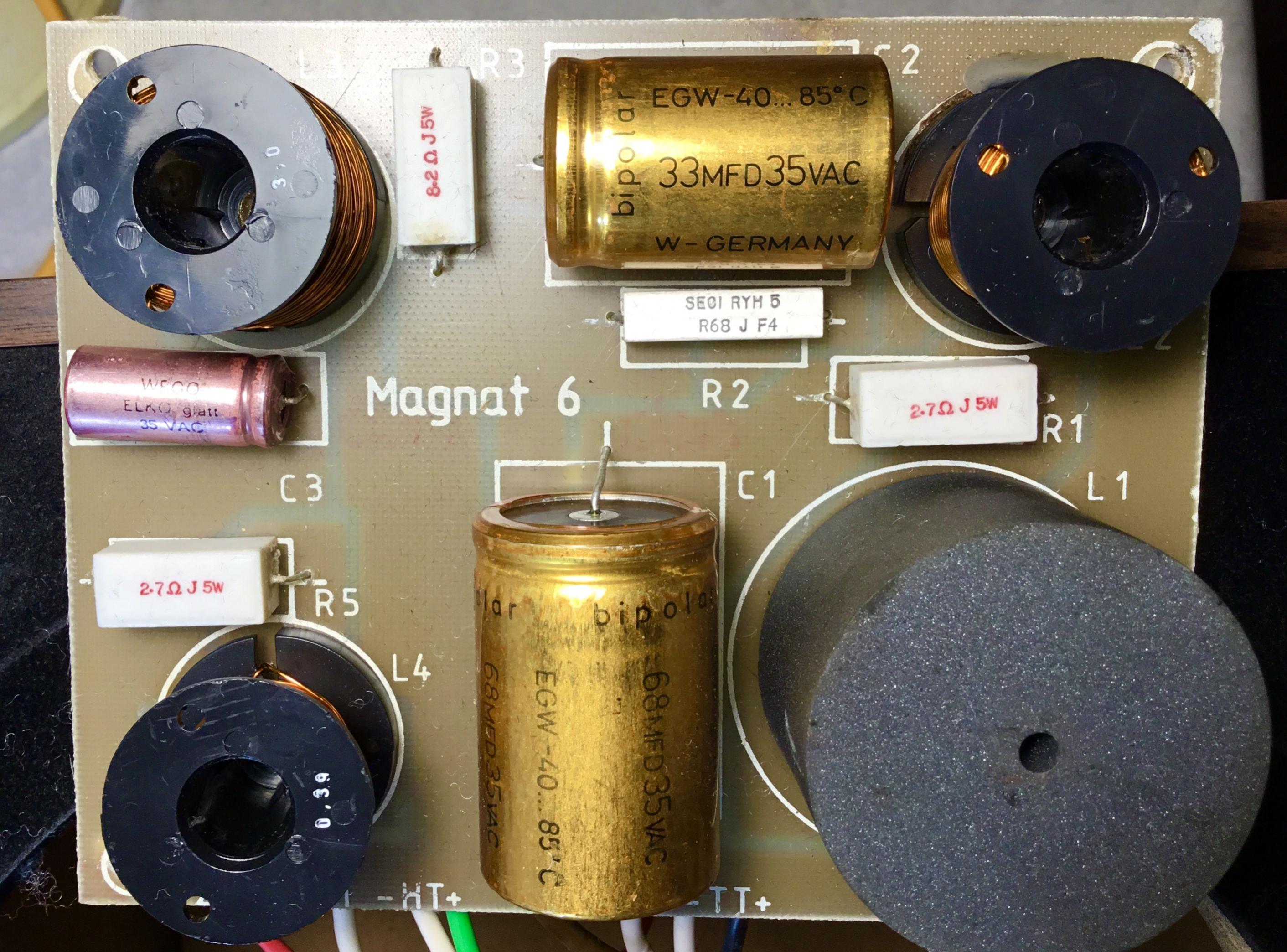

Repair and Upgrade Success!
I just wanted to round this thread off, with an outcome.

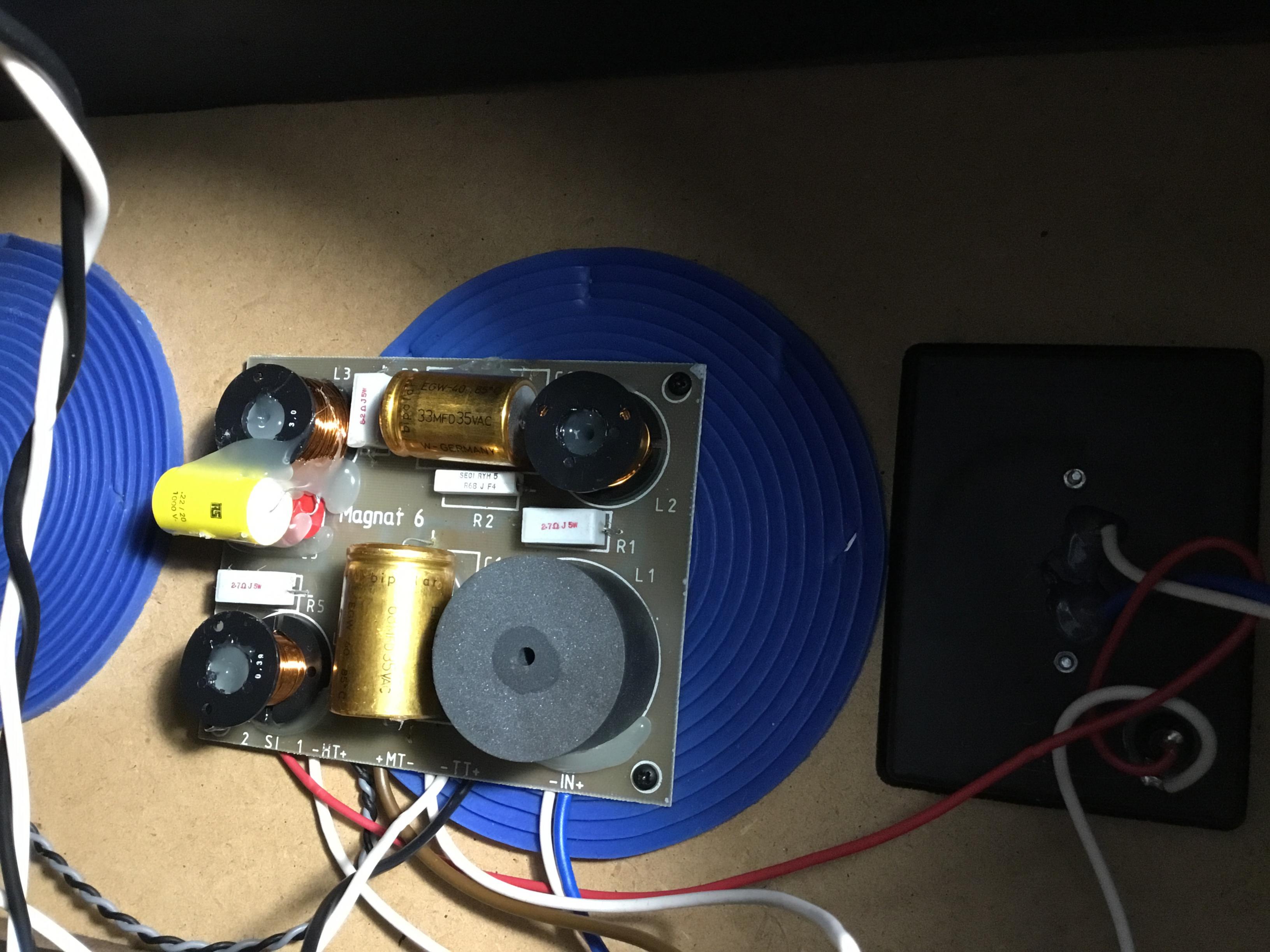

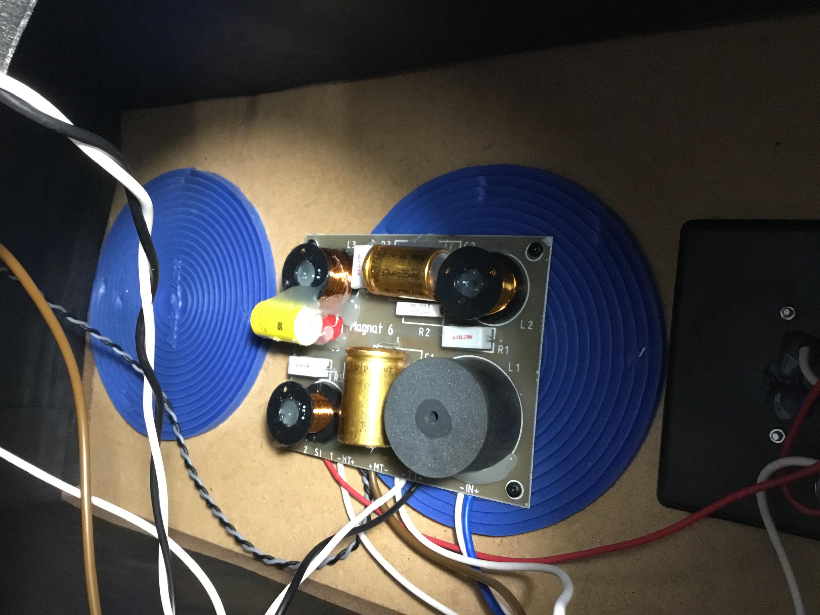

I decided that while I was under the hood replacing the blown tweeter - like for like - I would also try a few speaker upgrades... a la DANNY RICHIE of GR RESEARCH.
The three EL caps on the crossover measured superbly - out of circuit - but as a precautionary measure, I elected to replace the smaller (35-year old, West German) 3.9uF EL cap with two Polypropylene (MKP) caps.
One new cap was a high-quality 3.6uF 250VDC 5% that measured 3.556uF - quite a bit lower than the (over-value) 4.500uF cap it replaced - so I added a second new cap 0.222uF 1000VDC 5% that I have had lying around for years. The combined caps brought the capacitance up to 3.778uF which was about as close to the originally specified 3.9uF as I was going to get.
It was in my thinking that the slightly lower value of this new cap combo, would offset any additional volume the tweeter might gain through the move from EL to MKP.
Fortunately, I also have an identically measuring pair of the same two caps here, waiting for the other speaker.

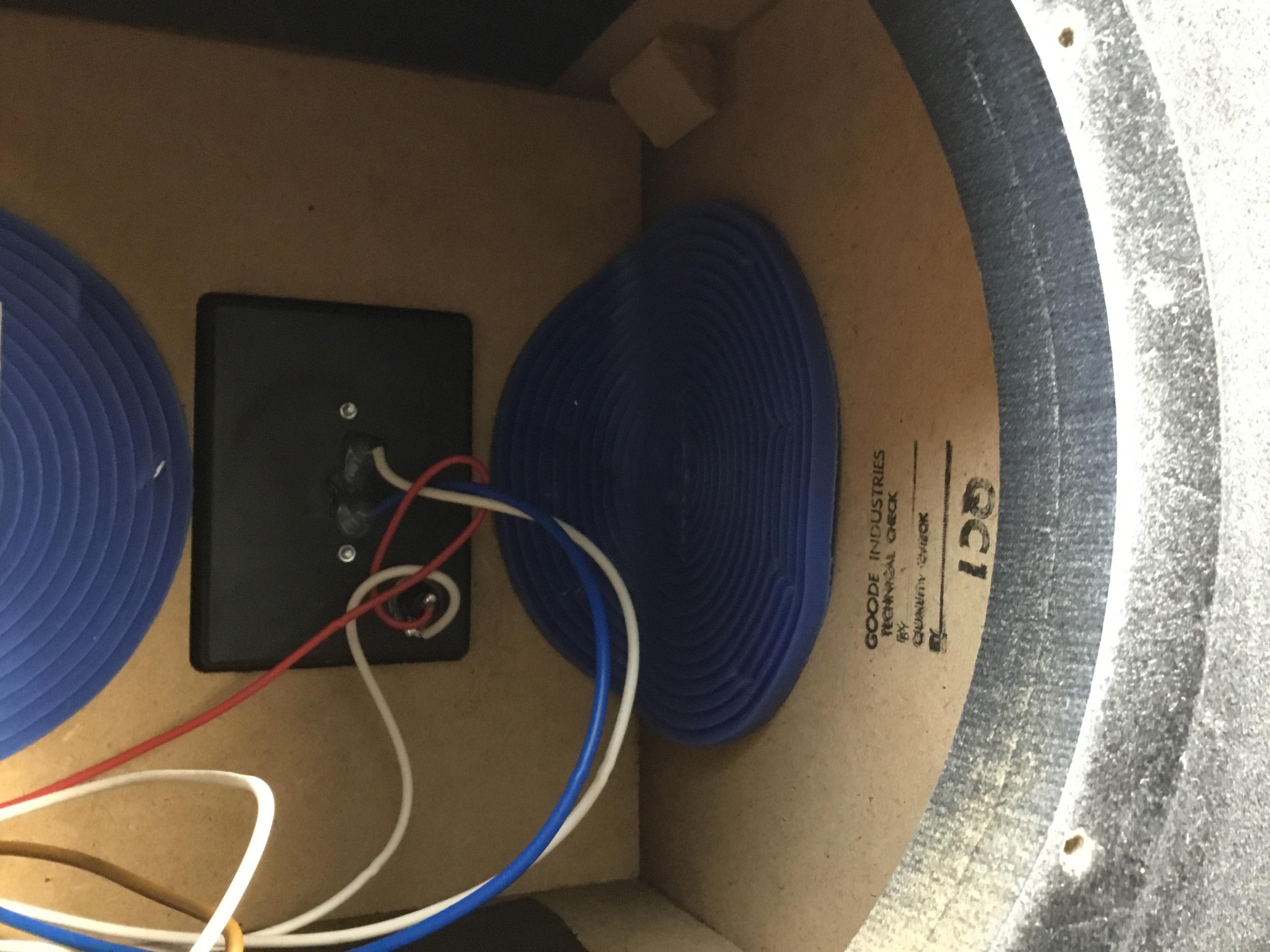

While I was waiting around for new caps to arrive - still waiting, if fact - I also: -
* Lined four of the speaker interior sides with 5mm acoustic mat;
* Installed three judiciously placed anti-back-wave "gel" pads;
* Dampened the Woofer Cradle with self-adhesive runs of acoustic dampener - taking care not to obstruct air-flow from the rear of the driver cone; and

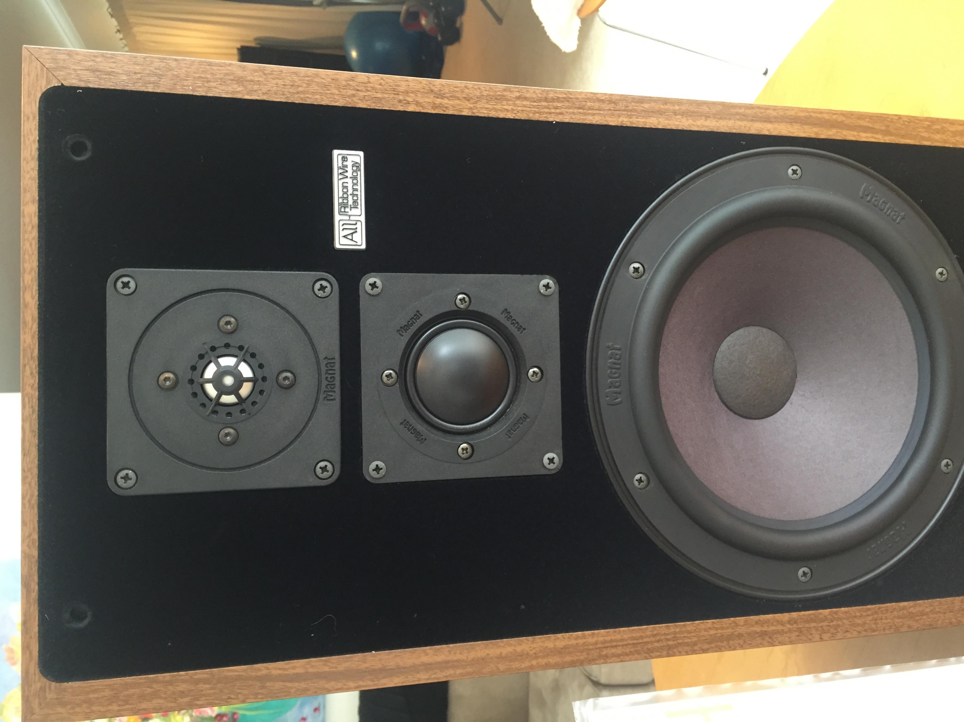

* Rewired the Tweeter from old and thick copper multi-strand flex, to Audioquest Crystal 2 18AWG solid core, high-purity copper.

So a successful conclusion. Please find a few pics below.
