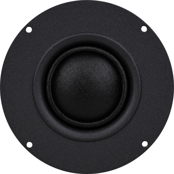

---- Morbo - At the risk of repeating myself, this tweeter:
This tweeter looks like the one I would like to use even at its $99 price tag. It is good to hear that you have found it to be as advertised. I actually have put it into Xsim but since the woofers are unknown I decided to buy the microphone, cords and learn REW so I can build a crossover that is a good match to the wavecors. I am really in no hurry since I have 3 sets of speakers that I rotate between that I really like and the wavecors are not available until December from Parts express.
-----Markbakk - "Gated Measurments"
Yes, another node on the leaning curve. Any of your wisdom would be appreciated, just need it it the form you would tell a fifth grader. :>)
https://hificompass.com/en/reviews/wavecor-tw030wa11-tweeter
https://audioxpress.com/article/Test-Bench-Wavecor-TW030WA12-30-mm-Cloth-Waveguide-Loaded-Tweeter
will do everything you ask of it, with aplomb. And you don't have to wrap your noodle around the waveguide, it's all one piece.
I don't think there's a more robust tweeter/waveguide package at this price.
One look at the off axis measurements of this (excellent) Wavecor and of any 8” woofer tells you they won’t match in directivity unless you cross below 1,3k. And the tweeter will then get a hard time with twin 8” woofers.

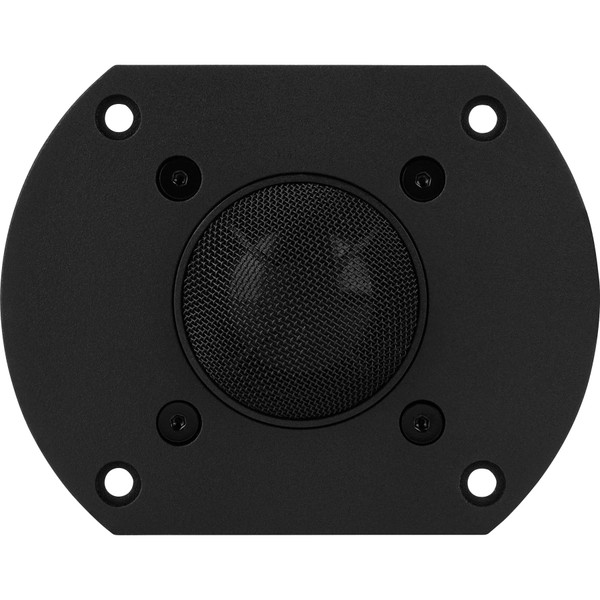

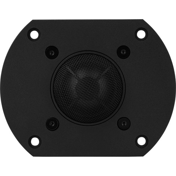

I have mixed feelings about the ADC and WG300. The top end isn't really smooth on my measurements. This was on axis and 30, 60 and 90 off axis, adapter plate used and front plate of the SB removed, measured in 21x39cm baffle IIRC.

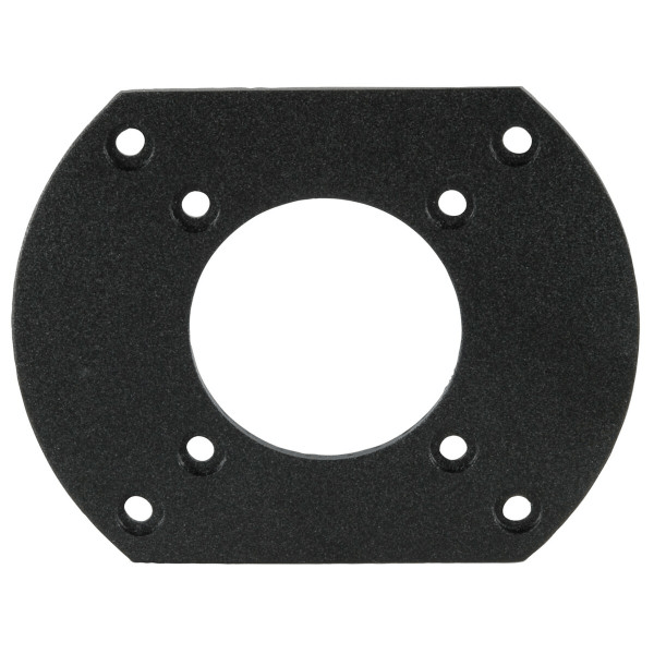

I will grant that matching a larger 3d printed WG to a sb26adc (or especially the Peerless DX25BG60) would probably be better, but not everyone is willing or able to print, finish, and mate a DIY WG to a disassembled tweeter. For those people, IMO the Wavecor is about as good as off-the-shelf solutions get.
This is true. But it will certainly match directivity better than any 'naked' tweeter without a waveguide. And even among the commercially available waveguided options, are there any that would match directivity lower, while maintaining low distortion?
I already gave the Monacor combo option. Visaton even provides measurements for their WG148 waveguide to be used In Boxsim. It’s not that hard actually.
