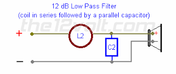

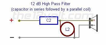

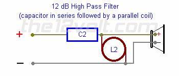

Since you seem new to crossovers, I attach diagrams showing what text book 2nd order high pass (tweeter) and low pass (woofer) filters look like.
The optimum crossover network to suit your drivers may contain additional components.
