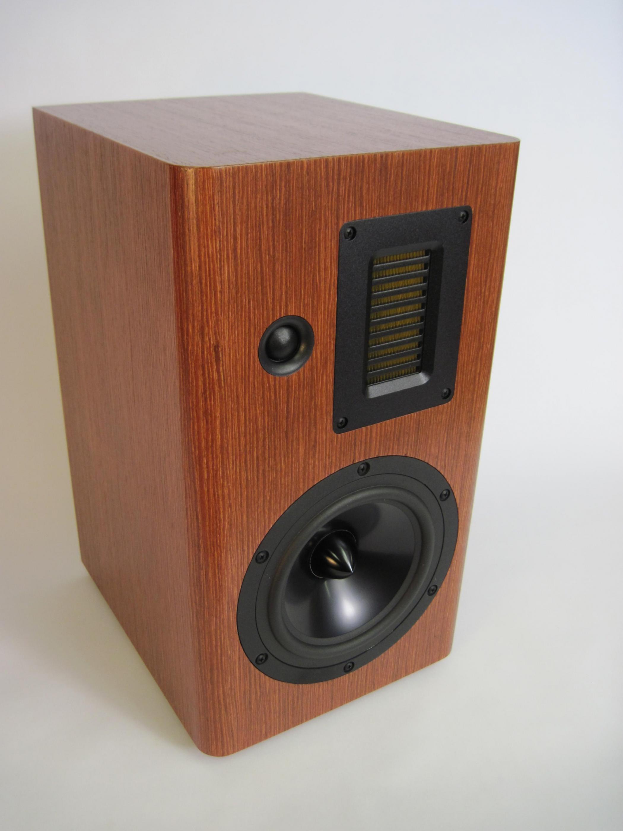

Yeah all passive, the mini is just a 1.5uF cap and level matching resistor.

The datasheet for the mini shows a drooping frequency response that seems a few dB lower than the AMTPRO-4. Since you used a level matching resistor, were you padding both of these down to match the larger drivers in the system after baffle step?
My phone won't show photobucket , but if you click the link I posted there's a xover schematic on the third page. That build was back in 2014?? So hard to remember what I did off hand.

I used the ND20FB at 12K with the AMT3-4. I definitely agree there's a benefit in filling in the top end.
Looking good! Was this a passive design & did you use EQ?
This was a passive design. Aesthetics won out on the horizontal placement.
