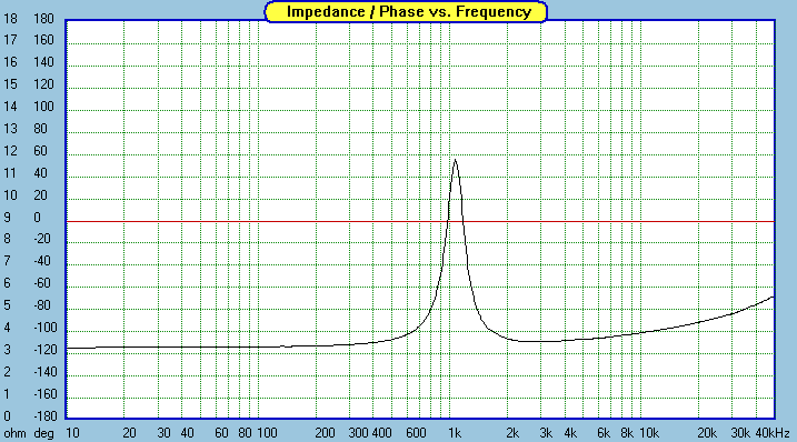

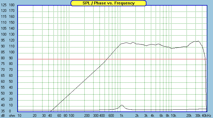

Have not played them, but I put a lot of trust into Zaph measurements. Also, from this forum, you will find "nude" frequency response measurements (driver was hung by a string) performed by member Joachim Gerhard here:
http://www.diyaudio.com/forums/multi-way/178350-zdl-7.html#post2403471
Download the pdf attachments to view the plots. Not many angles, but he did make a measurement at 180deg. The limited data looks good to me!

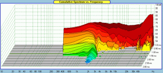

I'm attaching the Zaph data, including distortion. He mounted them in a beveled hole.
Thanks - checked Zaph but did apparently miss it. Looks really nice from 6k. Great!
Judging by the distortion and CSD plots, a 3k crossover point would be the lowest I would try with this dome. It is a 3/4 (18mm) unit after all. Anything about that should be fine. For this price it is an awesome little guy. Maybe that is why it has been continuously made available for quite a few years now?Thanks - checked Zaph but did apparently miss it. Looks really nice from 6k. Great!
