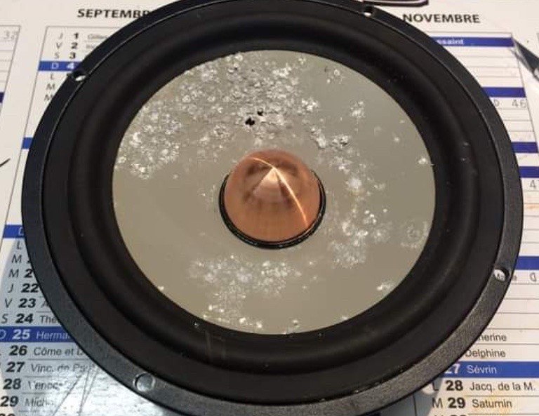

I was hoping to inform you, but I see I’m too late. Anyway, don’t clean them, although it seems to start from the back side first, as people have been having a terminal corrosion problem with the Excel driver cones. Much like aluminum, once it starts it becomes quite progressive. Depending on your construction materials, MDF or other glued particle boards, I might suggest treating the inside of your enclosures with a paint-on barrier.

If you experience this problem, please contact SEAS with clear pictures of the problem, don't try any repairs. They may help you.
Thank you for sharing your experience. I'm sorry for your driver's. This is a very aggressive corrosion. Did you find any of it on other metal parts of the speaker?
I'll keep in mind to apply some paint on the inside once everything will be glued together
Thank you for the reply. These were not mine, but show a known problem.
https://www.diyaudio.com/community/threads/corrosion-seas-magnesium-drivers.300775/
