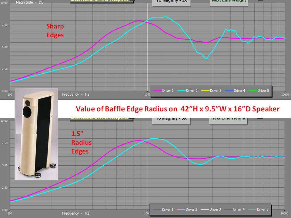

In 1950 Harry Olson's paper "Direct Radiator Loudspeaker Enclosures" used high quality diffraction measurements on several geometric cabinet shapes. A few speaker manufacturers use the lowest diffraction shapes. Many manufactures taper or round edges at modest cost for measureable diffraction reductions.
Both the size of the baffle and the speaker placement on the baffle produce noticable changes/improvements in edge diffraction and crossover shape. A larger baffle can lower the potential tweeter crossover frequency, but will also change the room's sound stage. Mounting a tweeter slightly off-center can spread edge resonances over a wider frequency range, which reduces the peak SPL bumps. There are a few good quality baffle simulators which allow grading many placement and edge-shape options before a build.
There are 1.5" quarter-round router bits for 0.5" chuck hand routers. There are 3" quarter-round cutters for 1" chuck 3-5HP shop shapers.

The oft mentioned harry olson figures are all sort of worst-case since he placed the ~2" driver at the geometric center of the baffle in all cases. You can fairly easily find out with software that even a sharp edged circular baffle can work if you are careful with driver position. For example, placing the driver just ~1/4 way from the center of the circle to the edge smooths things out a fair amount.
Many commercial speakers are pretty narrow. This effectively reduces the sound wave intensity which illuminates the baffle edges as the tweeter would be more directional. Cabinets are also often rectangular with the tweeter having only two symmetric dimensions - usually to the sides. Many tweeters are often loaded by a small waveguide which drops the frequency of 2pi transition, even if they`re very small at 90 degrees they can have substantial effect. Then when you address the remaining ripples in the crossover and use smoothing - you can get a pretty flat response. If the tweeter is offset properly, the loudspeaker can be made ruler flat from 1Khz up even with 1/12 smoothing.
