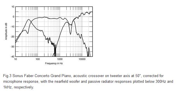

H1280-06 22TFF

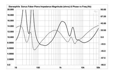

You'd need to attenuate that one by about 6dB at least. The woofer is "interesting". No dustcap, and a huge hole at 3kHz. Guess it shows that a dustcap acts as a midrange and "sings its own tunes" as somebody wisely remarked.
But without a schematic of the speaker, it's hard to suggest real improvements. But I certainly don't like the impedance, which doesn't look first order at all.
