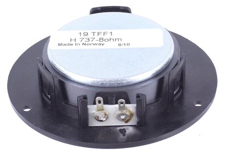

I stabilized the clip-on interface of the Seas 19TFF1 tweeter with a few drops of epoxy glue. Cleaned up the treble somewhat. Only reversible if you buy new tweeters from the Sonus Faber agent. The standard 19TFF1 won't do, because the originals have SF's logo on the face plate.
I isolated the tweeter from the pressure of the mid-woofer, ensuring that it operates in its own sealed chamber. Fortunately this was easy to to, since the tweeter did not protrude behind the thick front baffle. This resulted in significantly improved treble response with less fatigue. A stethoscope test with the tweeter disconnected led me towards this mod. This mod can be made reversible.

Firstly, by default the tweeter is already sealed and therefore protected
from the waves that travel in a box. Why seal it any further?

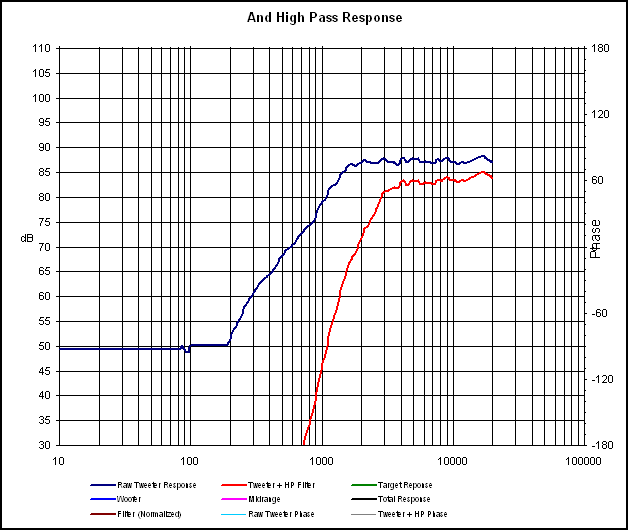

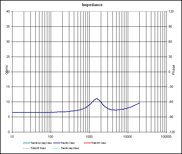

Secondly, have a look at the traced impedance plot and its Fs peak
well damped with ferrofluid and the FR plot that includes
a raw driver response and a filtered one ( 4R7, 6u8, 0,22mH, 5u6).
A series resistor followed by a 3rd order electrical imaginary filter.

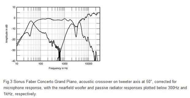

If we look at the review, there seems to be going on something odd that
qualifies for an upgrade, but that would mean to heavily modify the whole
mid to tweeter range, not some meaningless aesthetic changes.

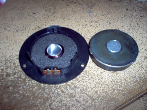

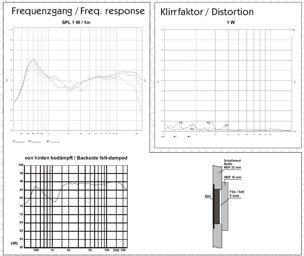

Let's examine our dilemma right at the origin. As an example of how a
manufacturer treats an open tweeter, I have chosen the Eton ER4 and
the measurements that are made with and without the back side damped.
You can see the holes in the response when untreated.

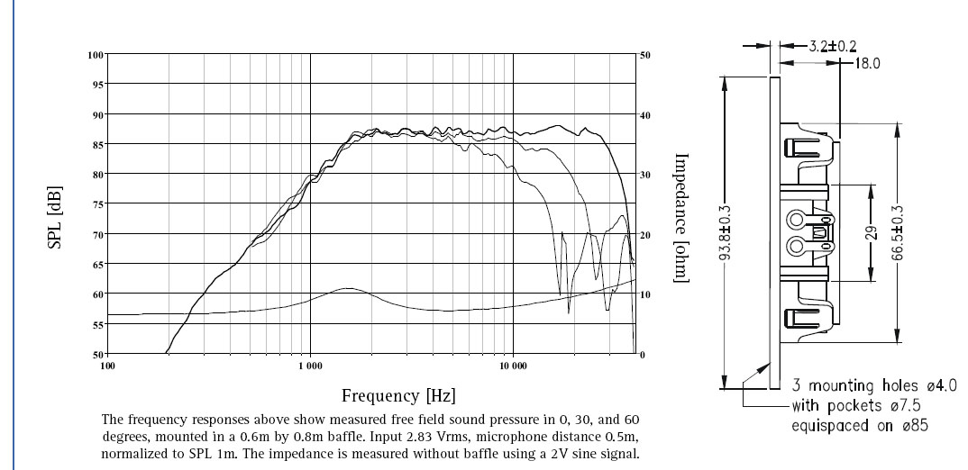

The Seas doesn't mention anything about their tweeter being open or in a
need to be additionally sealed in a cabinet. They have managed to produce
a front side of a tweeter without the need to use extra screws, only those
that go in the cabinet baffle. That was their angle in reducing costs. The
performance measured is typical for a solid quality piece of technology.
