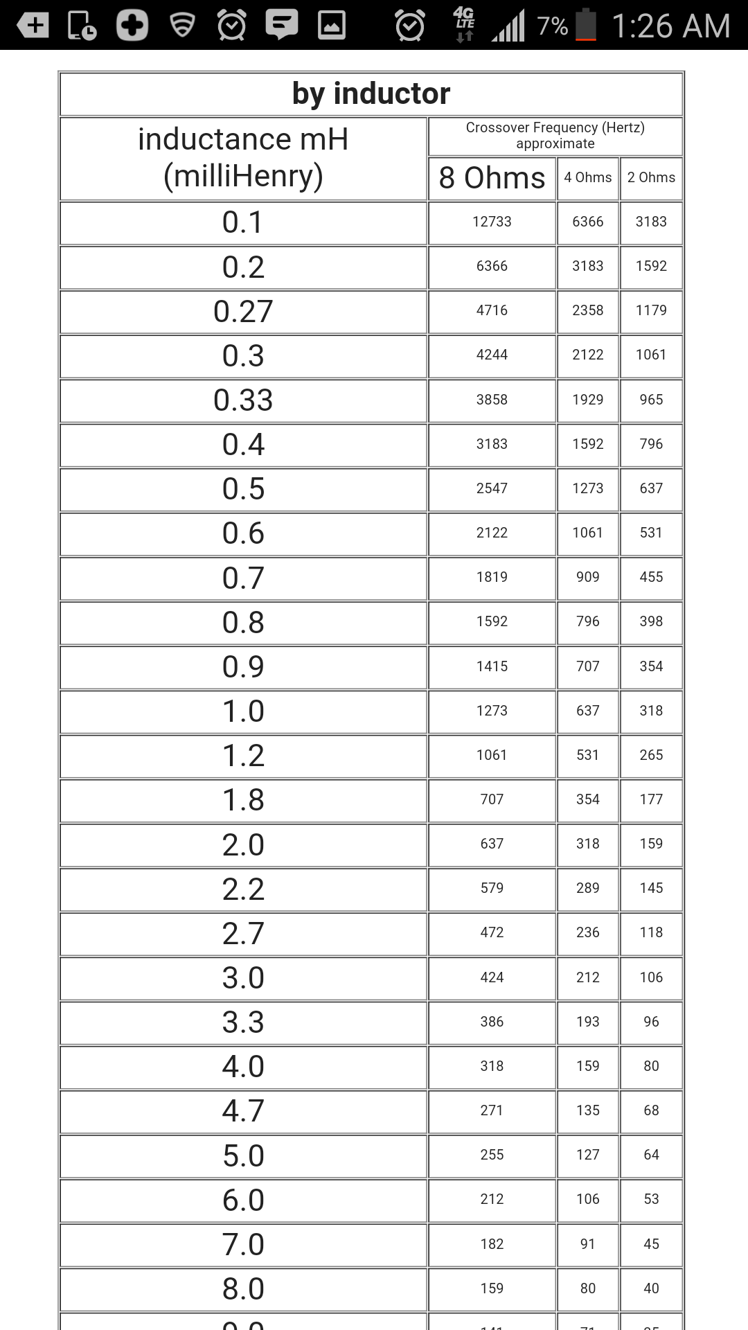

It's low pass filter is 1.15 mH inductance coil. Pretty sure
It's a 6.5 or 7" woofer. Pretty big. 8 ohm resistance.
According to specs cross over is at 4000hz..
Now
on lcr600 s3 a .7mH coil is used.
Smaller woofer. 6" I believe.
Resistance of each is 8ohm. Or 4ohm of 2 of them in parallel. Same 4000hz cross over point.
Looking at chart attached it seems that lcr600 s3 (4ohm parallel set up) low pass filter is at around 900hz.
Dm602 s3 (8ohm) low pass filter is at around 1100hz.
Basically much lower chance of kevlar break up on lcr600 s3. Am I thinking right?

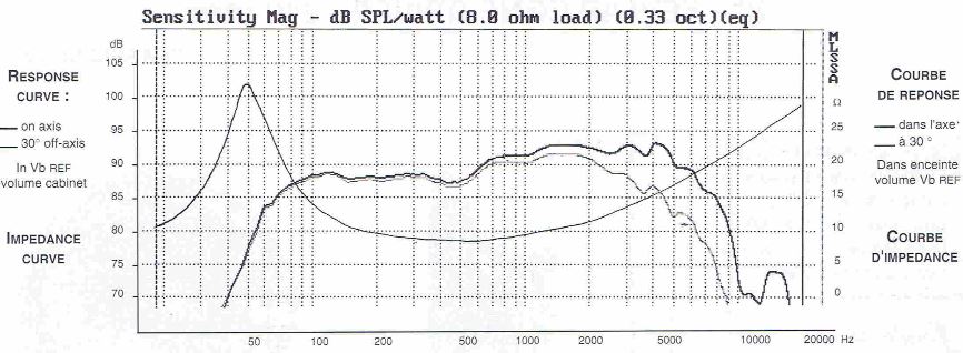

I just looked up a typical Kevlar driver. The Audax HT170K0. Looks easy enough to filter with a simple coil for about 4kHz crossover. But some breakup at 4-5kHz there. I'd want to get it 10dB down at 5kHz with a third order filter. 6" speakers have other issues too. Mostly poor time-alignment.
