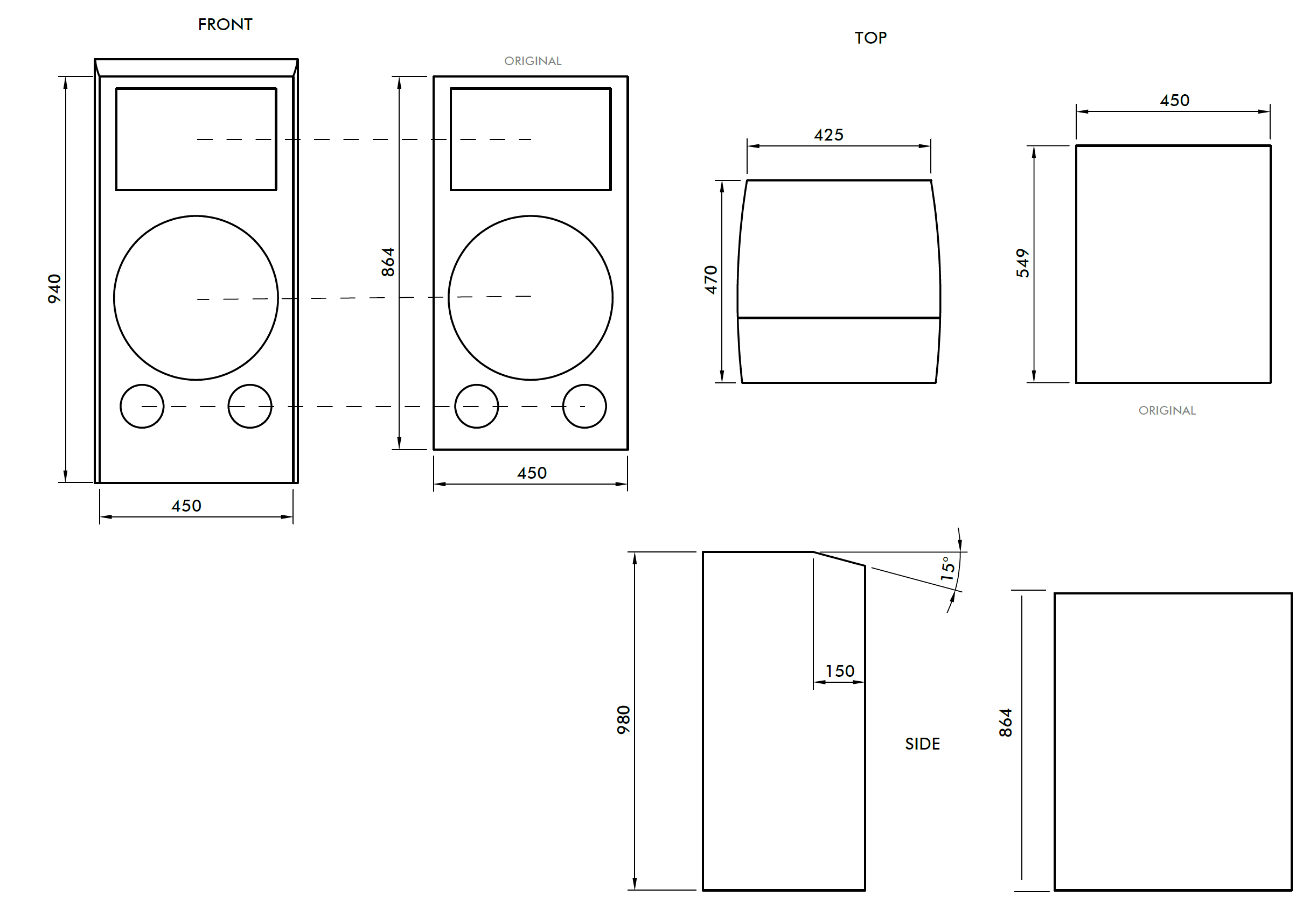

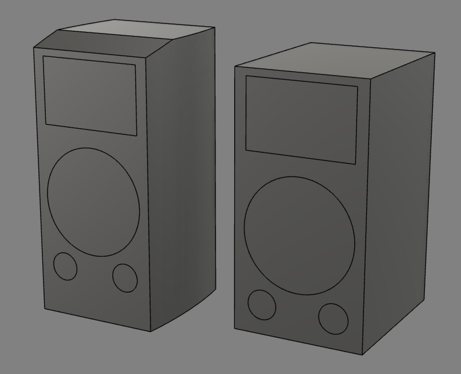

After all your comments, I'm thinking of something like this.
Original gross volume is 213 liter, mine is 206. Original design has 18L worth of bracing. I'll probably have less, or I'll add another centimeter (or two) to the bottom (height).
Baffle is exactly the same, except the extra 7.5cm added to the bottom.
Only thing that might not be ideal is the square-ish profile. width:depth ratio is around 1:1.06 but front to back standing waves shouldn't be too big a problem due to the front baffle being almost all driver and horn.
Any comments?

Looks workable.
I think you'll need to keep all the 40 x 40mm lumber in the corners for structural integrity though. I'd keep the 1 on the front baffle too. If you remove the rest of the bracing though it'll be panel resonance behavior that you need to worry about more than standing waves now I think. In effect the cabinet will be functioning more like what the BBC does for their panel resonances which is to not use bracing but lots of damping on thinner walled panels in order to keep the panel resonances quite low in frequency instead of trying to push them up high.
For structural purposes with a cab this large I wouldn't go with thinner panels though and you don't need to anyways because the panels are so large that the resonances are low enough to start off with. The problem is that your side and back panels are all almost the exact same size now so all of them will have about the same resonant frequencies without bracing. Although the resonances will be perceived as less audible because they are so low in frequency and because the damping will reduce their amplitude, 3 of the panels doing the same thing might add up to something undesirable.
What to do? If you ditch all the panel bracing I would still keep what the Calpamos did on the back panel which is glue the driver cutout to the back panel. That will raise the resonance frequency a bit so it's different than the side panels but still not too high. Then apply the damping material like the original. Or alternatively maybe keep the single brace on the back panel.
If your net volume does end up a little lower than the original, in that case adding in some stuffing to the back half of the speaker may be a good idea as it will increase the effective volume of your cabinet just a little and it will also help with the standing waves back there too, both vertical and side to side. Make sure to leave the back of the driver and the back of the ports clear.
