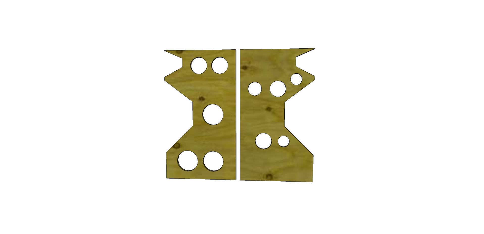

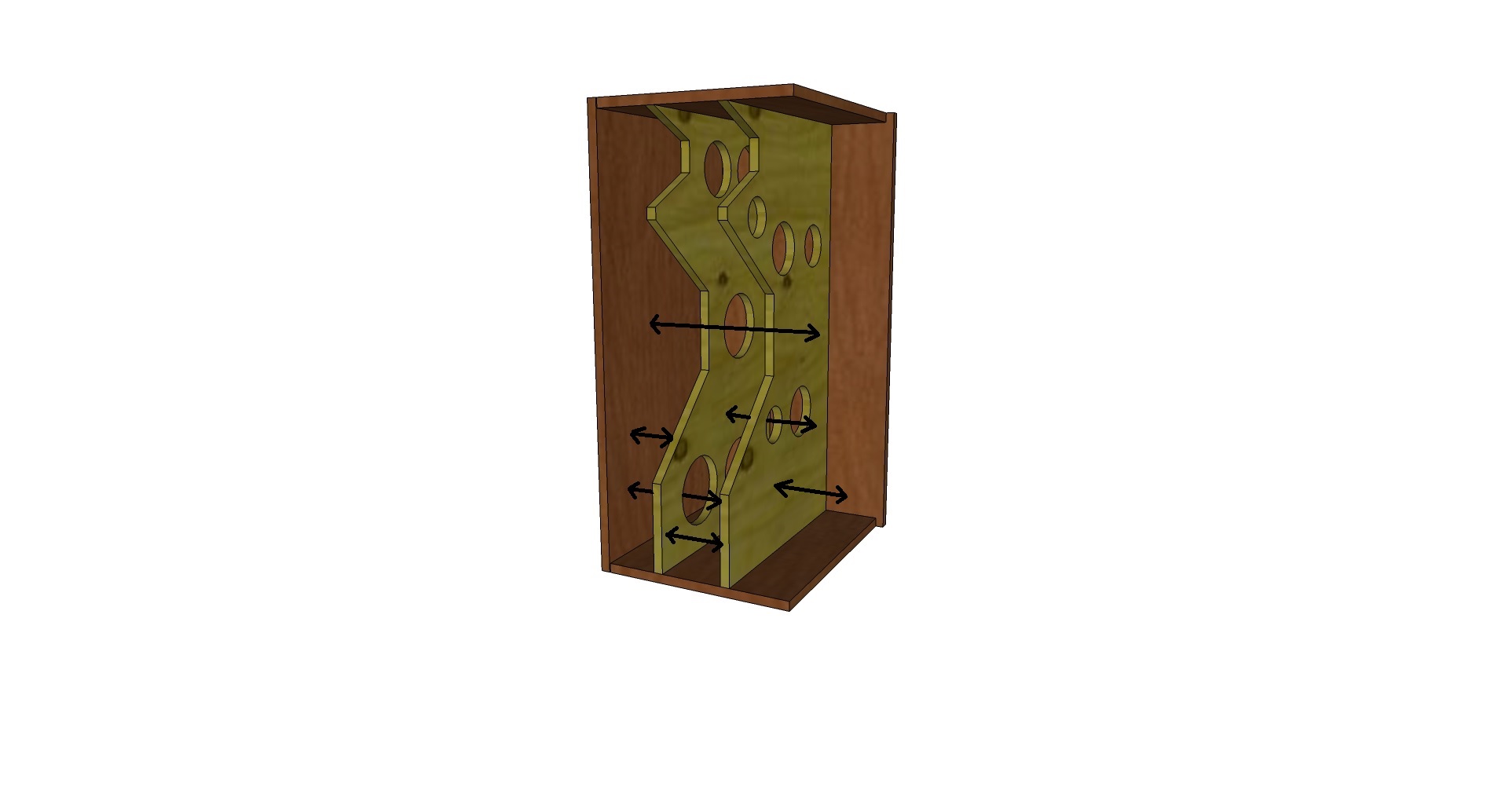

tmuikku, thanks for the reply but sorry, I'm still not getting it.
First let's make sure we agree on the definition of standing waves. Standing waves form when a soundwave is reflected back and forth between 2 parallel surfaces such that each reflected wave is a mirror image of the other and the wavelength of the standing wave will be equal to twice the wavelength of the reflected wave.
Now in case we are each thinking of a different bracing situation, attached is a very simple rendering of the cabinet in question with 2 vertical braces as I suggested in my original post. The 2nd pic shows only the braces from the side with the intent to highlight that the breathing holes in each brace are offset, or in other words that they do not line up in the vertical dimension and therefore will not allow a straight path from 1 side of the cabinet to the other.
Now clearly as you say there are still pathways for sound to travel between the braces and the parallel sides. No question there. However the only places that allow a direct path for reflections to form between the side panels should be the tiny spaces between the driver cutouts and the drivers (in the tweeter's case, the waveguide also) pic 1, top arrow. Otherwise, the side to side reflections and therefore the horizontal standing waves now should only exist between each side wall and the surfaces of each brace including through each hole in 1 brace to the surface of the next brace (middle arrows), as well as between the parallel surfaces between each brace (bottom arrow). Pic 1 doesn't include any horizontal braces but I would add some of those in as well. One could also take it a step further and install the braces at angles so there would be virtually no parallel surfaces at all.
I'm also having a hard time understanding your difficulty accepting the idea that something can perform more than 1 function. Yes, the primary function of bracing should be to solve panel resonance problems but as a secondary function they can also break up the formation of standing waves. Damping material will also most certainly help to prevent the formation of standing waves, but it will also help prevent reflected sound from leaking back through the driver cones, help to diminish the sound transmission through panel walls and thereby also help to attenuate the amplitude of panel vibrations, as well as function to alter the internal volume that a driver will see. Multiple functions in other words.
The same can be said for xo components. A single series inductor can function to compensate for baffle step loss, help to determine the driver roll-off at the xo frequency and with the addition of a parallel capacitor, it can also function to create a deep notch. Designing with something that performs multiple functions just seems like good engineering to me.
If any of the above is incorrect, please let me know.
jReave, thanks for the images. To me, this sounds like a very logical solution to a cabinet that might be susceptible to standing waves due to its dimensions (square-ish). Would be interesting what others think, as I'm not very well educated in the science of acoustics.
Following this logic, wouldn't diagonal braces be even better?
