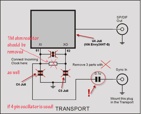

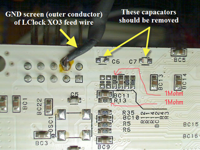

There are a couple of caps on each clock... C4-C7 in toto. You remove them and the clocks and can feed the clock signals in. If you want, you can upgrade one or the other of the clocks and leave one alone, if you use that sampling rate family most of the time.
Both clocks are active all of the time, AFAIK. One, the 24.5760Mhz one, is used by the Envy chip as it's internal clock. The Envy chip MIGHT power the other down and up as needed, but I doubt it... and it works ok with a full-time on 22Mhz clock.
The Fidelity Audio Micro Clock is a neat little device with two good, but not great upgrade clocks (def not at the level of the NDK or Crystek). I have one of the previous versions without the good onboard regulation, but have never taken the time to install it. They say it was developed for the Squeezebox Touch, but works on the Juli@ just as well.
Attached are some pix from one of the Juli@ mod threads on the Asylum showing some of the details.

in case you are using 4 pin oscillator, you should remove the 1M ohm resistor that is a cross Juli@'s clocks, and then the new clock can be soldered directly to where the 1ohm resistor was, ....there are vias under those resistors right next to the Chip's x-in pins.
this way you will be able to have the shortest connection possible.
...get rid of that resistor and you will be shocked with the improvement!.
