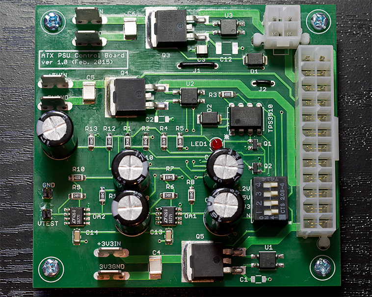

An ATX power control board isn't so hard to implement, why not use one? (For me it was quite a learning project but I had very good tutoring particularly from Mark Johnson.) The most complicated part of mine is the measurement amplifier I added in order to measure the noise on the power rails. (It accounts for almost all the parts between the 12V input and the 3V3 input.) Having just said that, I've not been able to test the module yet as I don't have a 3 voltage bench PSU. I have to complete my PSU rails first. The board is 80mm x 85mm and the core of the power monitoring and sequencing is performed by a TPS3510.
As for "putting in two botched clocks" well I agree I botched the removal of the crystals but the trace damage was repaired. We are, of course, debating the correct wiring for the return path and whether this can be improved. I'm afraid I'm not sure your last questions make sense. Perhaps you can elaborate.

As an aside, with respect to motherboards I am only interested in mini-ITX ones that have a well-placed ATX power socket, HDMI, either mSATA or m.2 for the OS and nothing to interfere with the passive cooling. I am currently using an ASRock Z87E-ITX but may well replace this in my current build.
But let's try to keep this thread to modding the Juli@...
I'm happy to chat offline or in the respective threads for my ATX control board and my PSU if anyone wants.

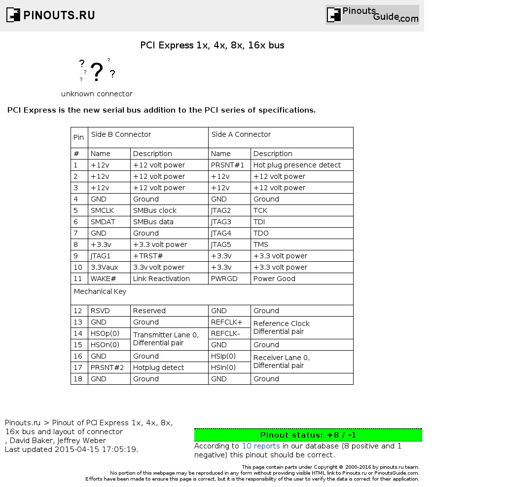

Hi everyone!
This post a little old but I am trying to power esi juli@xte with hybrid power supply.
I use riser cable and 12v battery and dc to atx converter.
I cut the 12v 3.3v cables on the riser cables.
But I couldn't be sure about ground cables.
Which grounds should I connect to new PS?
And should they be connected to computer psu at the same time?

To power the card separately, you need to supply 12v and 3.3v to all of those lines on the riser cable. These lines should ONLY be connected from the separate power supply to the card, not to the computer.
Then you also need to connect the ground from the separate power supply to the ground lines on the riser card. These lines must stay connected to both the card AND the computer, you are just adding a connection to them from the separate power supply.

Should I connect all the grounds or Is there something like signal ground vs power ground?
