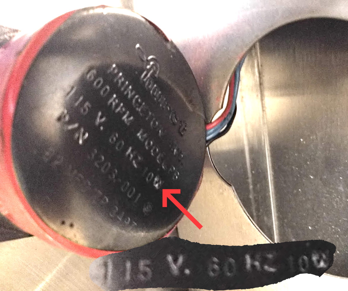

Godataloss, Chromenuts advice is spot on, check the actual motor. 5W is OK that's only a bit more than the 3.5W airpax/premotec motors. If it's 10W then larger heatsink will be required on the transistors and potentially a couple of component changes. I think I would need to test this for you so you will need to confirm back. Post a picture of the motor label with the specifications.
Sorry for the crummy pic, but this is what's in my google drive from when I replaced the cap on the motor. I tried to sharpen it up and it indeed looks like it's labeled 10 watt. I appreciate your help.

Hi Godataloss
It seems like it was common for people to “upgrade” there VPI turntables with these higher wattage motors which could be sourced cheaper from other Hurst suppliers instead of paying VPI a premium or VPI actually switched to them at some point because it was what was available from Hurst.
I’m not sure how much of a hassle it will be to drive a 10 watt motor.
I took a look around the web and saw your Hurst part number mentioned quite often when discussing motor replacement on the VPI tables.
I also came across an interesting thread on VPI’s forum where DIYAudio member Pyramid, who designed the Pheonix Engineering turntable control products as well as the SG4 project on this forum, discusses the characteristics of the 300 and 600 RPM Hurst motors as well as lower and higher wattage versions.
Pyramid posted data (much to Harry Wesfield’s chagrin) captured from a 3 axis accelerometer which he used to quantify the vibration created by the motors due to there cogging effect caused by permanent magnets.
I only mention this because it seems Pyramid appears to come to the conclusion that if you have to use one of the Hurst motors that you are probably better off with a lower wattage motor since they appear to be quieter.
Here a link to the thread:
vpiforum.com • View topic - 300 rpm mtor vs.600 rpm motor
Perhaps a lower wattage motor would be easier to deal with and also quieter in the end?
Yeh, I read that exact same thread and was quite entertained by it. I've got my motor well isolated. The motor board is raised on shot filled adjustable stanchions resting on an inch and a half of sorbothane, so I'm not all that concerned about the great vibratory debate. I think the vibration that could be conveyed by the belt is very minimal in my setup. I'm much more concerned about the affect on speed by the cogging jitter. I've considered swapping it out, but my pulley is glued to the shaft and I'm not certain I can remove it without damage and they are unobtanium. I have a second HW 19 I got cheap as a backup I'll have to check to see what motor is on that if the 10 watter is a no-go.
