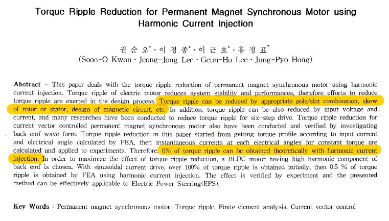

I think Mark is on the right track. I’m an electrical engineer and before I retired I worked on projects with multi-thousand horsepower 3-phase synchronous motors. In this size range the rotors are built with wound coil poles and energized with DC current instead of using rotating permanent magnets. The rotor pole pieces are contoured and the stationary coils which are connected to 3-phase AC are overlapped so that the rotating magnetic field and the “pull” from each phase is as purely sinusoidal as possible. Because the 3 phases are 120 electrical degrees apart, the mechanical torque developed by each of the three phases ideally sums to a uniform cog-free torque on the shaft. If it’s not done right then you get vibration, and it puts harmonic distortion on the incoming AC power line.
It appears to me that “shaping” the magnetic field in small synchronous motors is physically difficult but pre-distorting the AC input voltage with engineered “anti-harmonics’’ to compensate for the inherent cogging would be effective, and that is what the research paper demonstrates. I have a feel for what they’re doing by looking at the figures and graphs (I can’t read Chinese), but the math is above my pay grade. It seems counter-intuitive, but the research suggests a power supply that generates a pure sine wave might not be the best approach.
Ray K
attachment.php
