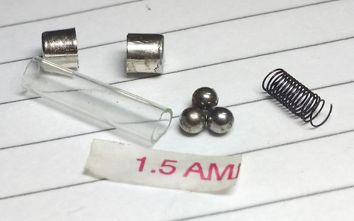

But I can very well imagine a small vertical tube filled with some fluid with a metal ball in the middle, held in place by two spring.
A ball being a bit smaller as the tubes diameter, could move up and down with no stick, the fluid acting as the friction element dissipating the motional energy.
Fres of the Ball/spring combination should be around 10 Hz.
Taking a 4 mm ball weighting ca. 0.5 gram, two springs of 1 N/m would be needed to keep the ball in the middle.
Length of the tube (15mm?) and viscosity of the fluid still to be determined.
Idea worth trying ?

For damper we can use glass tube of amplifier fuse. For time being instead of spring a little piece of sponge ? OR if we are placing it vertical a same size plastic bead will help the steel ball float perhaps. If some how we can control viscosity we can tune it also.

We all know from experience the metal caps on a glass or ceramic fuse will only come off when you don't want them to. If you want the metal caps to come off, then the glass will surely break. 😉

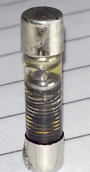

I put a small fuse in boiling water and with some effort managed to get the cap off. Also found supple spring and ball bearing. I dont have means and knowledge to measure things as I don't have PC at home. But will make micro damper soon.We all know from experience the metal caps on a glass or ceramic fuse will only come off when you don't want them to. If you want the metal caps to come off, then the glass will surely break. 😉

Thanks Super. I did assembled the damper. I have a record track (regional language) on which headshell can be seen vibrating; with equal tracking weight (with and without damper) I attached it with rubber band. Visually I can not see any movement. The spring is very soft like typical antiskate spring usually found on turntables. So either I need more ball bearing weight or softer spring.
No alternative than tuning the mass and taking measurements as you have said super.

In posting #964 I calculated two springs of 1N/m with a metal ball of 0.5 gr.
In case of using just one spring, a 2 N/m spring should be used.
2N/m means approx 200gr/m or 0.2gr/mm.
A 0.5 gram ball should shorten the spring in that case by 2.5mm.
This is a very weak spring and looking at your spring I suspect yours to be much stronger, resulting in a Fres that is much too high and therefore being ineffective for the purpose.
I'm, still thinking how to construct this spring.
