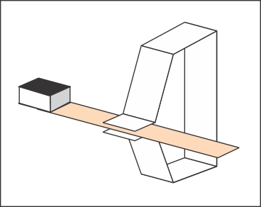

For vertical damping as Hans has said springs or a steel ball rested on synthetic sponge in liquid fillled tube should also work I guess. OR we can use leaf spring as shown in picture. a metal spring clamp holds the springy leaf which has weight attached at the end; by sliding the holding point I think one can tune the damping mass.

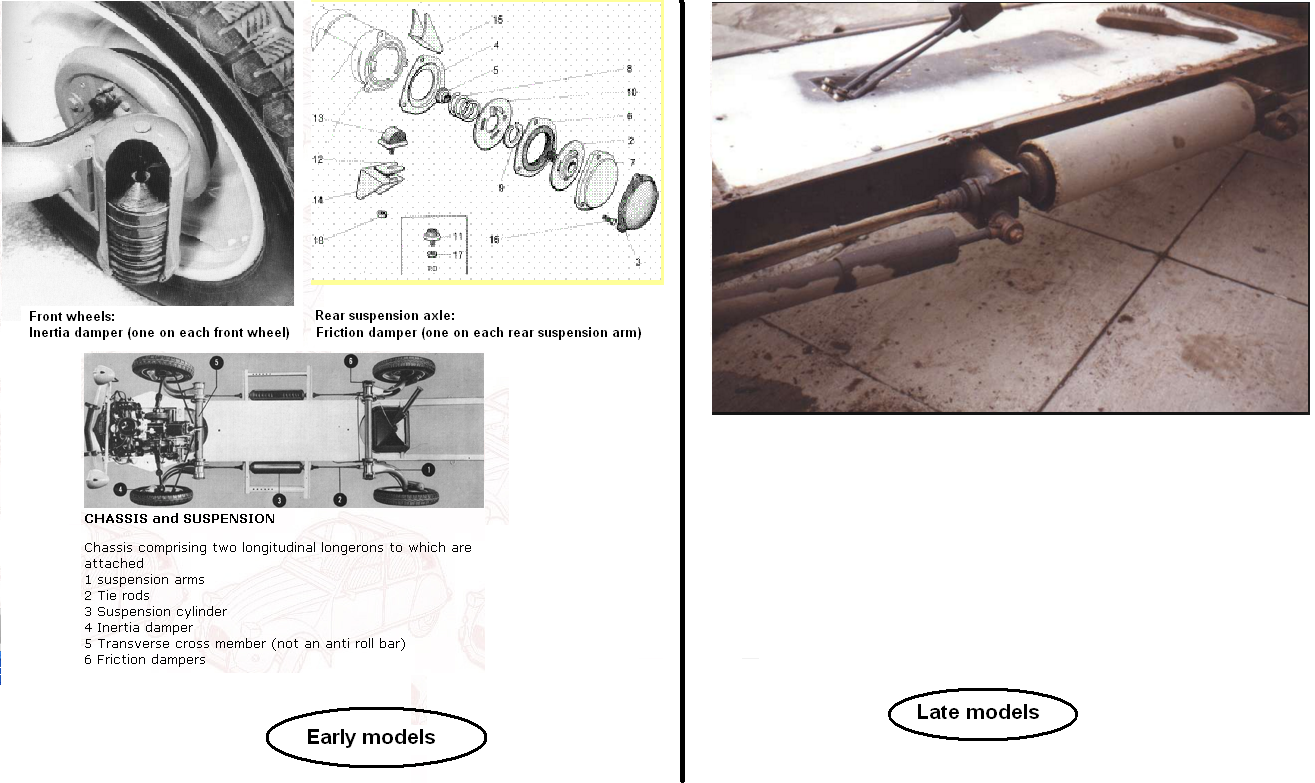

This is exactly the shock absorber on a Citroen 2CV.
On the original and all early 2CV models up to around 1960:
The front wheels dampers were actually suspended mass inertia dampers, the suspended mass resting on a spring. The tinny oil quantity inside was only for lubricating the up-down sliding sides of the suspended mass .
The rear axle dampers were spring loaded, rotating friction plates.
On the later models these front and rear mechanical dampers were replaced with ordinary hydraulic pots horizontally placed, damping this action of the ingenious, simple spring suspension system of the 2CV:
Entmontage - Technik Fahrwerk

Hi George,On the original and all early 2CV models up to around 1960:
George

I agree Hans. Not much of friction (true, I have checked it in the past), means that the early 2CV front damper functions as a carefully tuned mass damper (working under the conservation of momentum principle)
George
