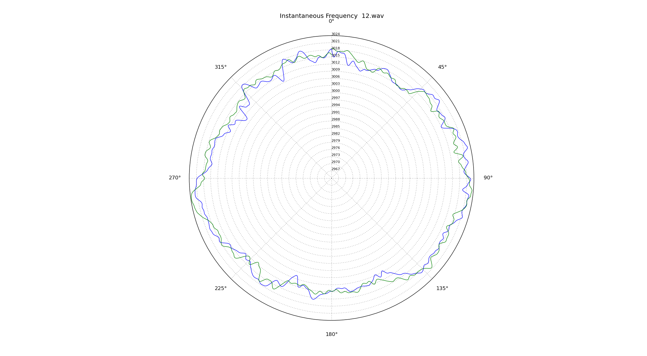

Now I got it -- this is the same track this time with a weight clamp fitted.
A bit better, however, it shows clearly why I was uneasy with the deck lately!
It is with a Yamaha GT2000, and it should definitely perform better.
Is there a pattern to recognize out of the plot of what might go wrong?
EDIT: it is not only wandering quite a bit, it is at the same time high-pitched (around 3015 Hz instead of 3000Hz) (PLL-Lock LED is on)
R.

However, this particular one is not only eccentric but with a slight [insert english expression for 'Höhenschlag' here] as well which may at least in part explain what is going on.
Höhenschlag = Runout "a slight error in a rotating tool, machine component, etc., such as being off-center or not exactly round."
What i was trying to say was that the eccentricity is not only lateral but up and down as well...

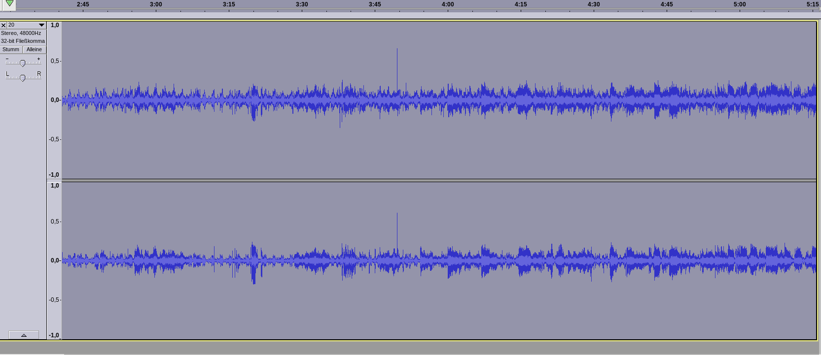

Put a normal record on and record the sound of the run off groove with Audacity for about a minuteEDIT: it is not only wandering quite a bit, it is at the same time high-pitched (around 3015 Hz instead of 3000Hz) (PLL-Lock LED is on)
R.
You should be able to see a ~1.8 second repeating glitch. Measure the time for ten rotations and calculate the actual true rpm

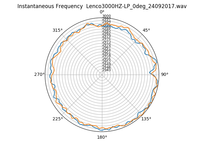

I have generated the two wav's with the test LP at 0 and 90 degrees clockwise, position pulse on the right channel - trust these are workable. A plot of one test is shown.
View attachment Lenco3000HZ-LP_0deg_24092017.zip
View attachment Lenco3000Hz-LP_90degcw_24092017.zip

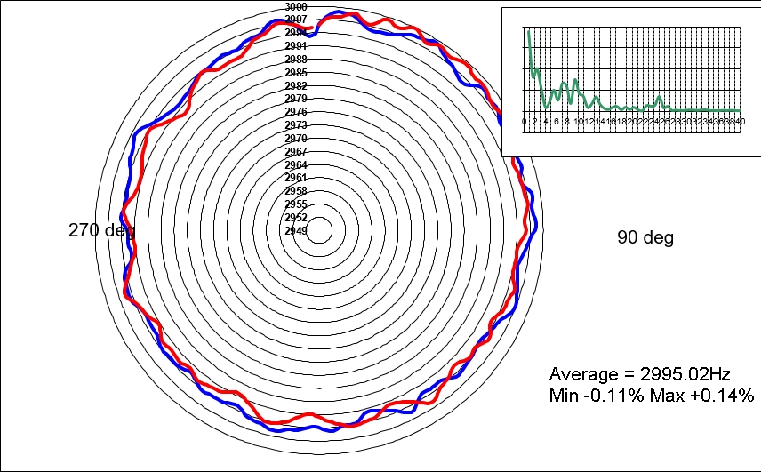

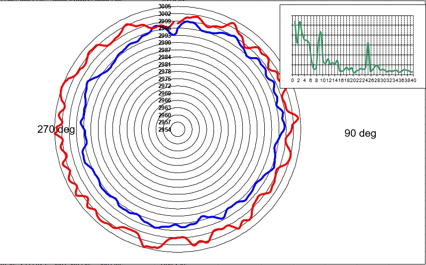

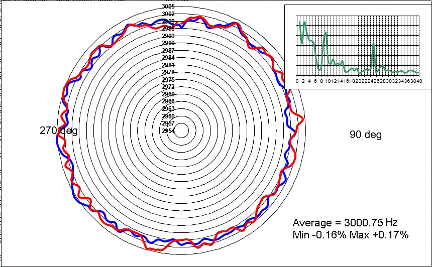

Here's polar plots for those files. 12 O'clock is the leading edge of the index pulse, blue and red 2 successive revolutions - except the 3rd plot has the 1st revolution from each file. I took the leading edge of 1st index pulse in the files as the start of data.
You'll see that several odd things appear to have happened: the 0 deg file speed is significantly slower than the 90 deg file, and the eccentricity has moved by nearer 180 deg than 90 deg.............
Otherwise, the spectrum looks very like a Lenco - that characteristic ~ 25Hz variation from the motor shaft. It looks quite healthy, though - I've seen far worse Lenco's by measurement, and I've never seen one without the ~25Hz content. I'd assume the ~9Hz content to be cart/arm resonance, but can't remember how many poles the Lenco motor has (4 I think?).
Any ideas what else might have happened between recording the 2 test files ?

Hm, I don't see such a thing as a 'repeating glitch' (and why should it be there, really?). Maybe you could give me hint what to look for?
1% accuracy -- good point. Would it also allow the FG to wander around? (I guess not, my ancient FG's at my workbench do not)
i don't believe the GT2000 is wrongly pitched -- too much to loose for suppossed japanese top-end gear. (People used to play along their musical instruments back in the day and a wrong pitch would be out of the question for a deck without manual pitch control. At least i hope so.)
... how to know vertical eccentricity of the platter ?
I'd say this would be instantaneously visible by the pure eye. In my case, you don't see the platter moving if its spinning. But I easily spot the movements of the cartridge riding the grooves.
In the circular it should model as an eccentric circle as well, shouldn't it?
Yes but there's a built in slight distortion in doing the polar projection with a purely linear radial dimension that makes it slightly elliptical. BTW I think the comment on the leadout groove was related to the fact that it is locked and usually there is a click where the stylus enters. You might have to listen and zoom in to find it. OTOH you could take a trash record and put a scratch on it, usually you can get a time measurement down to one sample period.
