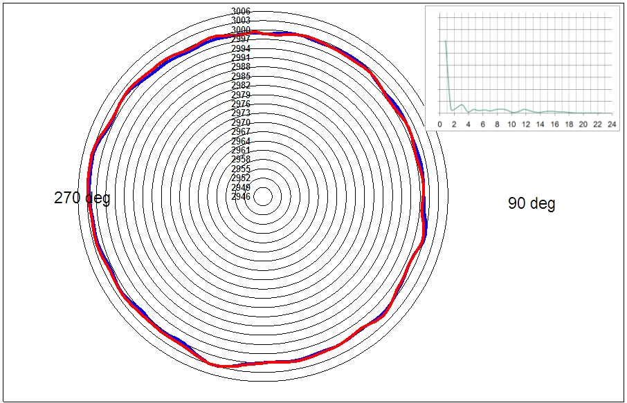

As Pano has said "wobble between 999-1003 Hz". How to interpret it in the polar plot ? The plot posted in #580 the green trace doesn't match at 0 degrees after one revolution. Does that mean wobble ? Sincere thanks for efforts done by everyone.
It matches very well and I can see 9 cycles of ripple on the circle. Two rotations will never exactly overlap as the test record is not perfect and external vibration is also getting involved
Not quite - two consecutive rotations won't exactly line up if the platter rotational period is not exactly the same as display rotational period. This cropped up earlier in discussion. For example, if the TT speed is slightly slow or fast.Two rotations will never exactly overlap as the test record is not perfect and external vibration is also getting involved
In my SW, I included a 'display nudge' function button which can manually align traces, to be used to fix this effect if necessary.

Yes, that is common enough, but IMO it's generally a fault/opportunity for improvement in the drive system.It matches very well and I can see 9 cycles of ripple on the circle.
It need not happen in belt drive TTs; here's one of my own belt drive TTs from the archive - it's my own build 2kg solid platter outside drive, RB250 arm with custom arm damping and OM40. The test record was 45rpm, FWIW.

Very nice and almost as good as the better DDs. I think Scott and myself may have off centre motor pulleys

Scaling to the mean frequency would fix that, IME the difference in mean between two revs is far less than even 1 degree in the plot. Even so 1% is only ~4 degrees on the plot.

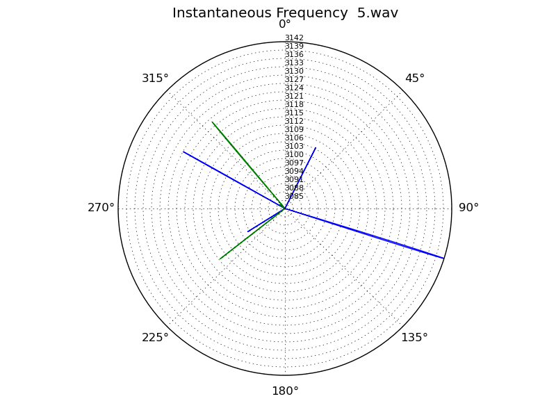

I have tried to give Scott's script proper surroundings, I think it should work. However, I do not get an meaningful output. (see picture).
Since I have reason to believe that something is wrong with my deck, it would be nice if someone could
1) process my file 5.wav (rename 5.zip to 5.wav) circularplotwise
2) help my to sort out why I don't get a nice circular plot?
I recorded it with sox (32/96), resampled it to 16/48, and cut out the relevant piece - a 3 Khz testtone - in audacity, and then - this.
