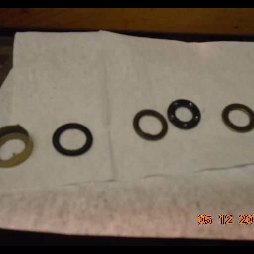

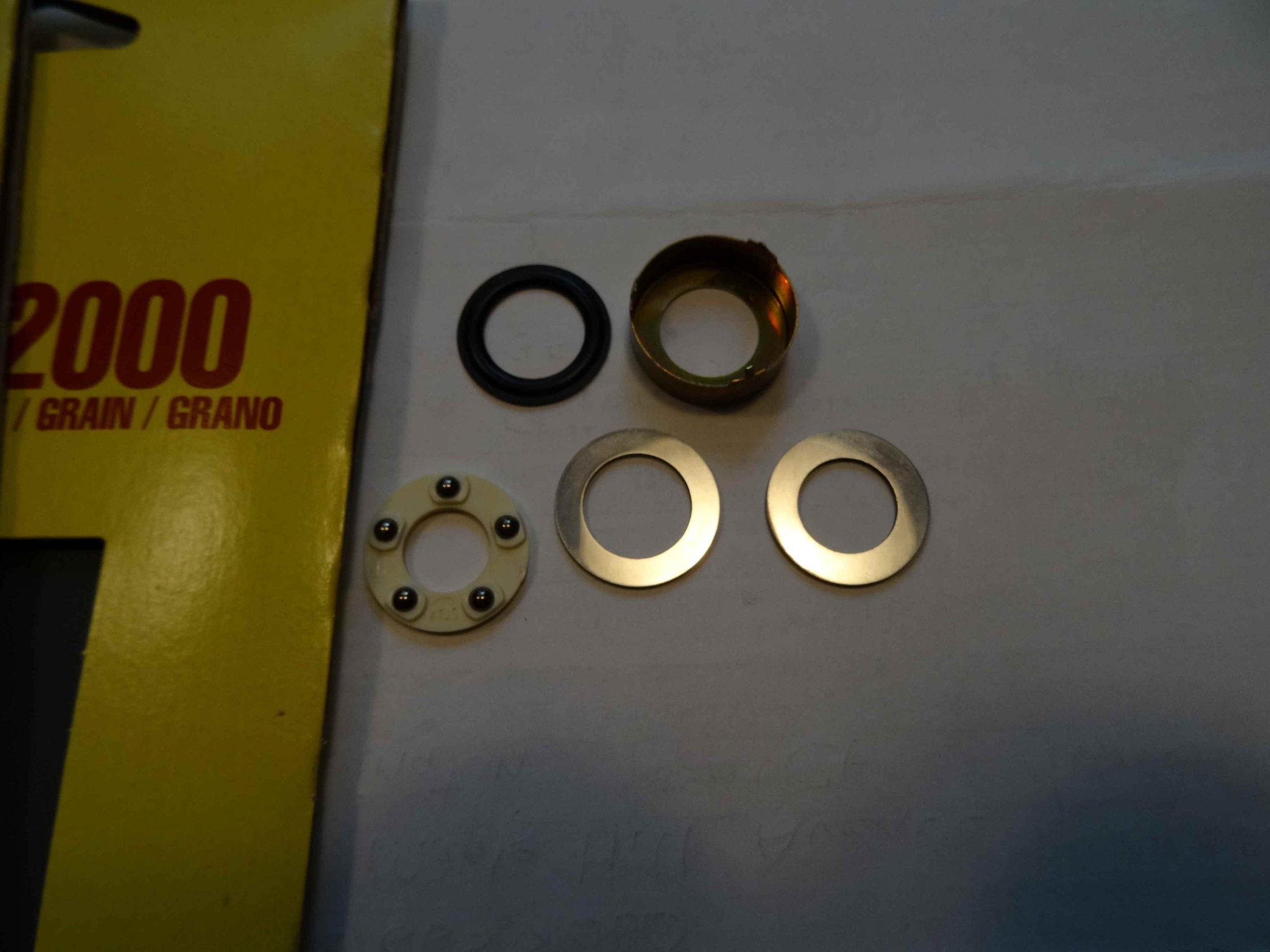

What lubricant should be used for this Dual 1249 spindle bearing?

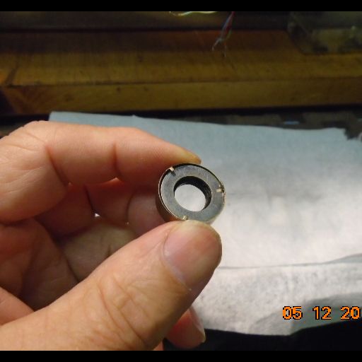

I removed the spindle ball bearing and took all parts out of the bearing case. I have a question regarding the rubber ring that sits on the bottom of the case. Should it be lubed so it doesn't dry out over time? The one I have is soft, supple and like new, and I want to keep it like that.
Thanks,
henrylr

I got the answer on the vinlyengine forum. It seems the primo place to find TT info.
The oil will eventually get on it anyway, so up to you. I have used Stihl chainsaw oil (made for the cutting chain and bar). Just let the plastic ring with the ball bearings sit in a little pool of the oil for a few minutes, then install and assemble the bearing.
