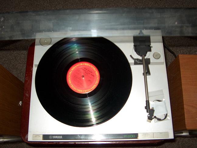

Don't spend a whole of money on a new cartridge for this thing and providing that the rest of your system is really up to snuff, and you like the sound of LPs you might consider an old Thorens or Rega for example. Old AR-XA are worth a look as well, and are very musical - they were the inspiration for an awful lot of today's high end suspended subchassis based tables. (I replaced a Mitsubishi DP-EC7 DD w/Ortofon LM20H with an AR-XA, the differences weren't subtle. I bought the XA nib for about $45 from a hobbyist, and this with another LM-20H I had on hand absolutely clobbered the nearly $400 Mitsubishi which was working properly. )
I know someone who trash picked an early Linn table, which is one of the most respected high end brands. (Which is way above the league of most consumer level Japanese tables.)
I own a 40yr old Thorens TD-125 (good recommendable table, not inexpensive to acquire however) and a ReVox G36 R2R. about 42 yrs old, both younger than me and a lot older than that Yamaha.
Check out the www.vinylengine.com - this is where you will find the most comprehensive resources relating to turntables. You will find all of the information you are seeking about the cartridge replacement there.

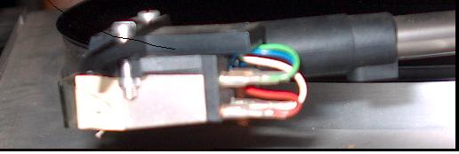

This table uses a conventional, not p mount type cartridge which is actually a good thing. Although p mounts (aka universal mounts with an adaptor) are still made the selection is limited and the quality is affected by the rigidity of the adaptor when used in a normal mounting scenario. P mounts were generally intended for very inexpensive TT so ultimate performance was rarely a concern.
Grado makes some good inexpensive conventional mount cartridges that are relatively non-fussy in use. I think the Grado Black MM at $60 would be a reasonable choice for this table. (Elusive Disc online) Shure, and Ortofon are other possibilities..
Online sources for cartridges here in the USA, Needle Doctor, Elusive Disc, and Acoustic Sounds.
Try to set it up yourself with additional guidance from here and vinylengine. Expertise in this area at a local high end store could be costly.

does anyone know a link or links to sites or resources that list which turntables are compatible with which cart / stylus? like a table that says ABC turntable can accept DEF,GHI and XYZ cartridges or something like that?
in other words, how do you guys know which carts and stylus will fit which turntable?

I'm no expert, but it isn't a matter of compatibility. Just about any cartridge will work with your turntable, but it's just a matter of how good the cart you pick will match with your turntable's tone-arm. Also how much were you looking to spend on a new cartridge? You can buy a budget cart for like $30.00 plus shipping, but you must remember you get what you pay for. If you throw out a price range I'm sure you'll get suggestions.
Also, just to point out I think what previous posters were trying to point out is that you could most likely upgrade your turntable for the same price as a decent cartridge. I just picked up an AR XB for $68.00 plus the cost of shipping off ebay! Here, this turntable would even be an upgrade for you. From the looks of it the weak point on your turntable is the tone-arm. But hey, you're still better off than I was when I got discovered my love for vinyl records! My first, and only turntable until I get my AR XB in the mail, is a Technics SL-1500. It will hold time maybe fifty percent of the time, the other fifty percent it speeds up and slows down so bad I can't listen to it. It's a real shame I couldn't solve the mystery problem, I this it looks pretty slick...

yeah looking at some of the prices for carts makes me think the same as you, that perhaps replacement is a better option.
but, i want the experience. always loved fixing things. so here is what i plan to do, anyone please feel free to comment or add/remove.
1. order cart ~$30 with the conventional four wire mount.
2. on TT, undo four little wires to cart and remove, noting where they go.
3. undo two small screws at front of tonearm that hold cart in. remove old cart.
4. insert new cart, re install mounting screws.
5. plug four small wires back in their respective positions on back of cart.
6. pick out a crappy record and play it a few dozen times. if it doesn't mess up the record and sounds nice, start playing good records with it.
what do y'alls think of my plan? i know im probably missing a few steps here?

Gain, you will probably get more useful answers from more people on the vinylengine site linked to you earlier in this thread. It has a great turntable and tonearm section where you will get lots of answers for cartridge recommendations and turntable recommendations.
The diyaudio.com analog forum is really more oriented to turntable design/engineering, as opposed to product recommendations....

I have a Yamaha P-05. Looks very similar to what you have. It is 80's. Doesn't matter early, late, or mid 80's. It's a decently built "consumer" grade TT.
Analog SA is not far off the mark to say it was not high end, and is not worth a lot now. It is a very usable turntable though if you're not looking for the last word in sound quality. ("High end" can be a bit subjective ;-)
I paid $25 or so for mine in the mid 90's. I put a new belt on it, and bought a "low end" Grado cartridge for it. the Grado was something like $60 or so at a hifi shop in southern California - I was in college at the time myself so even that was pushing it. It's easy to install, and worked well after I corrected a phase reversal mistake I made in the wiring ;-)
The turntable has a basic "cheap" or rather not extremely accurate method for setting tracking force via a dial at the back of the tonearm, and it has the anti-skating knob which adjusts a small amount of spring pressure to keep the arm from sliding or "skating" off the record due to natural tracking forces or some such.
I have the manual as well (for the P-05). If it really helps I may be able to scan the main pages of interest and send them to you. Let me know if you would like this (it's not the same exact TT but apparently close)
It sounds OK, good even, not super, and will certainly work just fine until you decide if it is worth it to buy a better 'table. I've always planned to, but for now this one is even packed away anyway until I can find a safe place from my 17month old daughter to keep it in operation ;-)
hope this helps...

gain said:yeah looking at some of the prices for carts makes me think the same as you, that perhaps replacement is a better option.
5.5. Set tracking force
6.5. set anti-skate (you can probably leave this at just above 0 to start). If horribly off it will distort the left-right balance as the cartridge will be pushing harder to one side or the other of the groove.
otherwise, that's about it. A test record might help to check everything if you can get a hold of one, but it's not necessary. You'll hear it if anything is way off...
-CK
