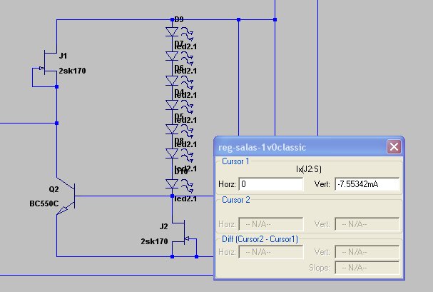

R9=27r would be OK, its just a base stopper, not particularly necessary in non problematic layouts with not enough nH to base though. Gate Zeners should be 2 back to back so to be complete, but never failed without yet.

The 317 is a prereg. Basically you need to allow 5V for it and then another 5V at least for the next reg down to most DC motor requirement. The Mosfet across output will not allow under 4V to motor, in some situations less is needed, then you got to use an MJE350 with a 47R base stopper instead of the 220R. Will go lower then. 500R trimpot is for 5-6V range. 3.3k would drop for 16-20V for instance with adequate input voltage of course.

If R9 is missing, the Vds for Q5 is clamped at 0.7V or so, and Q5 will never go into pinch off, and so never act as a constant current diode. With R9 missing, no need for Q5, it can just be a resistor instead.
It has been working without a BC550 base stopper many times before. 0.7V across a 2SK170BL is more than double its -0.5V pinch off average. Double Vp rule of thumb for idss mode is fulfilled.

Zd2 should look down. Those motor caps may create reg oscillation. Try with and without.

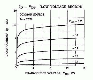

So what is this graph telling us?

I don't agree with them. But Salas says we should ignore the behaviour of their devices as published by Toshiba. You can but try.
Go on as you like but whatever has more than double its pinch off across it can give steady IDSS. Research better.
