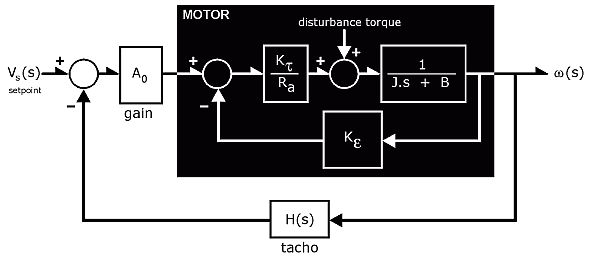

This is the basic block diagram arrangement of a 'DC Servo' motor control system. The black block is the motor itself. (This is NOT a quartz PLL type)
To clarify my earlier post, if you considered ONLY the motor, the speed would be very largely determined by the voltage applied to the motor - my suggestion to use an LM317 regulator to generate this voltage. Others then suggested shunt regulators, PWM control, etc. which are improvements, but with the cost of added complexity and design work.
Then the topic of servo/tacho control came up: *IF* you go for a closed loop servo control, the 'quality' of the circuit driving the motor (the controllable voltage source, Ao) becomes way less important, because the feedback loop linearises the entire subsystem comprising the voltage source Ao, and the motor itself. Also, the closed-loop control system is much less sensitive to noise & disturbances in the power supply voltage. The setpoint voltage however, must be extremely accurate and stable.
In practice, a simple proportional controller as shown doesnt give the best results: proportional control alone can never drive the steady-state speed error to zero. So the 'gain' block is enhanced by additional components, in the guise of a lag compensator, or integral controller. Scary as their names make them sound, they are in reality just specially designed filters, consisting of resistors, capacitors and maybe an op-amp.

The LM317 is cheap (50c) and easy to do, requiring little design, and should work well, although not spectacularly. Exactly that setup has been used in many, many belt drive TTs.
I suggest trying it. If it doesn't give you good results, you've wasted only a little time & money, and lost nothing.
The closed loop requires getting into some quite tricky mathematics - IF you plan on designing it fully from the ground up. There is the chance of doing a bit of trial and error 'design' and getting working results.
This last idea/concept/diagram is what I had originally envisioned (more or less) but sounds like it will require the very well regulated power supply anyway, which sounds to me like additional complexity.
Exactly the opposite. The closed loop feedback regulates the motor despite noise & fluctuations in the power supply. So you can get away with a very mediocre power supply.
All you need is a stable voltage reference - and that can be had from a Zener diode + an ordinary diode.

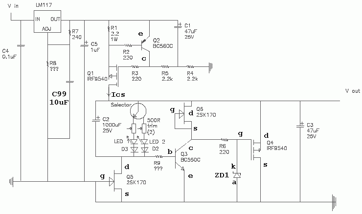

OK. Bear with me and my ignorance here... I have speced a 24V motor. I can change it to 12V if it makes life easier, but thought having the 'headroom' of the 24V motor was wise. RPM of the motor is the same at full voltage, so calculations of voltage needed will be the same.
So, looking at the two earlier schematics, I have determined what I (think) I need for output voltage, and have some concerns, because the input of the LM117 is ~28V and the input to the second circuit is listed as 12V, and therefore I have to assume the output of this second circuit will be lower than 12V (or, at most, equal to 12).
Here's the rub:
To get my platen to spin at 45 RPM I need 18.947 volts (in theory- probably a touch more to overcome frictional losses)
And, for 33.333 RPM I need 14.035 volts (again in theory- probably a touch more to overcome frictional losses)
So, the question is, can I up the input voltage (and output voltage) of the LM117 to get a higher output voltage? (I assume I can increase to get 20V output but wanted to verify).
And the second question: Can I replace the 12V input of the second circuit with the 20V output (or more) of the LM117 circuit to have ~19V available at the output of the second circuit? should I have a bit more headroom on the input voltage? (more of a difference between input and output voltage)
I will draw this up in CAD; however before I get too deep into the design, I want to make sure it will operate reliably without releasing the factory installed smoke...😱

The basicc layout looks OK. Have you done any calculations for those component values? Or were they just lifted off other examples?
Lifted directly from the earlier suggestions in this post (I stuck two ideas together to get this abomination).
So to answer the question directly: I have no idea if any of those components are correct. For sure the value with the ?? is needed; however the others could be way out too, as the voltage needed is higher for my 24V motor (estimated voltages are listed in an earlier post by me).

There is a resistor missing from the base pin of Q3, to the cathodes of the LEDs. Without it, Q5 can never recive enough voltage to go into its pinch-off region, and hence just acts like an ordinary resistor, not a current limiter.
And you should probably add a Zener diode from the source to the gate of Q4 (cathode end to the gate), if the supply voltage is anything over 20V to protect the mosfet from destruction if there is a fault condition.
You could probably get better regulation (if running at 24V) by adding extra diodes in series with the "selector" switch - to increase the voltage drop at that point.

Resistor R9 and extra voltage drop diodes D2 and D3 correct!
Not that it matters with the cost of diodes, but you could use a single diode in place of D2 & D3 by putting it on the other side of the selector. Depending on the voltage drop required, D2/D3 may turn out to be several diodes in series, or even an additional LED (which isn't for its light, but rather for its typically large voltage drop characteristic)
Zener diode ZD1 as shown on my ammendment, this should be about a 12V to 15V, half-Watt zener. It there to save the Mosfet, which can't tolerate more than about 18V between its gate and source pins - if a fault condition develops elsewhere.
R9 value - I'll have to look at the JFET data sheet again to figure that out. I'll dig it out tomorrow.
Have you decided on the 24V motor or the 12V ?
Ics (current source) is set at 300mA, by the value of R1. This is the maximum current this power supply can ever deliver, so that value you may want to adjust according to the motor data or your own motor measurements. Limiting this value will make the motor have a longer run-up time from standstill. Increasing the value of Ics will generate more heat in Q4, which will have to be fitted with a heatsink anyway.
Q1 and the LM117 will also need heatsinks.
