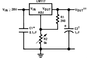

For best load regulation, you'd want the motor to be driven from a low impedance voltage source. Thus putting resistors or trimpots in the motor's power line isn't a great way to do it.
Far better is to drive the motor directly from the output of an adjstable voltage regulator, such as the LM317, and use your speed switch to select either one of two trimpots that adjust the regulators output.
The downloadable datasheet for the LM317 has the design equation to get the right resistance value for any voltage, but the basic layout is shown in the attached pic. Setting R2 to a short circuit will bring the output to 1.2V, i.e., effectively switch off the motor.

This looks quite simple to me. Basically, I would replace the pot shown in the picture with a selector switch with the appropriate resistor (and trim pot) to get the speed just right for each selection, right?
And, for off, I'd just cut input power (28V in) rather than keep the chip hot, or is the chip most stable if kept hot?
Finally, would there be any benefit to larger capacitors? Either on the 28V in or within the circuit itself to help 'smooth' the power delivery?
Exactly so.
I have seen several commercial products that power off just by turning the regulators down to 1V, and work like that quite happily for decades.
But either method works - up to you.
Reglators don't always like seeing a huge capacitor on their outputs. A capacitor directly at the motor may be benefical - probaly something around 47uF in parallel with 0.05uF. But that does depend on the motor characteristics itself.
The size of capacitor on the unregulated side of the regulator - that depends on your primary DC source. If it's just a basic transformer and rectifier, a big capacitor is good (say 1000uF to 2200uF), but if it is a good quality lab or test bench supply for instance, a capacotor here (other than the one shown in the 317 application note) is rather pointless.
The 317 will need a heatsink, and it must be insulated from the heatsink with a TO-220 mica washer & plastic bush, since the 317's mounting tab is electrically connected to the centre pin.

This is interesting. If the heat sink I attach is not in contact with any other metal parts is that OK? I assume so... (again clarifying)
By the way, thanks for taking the time to hold my hand through this! I know it is not difficult; however I do not have the background you and others here have, and I truly appreciate the assistance!😀
I will use what I have to supply it; I don't have a 'lab' power supply. A couple large caps is not terribly expensive. I don't need the best money can buy for that task... Would I put one across the + and - rails? (I assume so, but just clarifying)
Yes, directly across the + & - comming out of the power supply. Pay attention to the voltage rating of the cap (must exceed the power supply voltage, not match it) and the polarity (+ & -). Getting either of those wrong will case the cap to burst or occasionally explode.
If the heatsink is isolated, all will be well with no insulating washer.
BUT I always use washers anyway since a large slab of heatsink is SO easy to accidentally short to ground with tools when working on the circuitry.

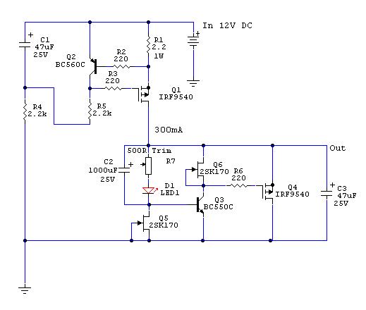

Now, what was this last schematic posted???
Clicked the link and think I have it...
Basically this goes on the output of the 'basic' voltage regulator posted earlier, right?
Make a question to Salas for the output voltage tha needs your motor.
In addition with two trimpots R7 and a switch you can have the 33 and 45rpm.
Yes a basic circuit with lm317 regulator is the power supply!
