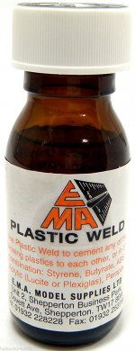

You need a solvent based adhesive which actually melts the perspex and welds the broken parts together.
Such an adhesive has a liquid consistency. An example is shown in the attachment.
Having said that, the break is in in an area subject to stress and there's no guarantee that the weld would be srong enough.

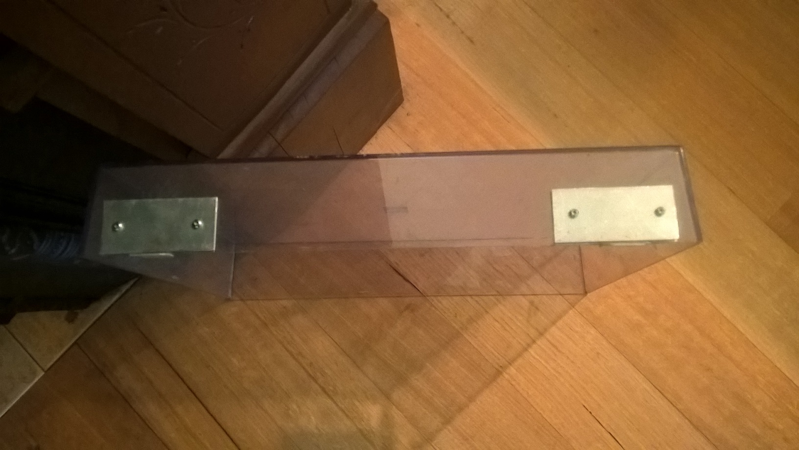

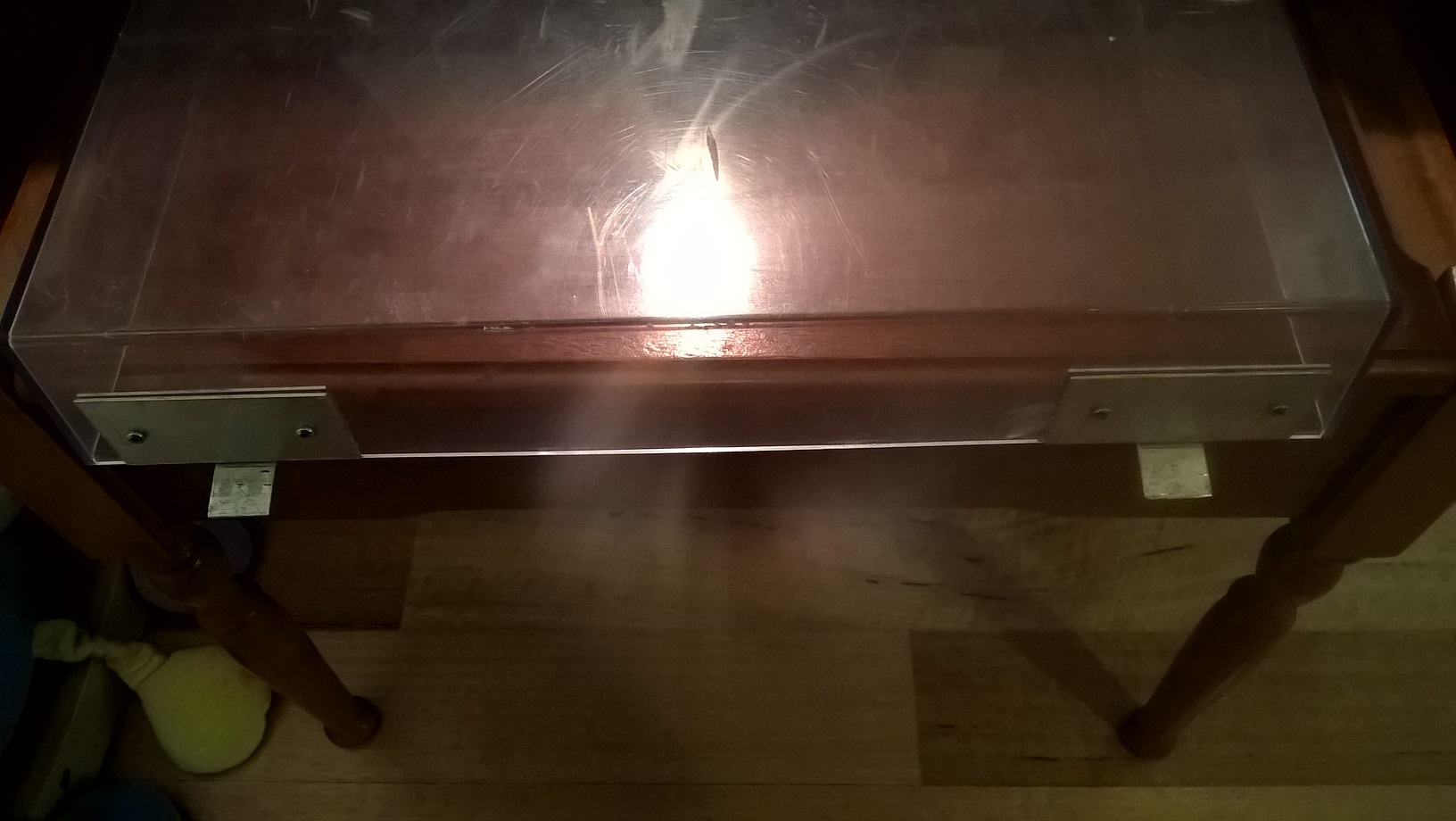

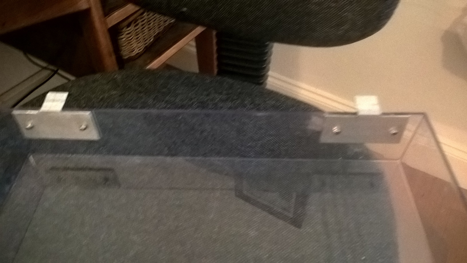

Here's what I did when my Technics TT lid develop the same issue:
shaved off he remaining plastic bits, used leftover pieces of aluminium to shape it exactly like the original bits and secured them through the lid with SS bolts with captive nuts.
The photos are a bit blurry but you'll get the idea.

I'm with wiseoldtech on this one.
SEE?
They look fine!
I've even went fully across the rear of the lid with aluminum channel, with tabs like you have.
