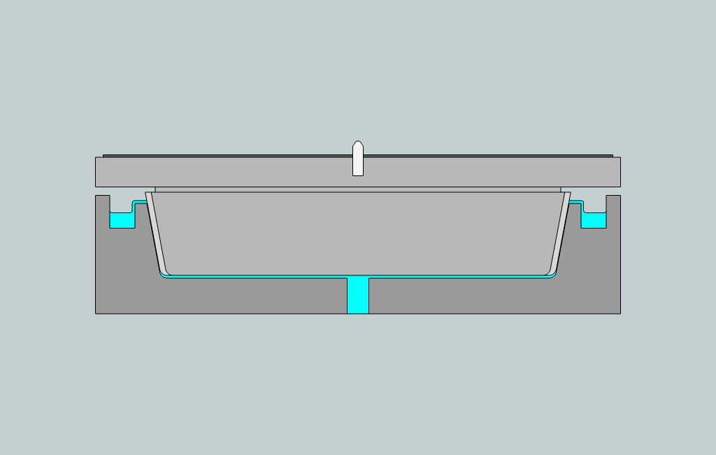

I've been reading this thread, as well as the "Good Turntable" thread with interest, mostly from a theoretical perspective because I have no plans to build a TT at this time (perhaps after I retire, i.e.: a long time from now). I've had an idea for a floating TT for a while, which is supremely simple in theory but probably unworkable in practice, which is probably why I've never seen it before. Or it could be I've just not looked hard enough; I'll admit I don't have much time nor inclination to conduct research.
Anyway, let me float the idea (pun intended) and allow y'all to either trash it or hash it out and perhaps prove it feasible:
Imagine a platter of relatively dense material, ~12" diameter x ~2" thick (any numbers I throw out are at best wild guesses, except perhaps for the ~12" diameter). The sides of the platter are tapered, perhaps 5°, creating an inverted truncated cone. Around the edge of the platter are helical grooves. This platter nestles into a basin that is the negative to the platter.
Fluid of a viscosity somewhere between water and honey is pumped through a hole or holes in the bottom of the basin. Hydraulic pressure raises the platter some small distance, and the fluid flows up around the edge of the platter, engaging the grooves thus causing the platter to rotate. The outflow is collected by a moat around the basin and is channeled back into a fluid reservoir to be recirculated.
Doesn't get much more simple than that: one moving part, no bearings, completely isolated platter.
Speed is set by the geometry of the platter & grooves, with fine adjustment by changing the pressure/velocity of the fluid.
One potentially major obstacle would be wobble/oscillation of the platter. Perhaps this could be overcome with very high machining tolerances, sufficient platter weight, and the right fluid viscosity. It might also be necessary to round over the bottom edge of the platter for a smoother flow of the fluid. But now we're getting into the nitty-gritty that I can't be bothered with :D. I'll leave it to the engineers among you to work out the details...
PS: If you know of any such beast in existence, please post a link.

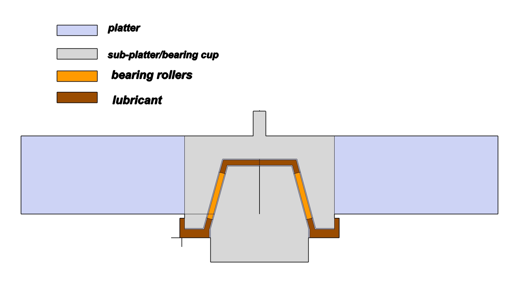

Rather than floating a large Reese's "cup" shaped platter in a well of fluid (shaped as a negative of the cup shaped platter) there are some existing tapered ball bearings that could be used. They come with both a cup and cone and tapered roller needle bearing. I've previously considered trying these as a regular main platter bearing in a turntable, where the taper can be used to self centre.
Following similar lines of thought, the same basic thing could be used to create a magnetic bearing with no contact between the cup and cone. Some experimentation would be needed regarding magnetic strength required to support whatever mass of the platter. The problems concerning the rigidity of the cart/arm/platter/sub-chassis/chassis will remain the same, but the bearing noise could be greatly reduced. Or even submersing the actual bearings in fluid may be enough to damp some noise out of the bearing itself.

Stew- The tapered needle bearing sounds like a good idea... I'd imagine it could support a quite heavy platter. However, it seems like all those needle bearings could be noisy.

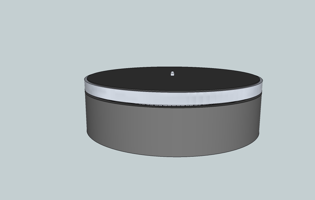

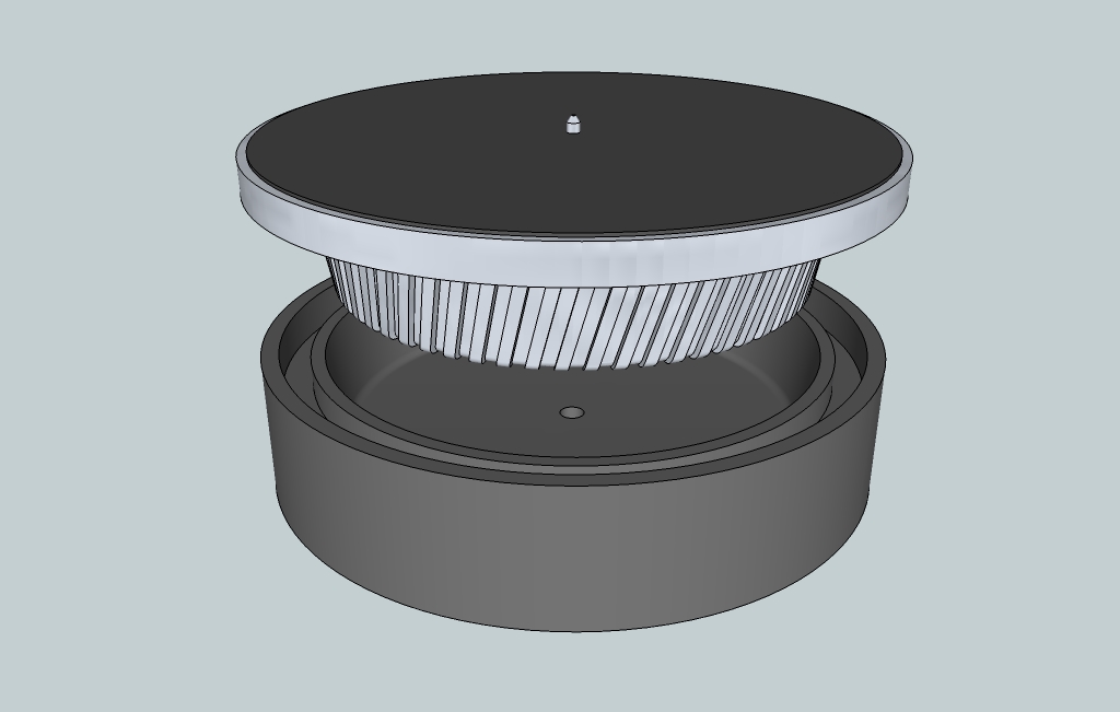

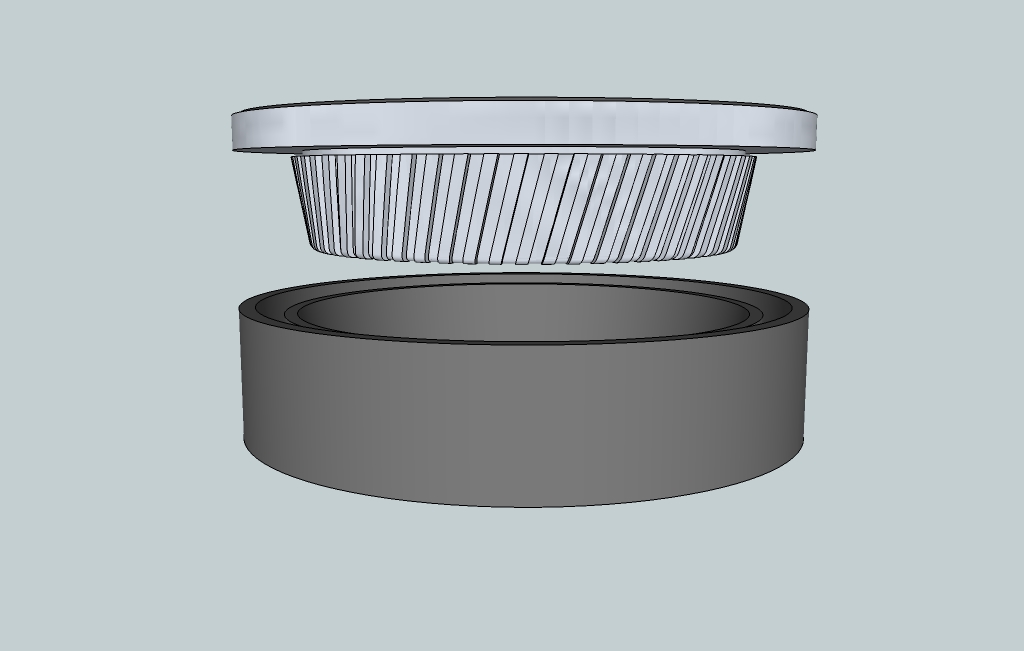

I whipped up a sketchup model of my idea; see the pics. It is essentially a tapered helical gear. My model differs from my earlier description in that there is a demarcation between the "gear" and the platter. The platter and gear could be one machined piece, or they could be an assembly made of two or more pieces.
Again, I know little or nothing about TT design, and this idea obviously bucks the conventional wisdom. I'm just putting it out there as a bit of new thinking (I think), to see if anyone can think of a reason why it wouldn't work.
Forget rolling bearing elements of any kind. Wat to noisy. That's why engineers went to the single spindle on a pad bearing surrounded by a plain bearing sleeve. Look to ultra high precision grinding spindle bearing design to guide you to a good bearing. Think hydrodynamic bearing design. Your car engine is full of them.
BillWojo
Forget the needle bearings...
Guy's. I was forgetting the needle bearings, please read the post (else I forgot to finish my thoughts before I posted). Use the "cup" and the "cone" as a basis of a mag-lev bearing. Don't use the rollers, but use permanent magnets instead. The magnets would have to be substantially stronger, and location (and orientation) would require some experimentation or really good software that could model B fields accurately and the resulting repulsion force...and of course some machining skill would be required.
