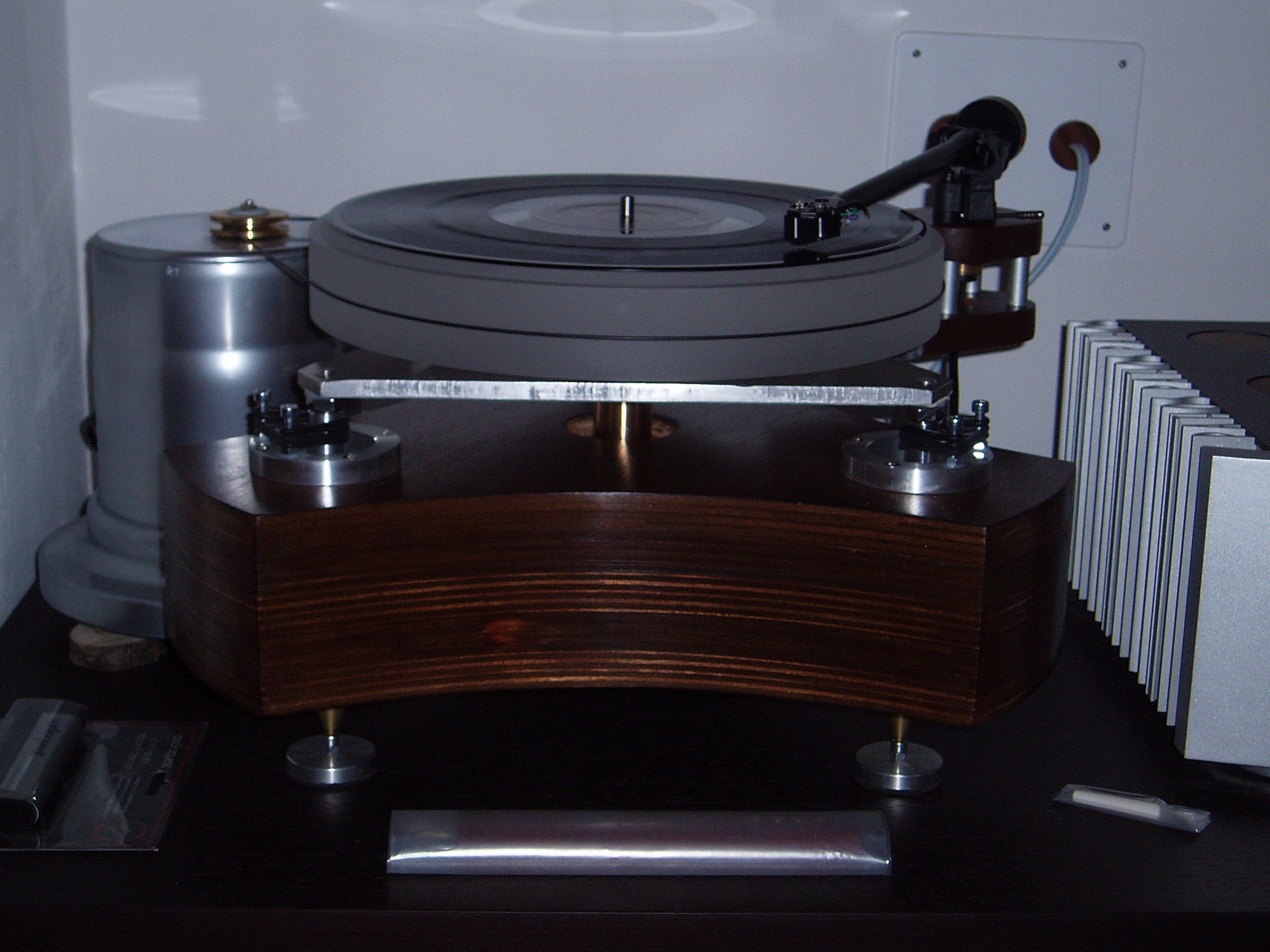

Hi Frank,
A couple of years ago I made my DIY turntable . Actually is not all DIY, The arm is a Rega 250 upgraded in the stub and counter weight only so far, Platter from Scheu in Acrylic , almost 5 Kg.
The rest was ..........about my idea and i used a floating sub platter frame , it floats with magnetic levitation. I think this sistem is good , simple and works well. A not too soft or not to stiff suspension.
I attach a picture of it ( not so recent pic, some other tweaks were done on the TT ) .
The magnetic suspension is easy , enable the level adjustment of the platter, the only trouble i had is that i have to replace the centering OR once per year in summer since the OR rubber deteriorate, till they break. In any case they have a low replacement cost , just few Eur. For the motor i used a 5" Floppy disk and a PC 650 Watt feeder, all separate from the Turntable, but inside the round silver Steel case ( quite heavy case with good rubber feet) . The motor is silent and has torque as well. Since i play only LP a fixed bronze pulley does the job.
The plinth is made with 5 layers of marine plywood , inside there are 7 Kg of glued leads. Decoupled spikes by OR and so on...
However my next Turntable project shall be a bit different . Platter made of aluminum and not less than 12 Kg, Bearing with magnetic levitation to reduce the spindle noise, spindle oil lubricated .Arm frame separated from the platter frame, DIY arm 10 " or 12" Unipivot or Shroeder alike , 2 Floppy disk motors with Fly wheel for better speed stability .

My bearing has a very tight allowance so the only way to fill the bearing with oilit is to open the bottom part ( that can be removed ) insert the spindle for just 1 mm fiil the bearing with oil , push up the spindle almost to the end, close the bottom part not completely tight allowing the exceeding oil to leak out while you push all the way down the spindle, tight the bottom part to avoid oil leakage. In this way you are sure the oil is there as it is supposed to be even with the tightest spindle/ bearing allowance like mine .

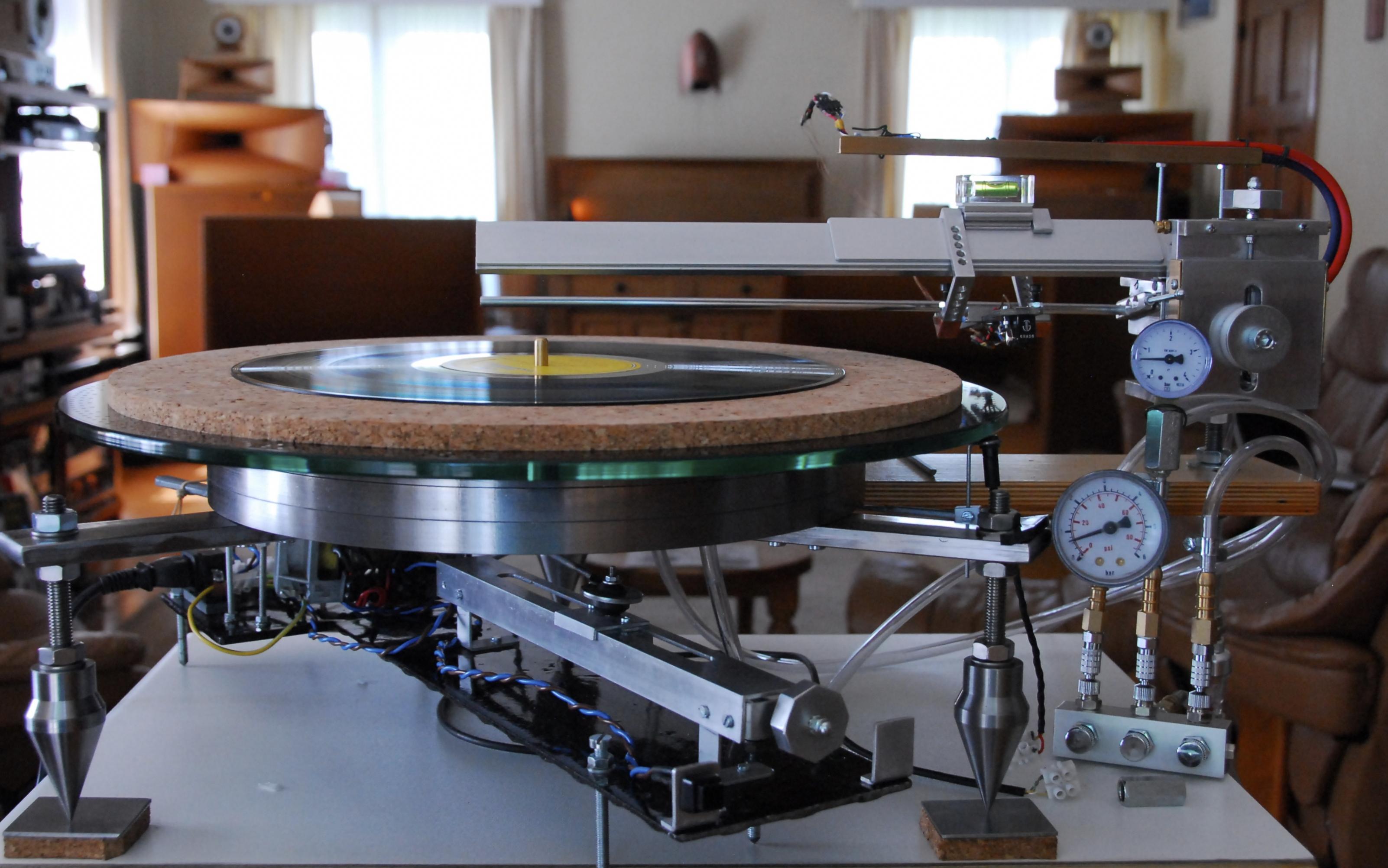

air bearing TT & TA
FYI.
... meanwhile, this is my (DIY) home made concept : air bearing 16" TT & TA
More info:
AIR BEARING 16" TT & TA - Vinyl Engine

the problem with decoupled components like air bearing platters and arms is that there is no where to sink resonant energy it becomes captive within the component. that being the case one would want to build in a lot of loss.
Not really. Depends of the amount of air pressure though.

Who came up with the myth of 'sinking' noise. What you need between platter and earth is mechanical filter that blocks the incoming sources of noise. Isolate the motor and forget about it.
