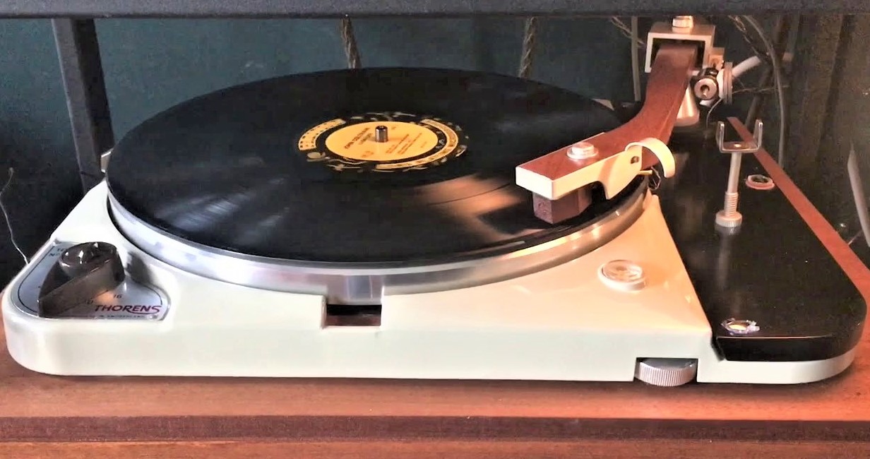

Well Chris, apparently back in the early 1960's, those Grado Laboratory Series arms were popular for the TD 124.A wooden arm? Well, as long as the customer likes it I guess. I'd rather have a stable structure and controlled resonances. Wood never really stops moving and is a natural substance (= variability). Seems to me it would be more expensive to manufacture a great wood arm than composite or metallic arms.
-Chris
Originally sold for about $49.50, they're now going for $500 and more..... amazing.
They're made of gunstock walnut, and the ones on my bench are in impeccable shape - like new.
No warping, virtually no friction, simple, and discussions on the 'net talk about the lack of resonances.
The horizontal movement is dependent on a single polished and pointed rod, a sort of uni-pivot design.
The original wiring is 4 hair-thin leads bound in a braided shield - extremely flexible and delicate.
While it's got no anti-skating, it does have a lateral balance adjustment and depends on perfect leveling of the plinth.
That last pristine on TD 124 that was on my bench had a vintage Grado F1 cartridge, and ideally set for 1.8 grams.
What got my attention was when finally running my test records on the TT, that Grado cartridge stunned me with its performance.
Things I never noticed before were the clarity and nuances that stood out.
It takes a lot for me to be impressed, and I was.
The TD 124? - no rumble, if any, was below the disk's surface noise, and for something made in 1964-ish, impressive.
Rock steady speed of course from a 11 1/2 pound platter and hybrid (belt/idler) drive.
The thing's a tank!
This is the combo - a photo of one I plucked off the internet.

Hi W.O.T.,
They did many things in the 50's that didn't hold up technically. Today a tonearm would be lower mass, stiffer and better controlled dimensionally and resonance-wise if made with a composite or metallic material. Cheaper to make as well.
Nice looking table, but my cartridges would not survive on that tonearm! Yes, the bearings were fabulous on the 124. I have worked on more than one or two. I don't own one though, I own a TD-125 MKII (rebuilt) and a TD-126 MKII (rebuilt). The 126 is the better table with a very low mass arm. The automatic functions are really wonderful. Look up the TD-1601. I really want one!

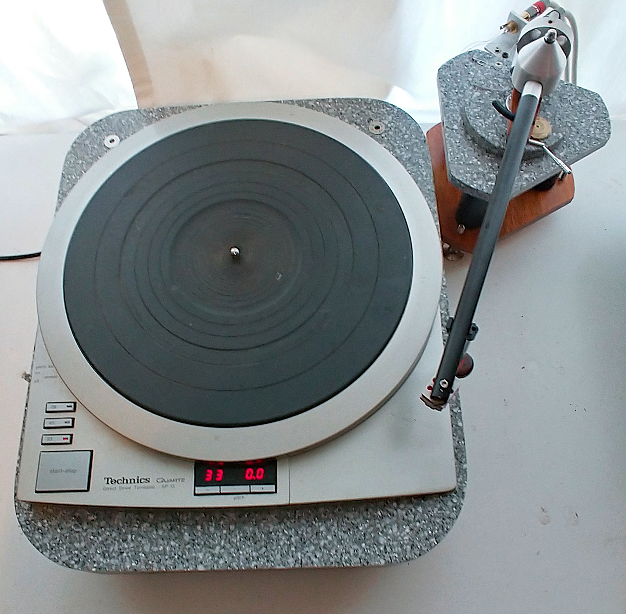

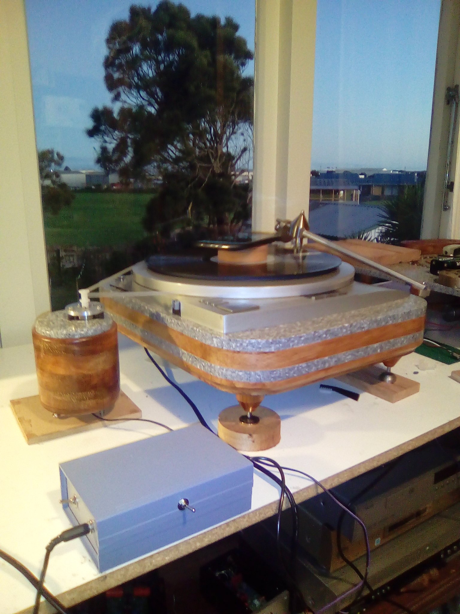

Hi It the arm that is the most important item on a T/T, So go for the unit with the best arm or buy a unit with out an arm like a Technics SP15.
Then if the DD motor fails you can turn it into an outstanding Mylar belt driven DC motor T/T. Like I did with mine, Arm is a 12'' Temaad kit arm, later I intend to upgrade the arm tube to Magnesium.
Cheers
