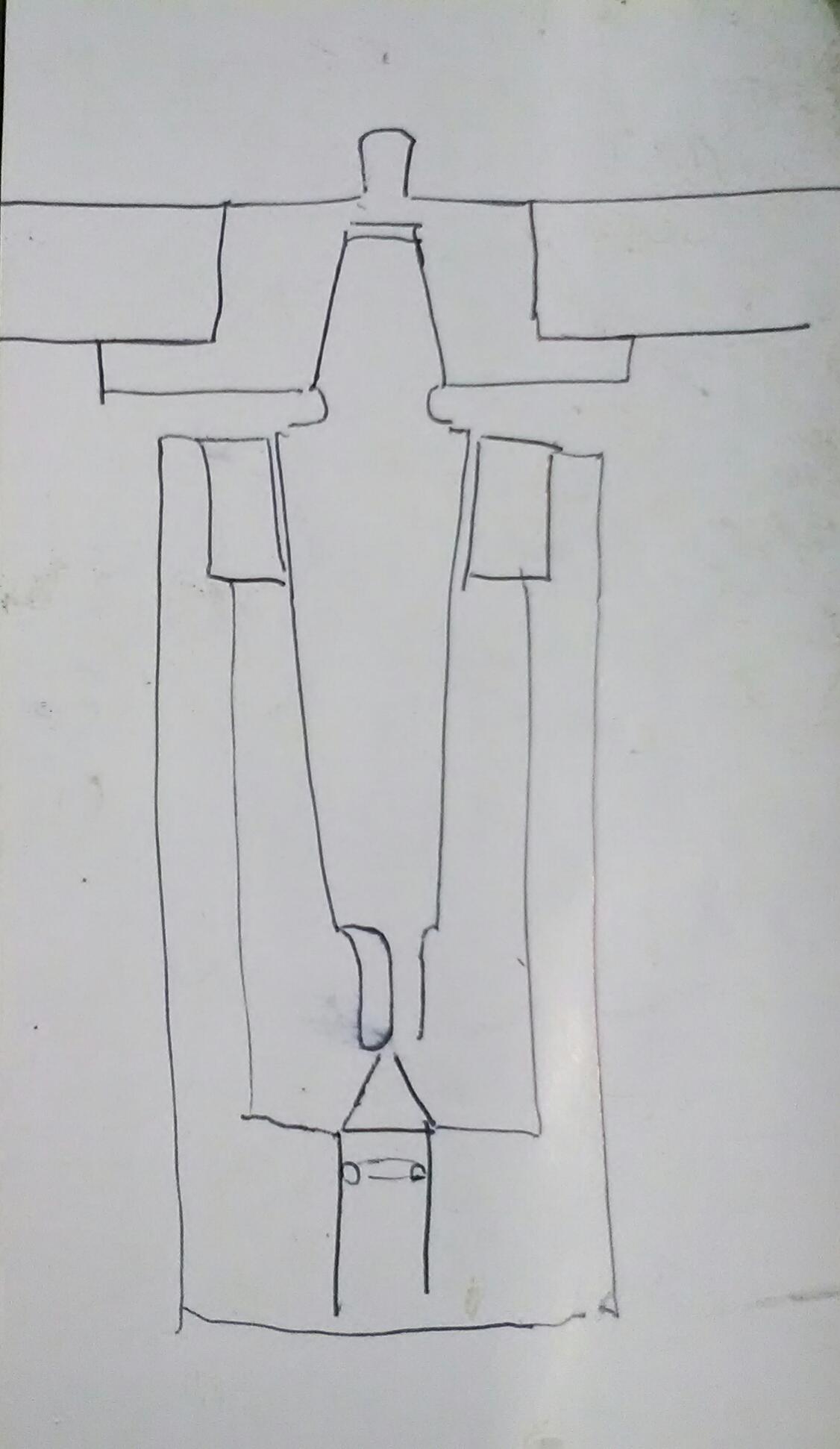

If I was going to make a decent deck, I'd use a 3mt to a jacobs taper arbor or the spindle , they're cheap and precision made and should be available for many years to come should a replacement be required. I'd use the 3 morse taper for the bearing surface ( with a center for the thrust and to adjust clearance ) and the Jacobs taper to locate the sub plater. I don't like the thought of the flywheel effect of a motor coupled to the flywheel effect of the platter by a rubber belt, I'll agree that I think of a magnetic field as springy, but clever people can do clever things with motors.
Both tapers are locking tapers, that's why you can use them on a drill, mill or lathe.

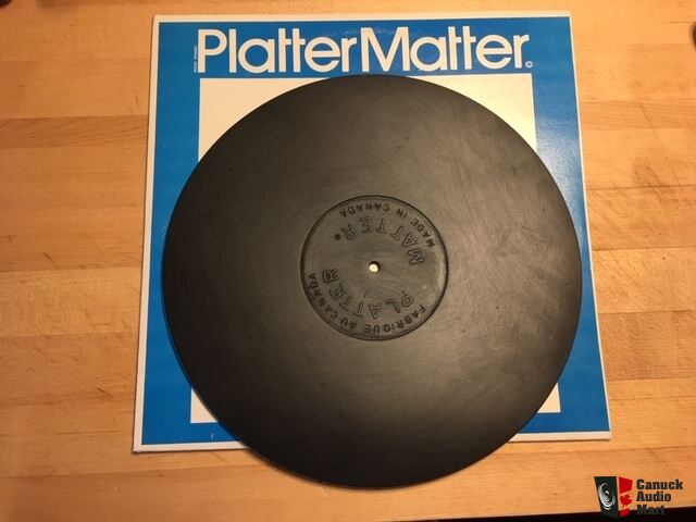

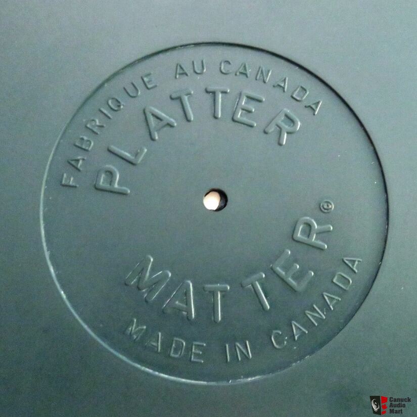

Interesting observations. According my experiences a similar rubber mat (no name) provide best results - if the mat, that you mean is according those from the attachments.The mat. Critical, it absorbs vibrations in the record, and it (if tacky) keeps the record from slipping while also damping acoustic vibrations. The very best mat I ever found was a "Platter Matter" and I would buy a new one if they recreated them. I use a Mike's mat now, the closest thing and it performs much better than other types of mat. Another note. A tacky mat has zero effect on bass. It cleans everything up immensely as you might expect. To reduce bass, you would have to reduce the amount of motion in the stylus, and that isn't physically possible folks. If anything, a tacky mat increases stylus motion to the modulated groove for the intended signal (again, not a surprise). It forces the record to remain motionless with respect to the platter. This is exactly what you want.
-Chris
The term "Mikes's Mat" don't provide results.
Interesting to know concerning sound character would be this mat:
https://www.hifi4sale.net/t55695-sph-stainless-steel-mat-on-my-lenco-l78
1282665-4d02e4a2-original-platter-matter-turntable-mat-made-in-canada.jpg73.9 KB · Views: 324
1282668-633f2fba-original-platter-matter-turntable-mat-made-in-canada.jpg108.2 KB · Views: 83
1282666-9ada1b4f-original-platter-matter-turntable-mat-made-in-canada.jpg125.6 KB · Views: 80

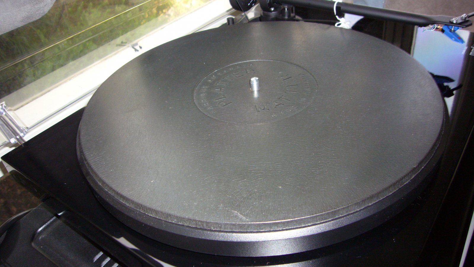

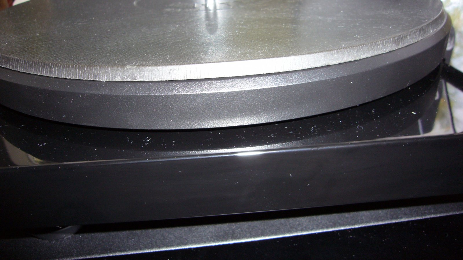

The one i have on my Rega. Also a light weight Corian platter.
Chris and i have had discussions on TTs, and he & i don’t see eye to eye. If i had the cash to afford the TT i’d like is the Rega 10. Greta efforts to reduce the mass of everything.
He would be appauled at teh (literally) 100s of TP16s we tossed n the trash.

We do agree on the Platter Matter though! How do you get the sticky back? I still have two.
