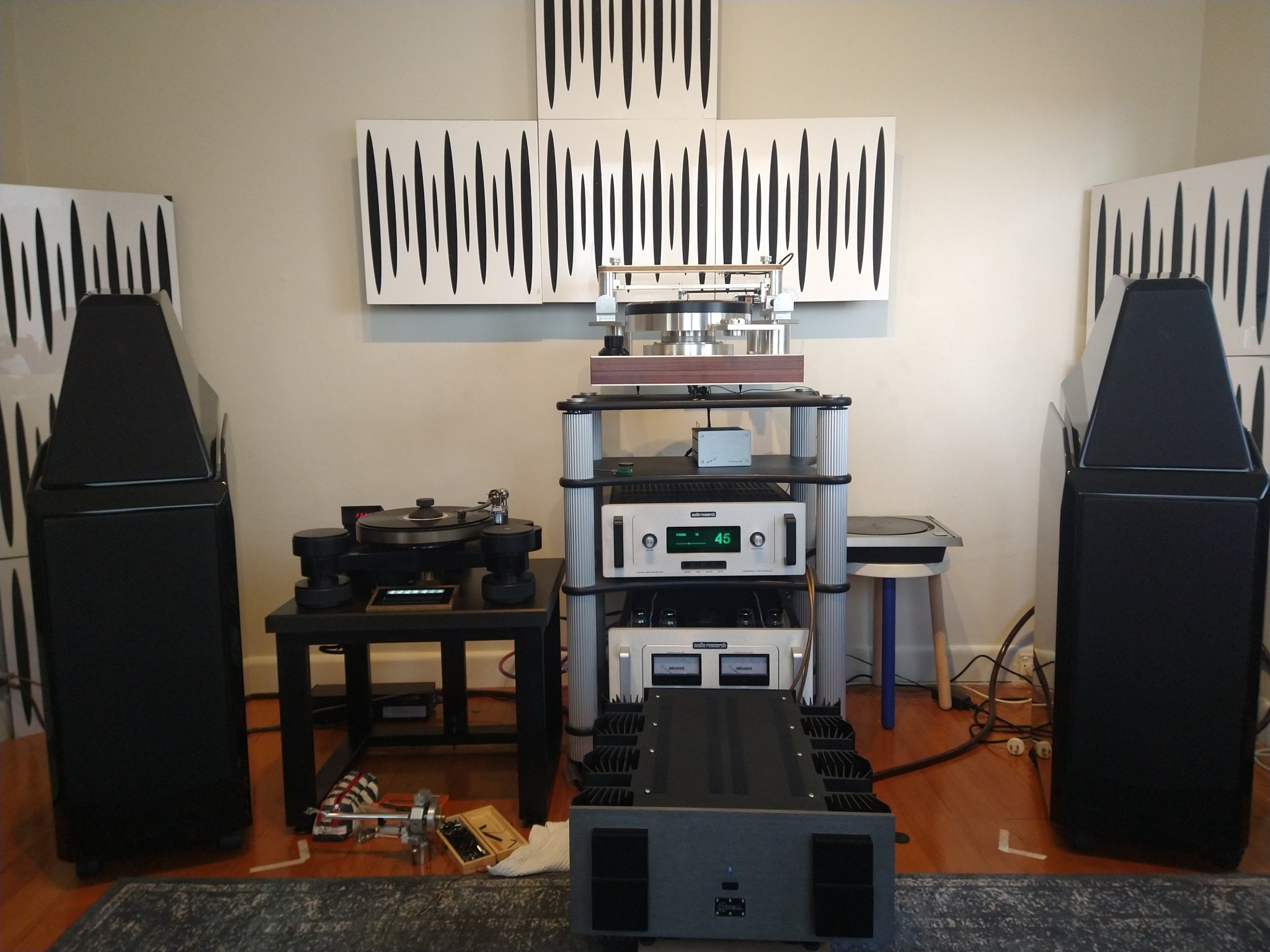

You can learn a lot from building and testing TT's. Get yourself a stethoscope and listen to the platter and plinth, If you can hear sound via the stethoscope the cartridge will also hear it. Play a CD or other material and listen.

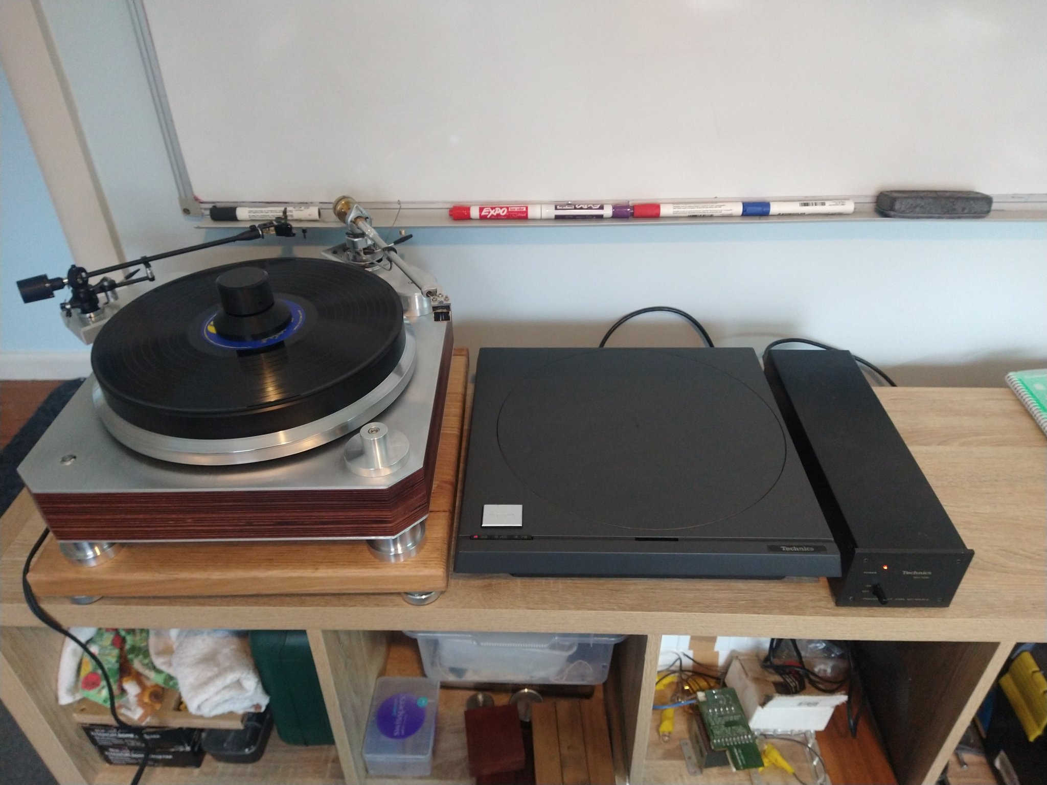

I've built quite a few TT's now all based on the SP10mk2 motor and I have benched marked them against a Goldmund Reference and TeshDas AF3, in both cases the SP10 based TT beat them. In the case of the Goldmund we swapped tonearm/cart between TT's so the only difference was the TT.
What I've learned over my time is the plinth and platter make the biggest improvements. I prefer POM platters and that's all I use now. Usually 30-40mm POMC bolted to either the stock SP!0 platter or a custom aluminium one.
First pic is my TT on the stand bench marked against the Goldmund the second pic is the latest TT I built for a friend.
