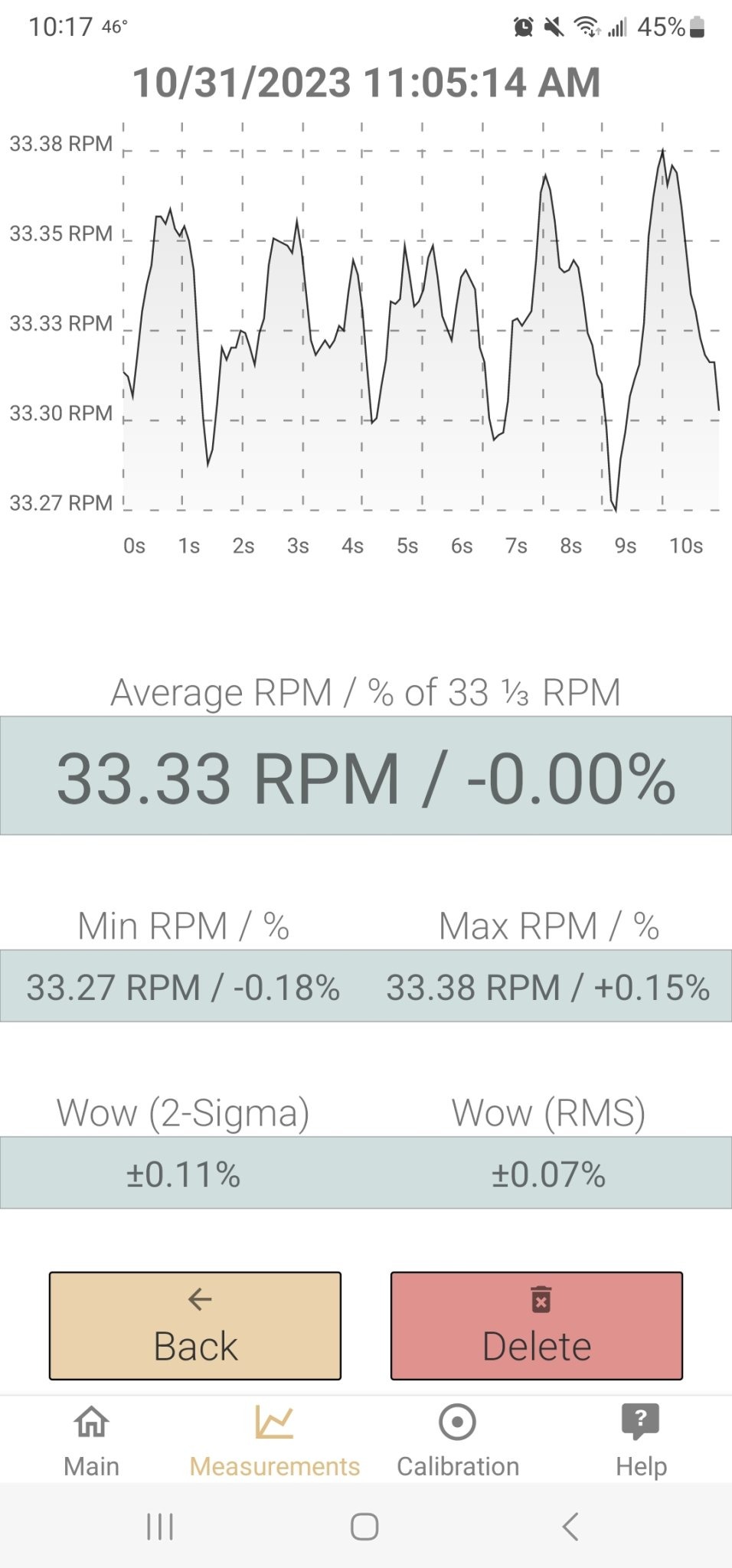

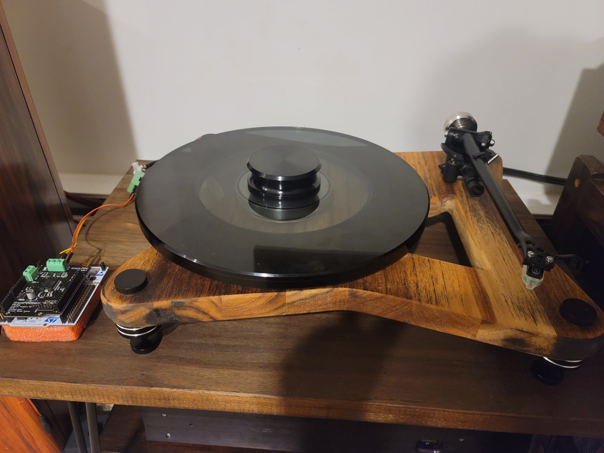

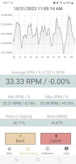

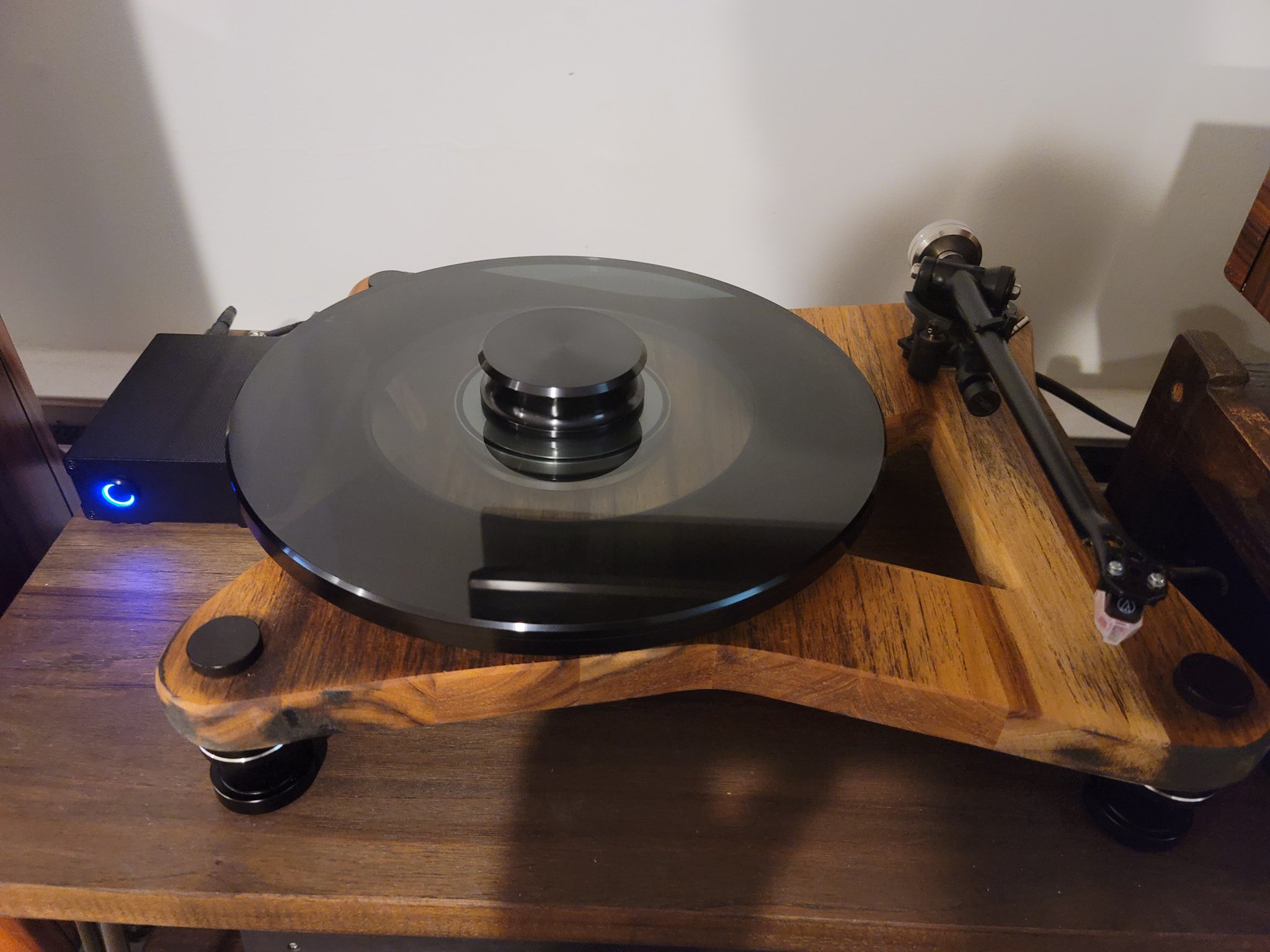

For the platter, do look at a Rega acrylic platter (on Amazon for like $80, over 1" thick) or a Rega 6 glass platter (about $120). And a Tangospinner bearing and subplatter. I have been very happy with mine.
As for the motor controller, that is a long road. If you do want to build you own, there are microcontrollers (Arduino) and motor driver boards and software (SimpleFOC) that are actually easy to use, and just require a little bit of programming (using a very easy to use Arduino application running on your Mac or PC). And we can help you with the code, super simple. I have my TT running great spec wize (equal to a Rega RP 6 or a Project 2Xperience), with the ability to continue to tweek and optimize. The microprocessor hardware costs about $50, the software is free, and an amazing motor from Anaheim, Maxon, or Portescap would run between $100-$250 (with Maxon being the top but also the best with the most poles). (I use an Anaheim motor for $100).

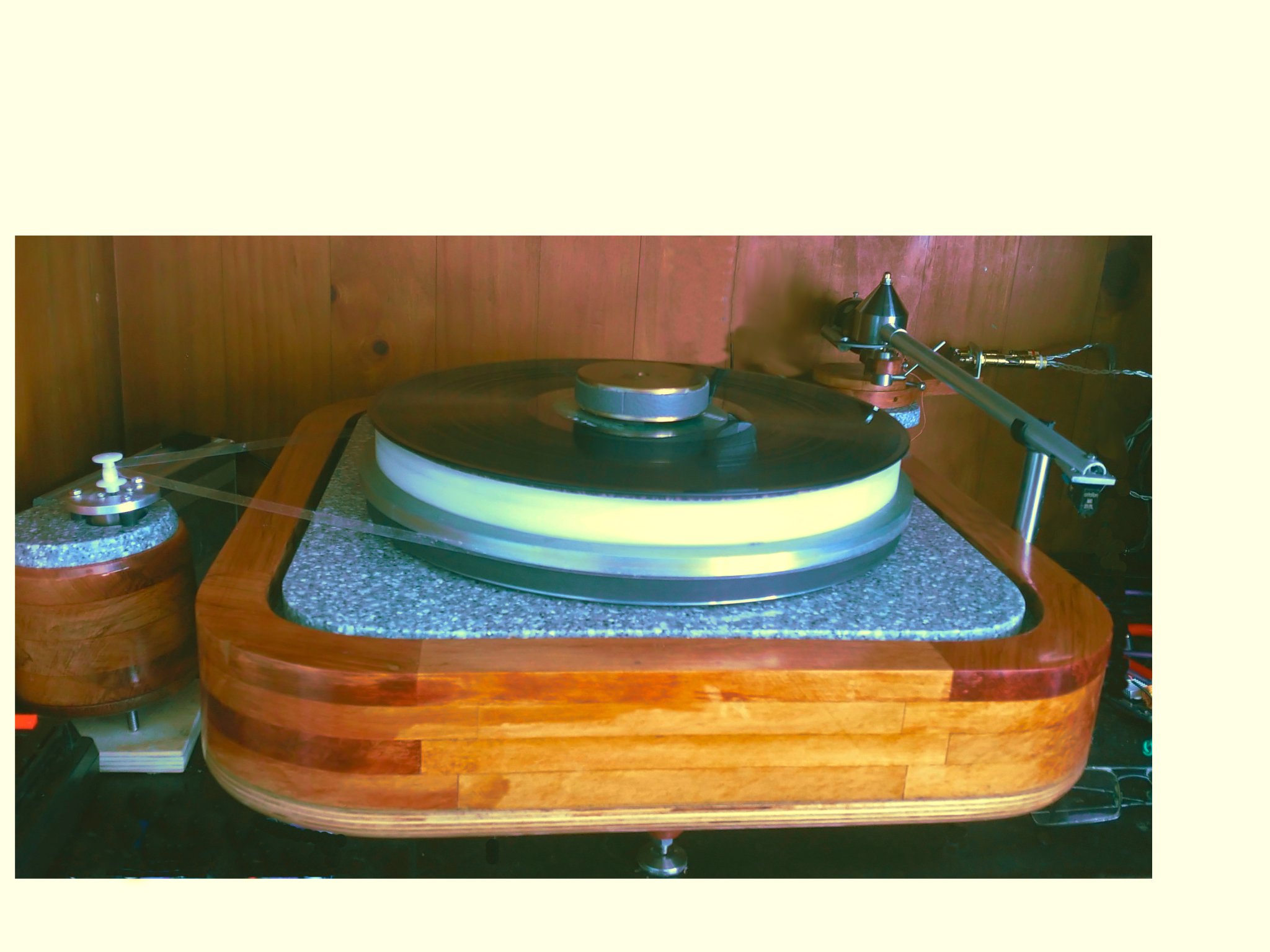

Hi, I actually use the Portescap in the rig shown. It has been running for over two years now 3-4 hours per day & is still perfectly quiet and stable, get around 0.05 Wow. The key for belt driven is the motor pulley, any slightest wobble will show up in wow.
The tonearm I mentioned is available in kit form, (2 hours to assemble) which is how I went & upgraded to a Magnesium wand. Had a moded Rega RB300 & the Temaad arm was a massive improvement. It is even considered better that the Audiomods.

Hi, The top and bottom are from an off-cut of a kitchen sink bench. Turned to the correct diameter, I have a lathe.
The center body is from gluing 3 or 4 layers of wood together.
1 - mark the inner diameter & outer diameter with a caliper.
2 - with a hole saw cut out the center bore holes (about 70mm dia)
3 - cut around the outer dia.
4 - glue together.
5 - Turn down on lathe the outer & inner to the diameters required.
6 - Sand to finish (lots of sanding!!)
7 - assemble.
Note there are 3 S/Steel pointed feet on the bottom.
