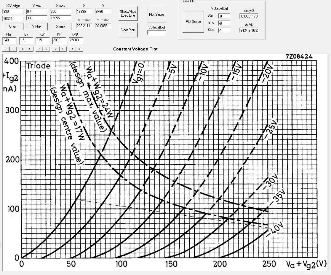

This is the output transformer (5/3.5K: 8). Core tongue width: 28mm. Core stack thickness: 40mm
I'd like to advice You SE 6S19P /+U plate about 160v/ & 6SL7. You can use OT wires for 3.5 kohm.
6s19p
Thank you! 6s19p in China's model is 6c19, We here at very cheap prices equivalent to four eggs., I did like the model.
120v power output by the voltage doubler rectifier is 280v or so, toroidal transformer power enough, so there is plenty to choose.
6s19p has a higher gate voltage. If you choose 6s19p, 3.5K only about 1.1W output. Feeling a little too small.

How about 6P1P? May be can get 3W... What software are you using to display the graph, it's very good looking.😉
6S19P has clear and neutral sounding and 3.5 kohm is very good load. I tried and I very liked it!

6C19 is indeed a very good tubes, at a voltage of 250v should have 2.5k impedance.
20 years ago,I did in 1990 6p1 tube amp. Sound is not very good. Did not stay. 6p6p later changed into a tube amp. Not long ago replaced 6W6GT, finally has a good sound. So this is not going to reuse 6P1 it.
Is a tube amp calculation tools.
