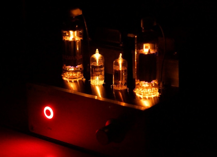

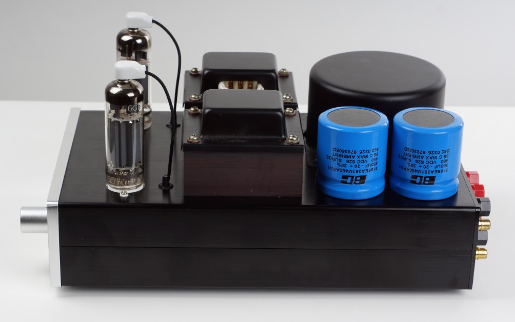

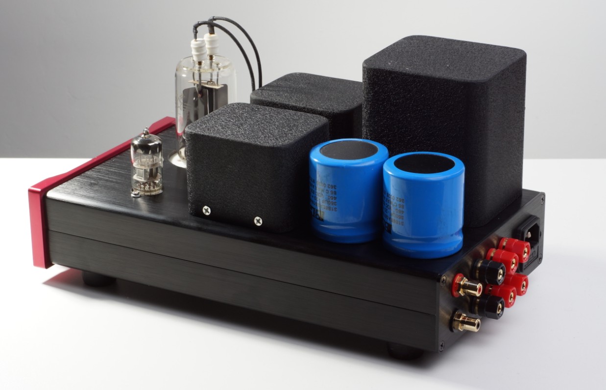

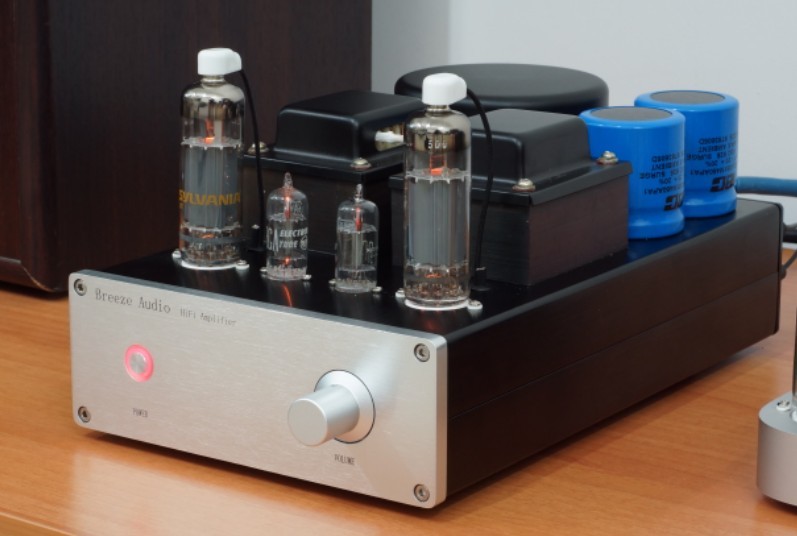

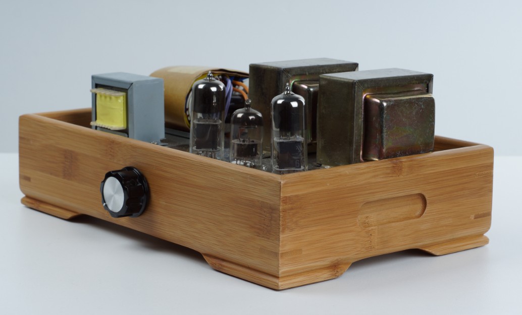

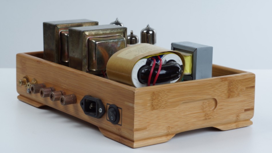

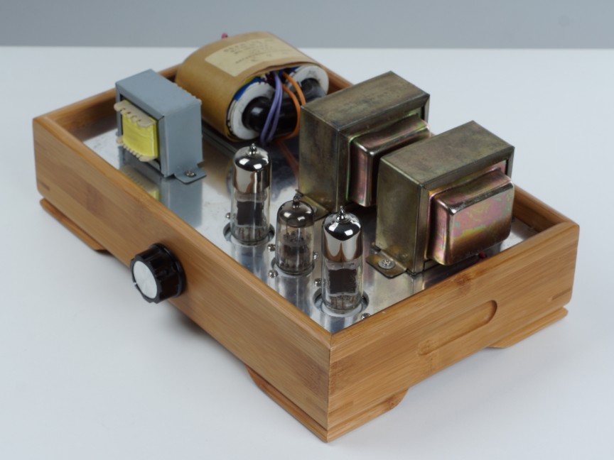

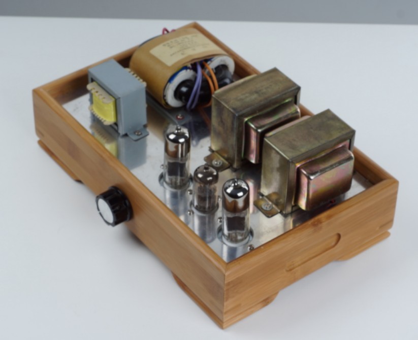

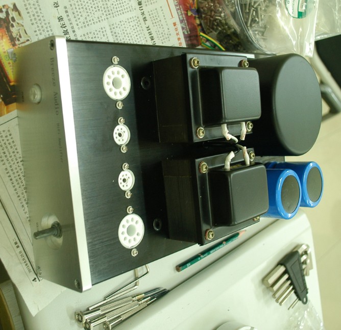

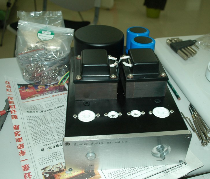

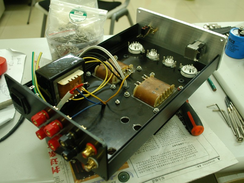

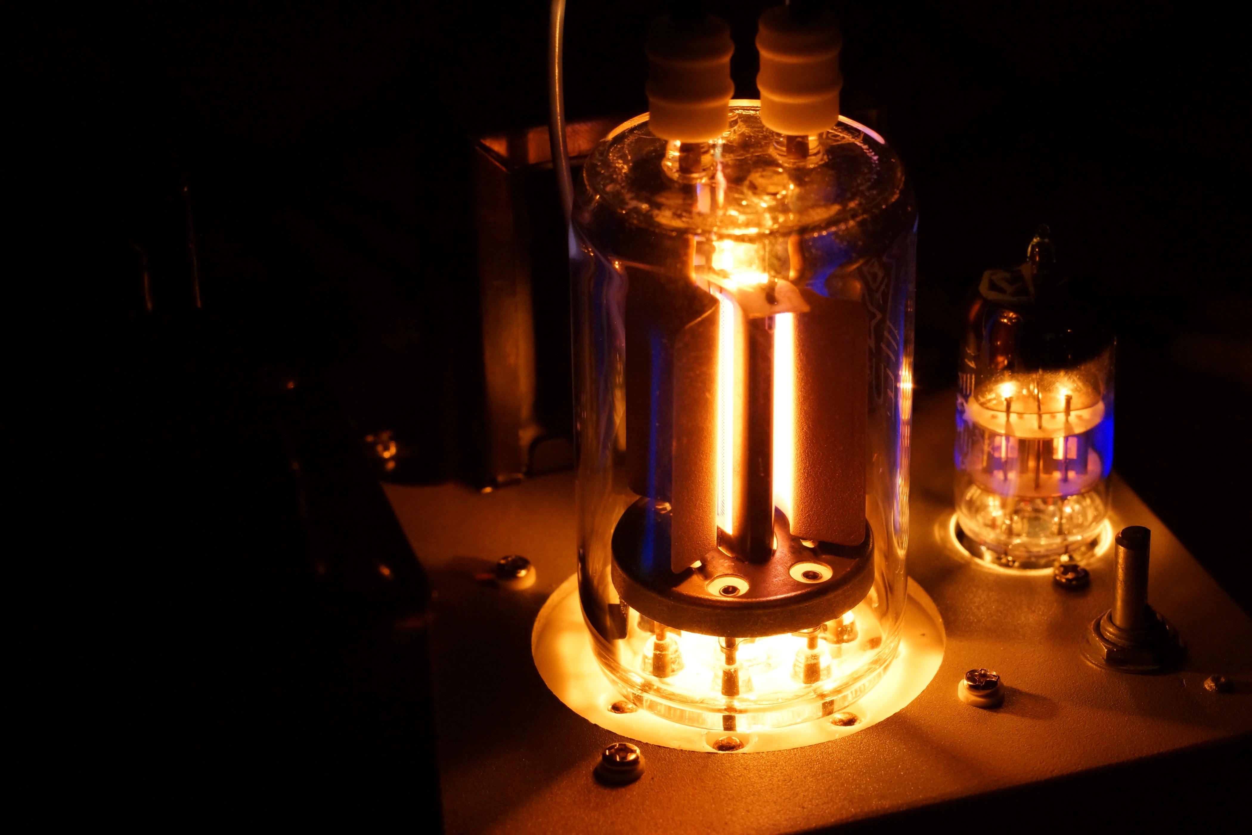

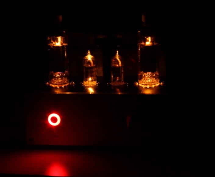

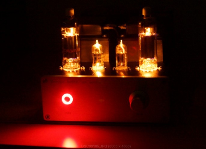

BEIJING 6S6 triode mode single-ended amplifier
这是一个极低成本的单端功放,总造价低于30美元。但是,却是音色最好的功放。6s6出色的完成了单端放大,以及其美丽的音色提供了0.58w的音频输出。以至于不得不使用灵敏度97DB的音箱来完成放音任务。不过在35平方米的听音房间里一点也不觉得吃力,较大的动态依然被表现得非常好。以至于你会忘记它只有0.58w的输出功率。
This is an extremely low-cost single-ended amplifier, the total cost is less than $ 30. However, it is the best amp tones. 6s6 completed a remarkable single-ended amplifier, as well as its beautiful tone provides 0.58w audio output. So had to use to complete the sensitivity 97DB speaker playback tasks. But in the 35 square meters of the listening room is not that difficult, greater dynamic performance continued to be very good. You will forget that it is only 0.58w output power.

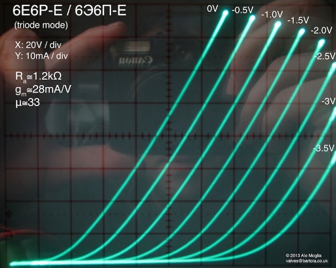

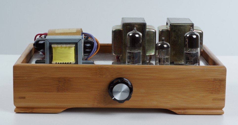

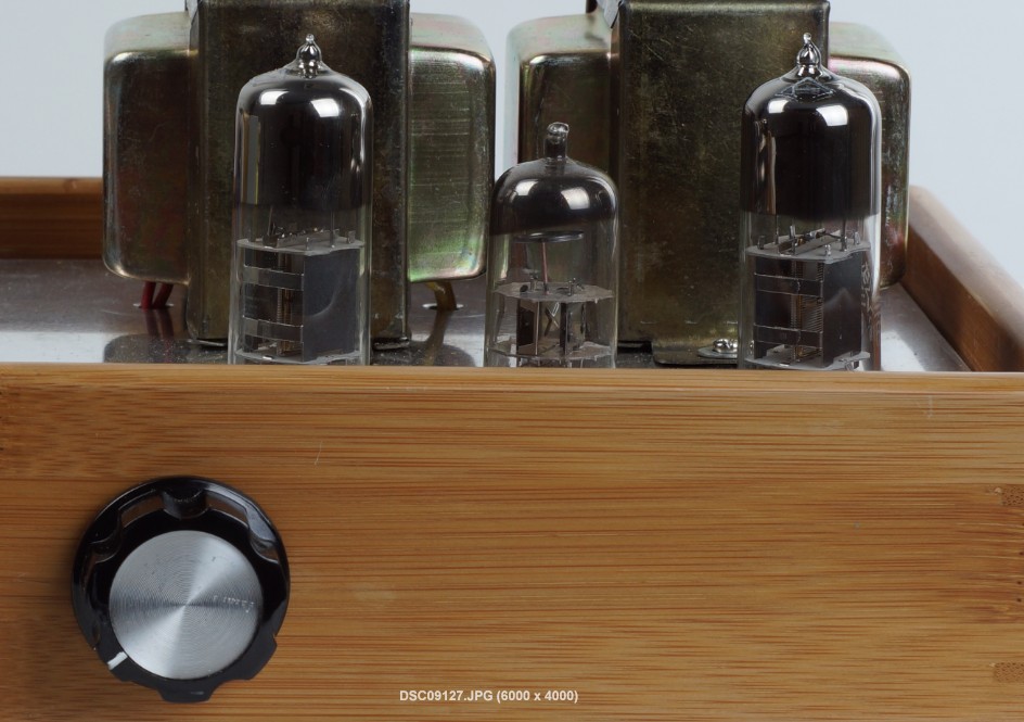

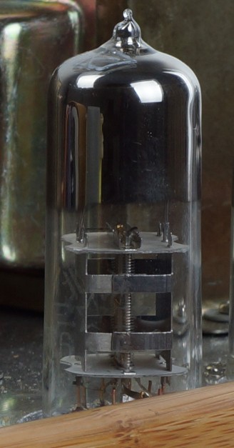

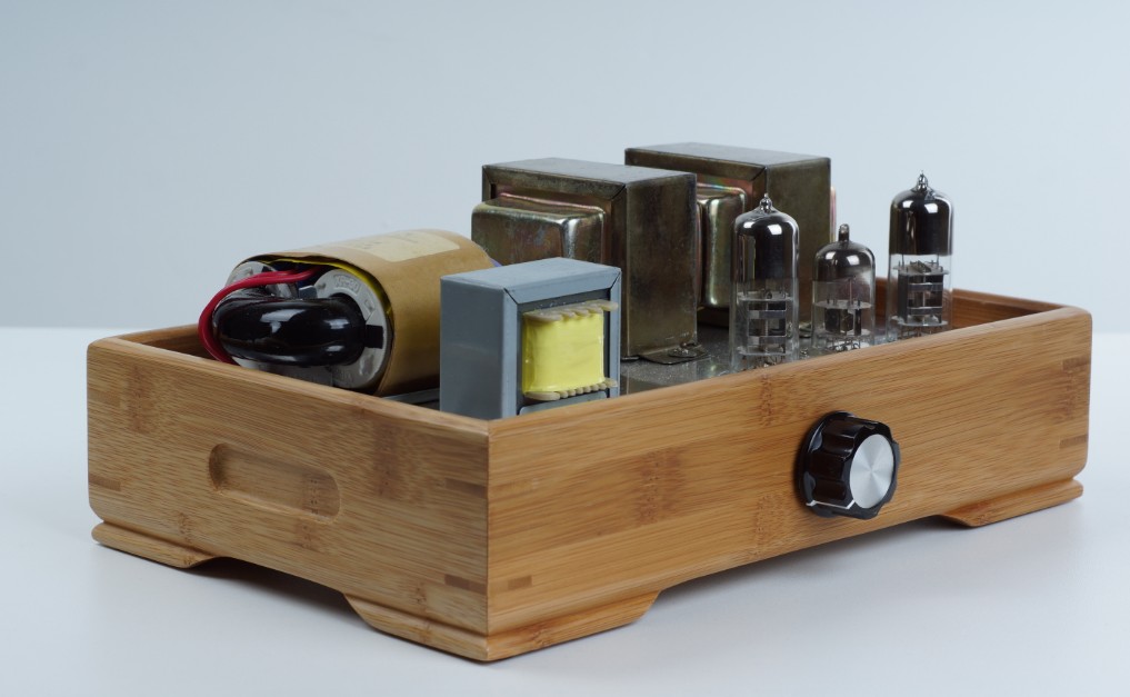

6Э6П

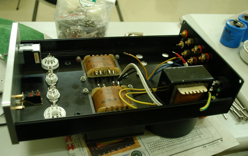

Shell made of bamboo is actually a tea tray. Supply voltage 180v, output impedance of 2500 ohms.
